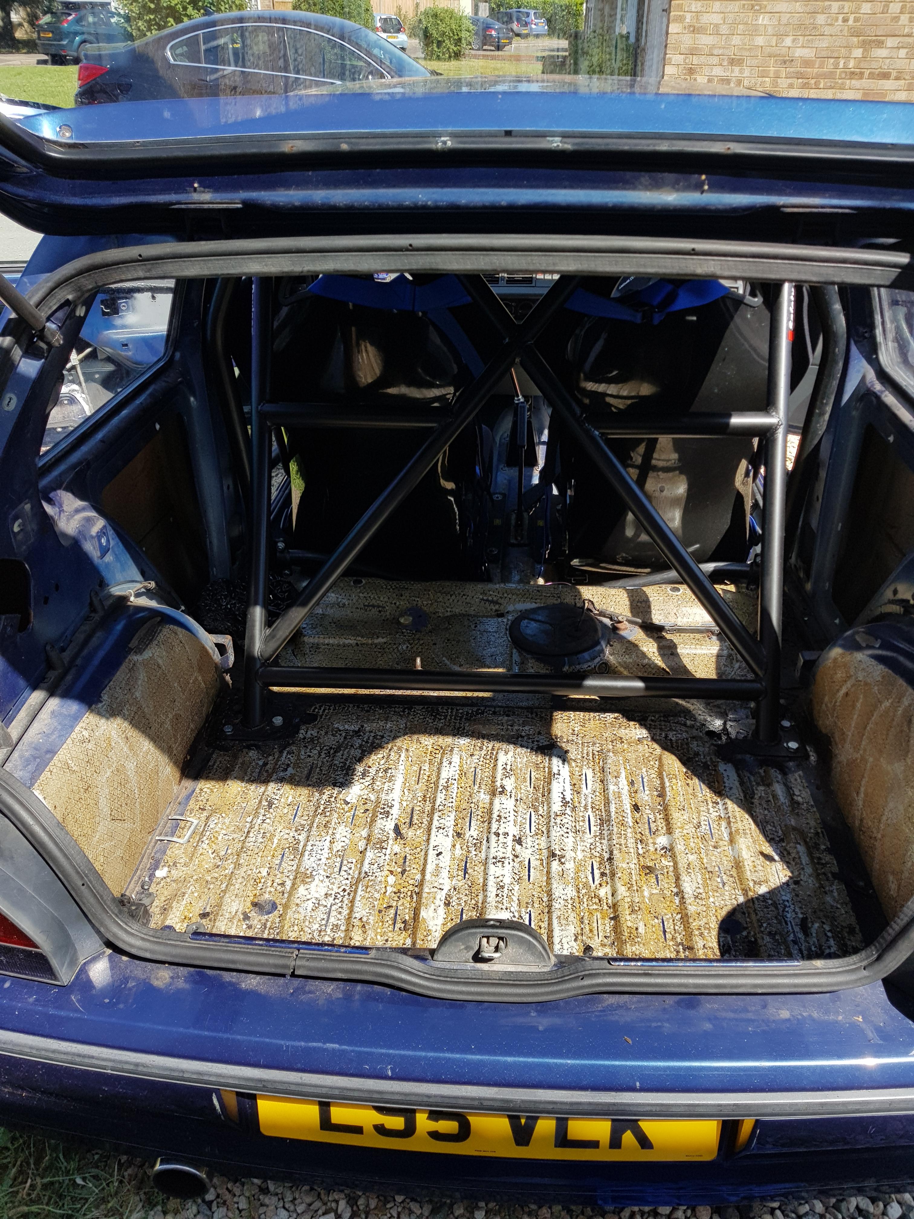

Changed the bootlid to my other one

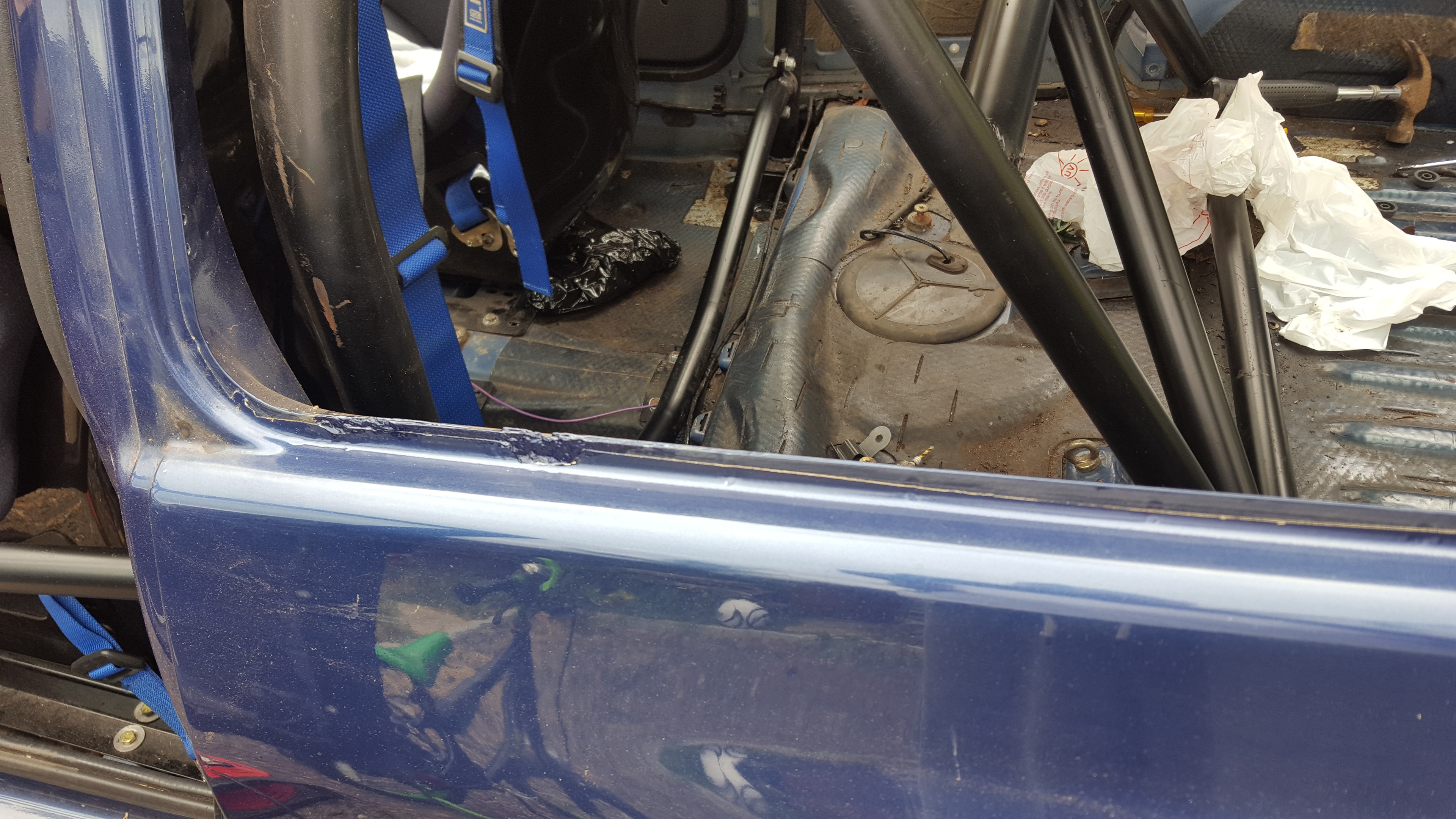

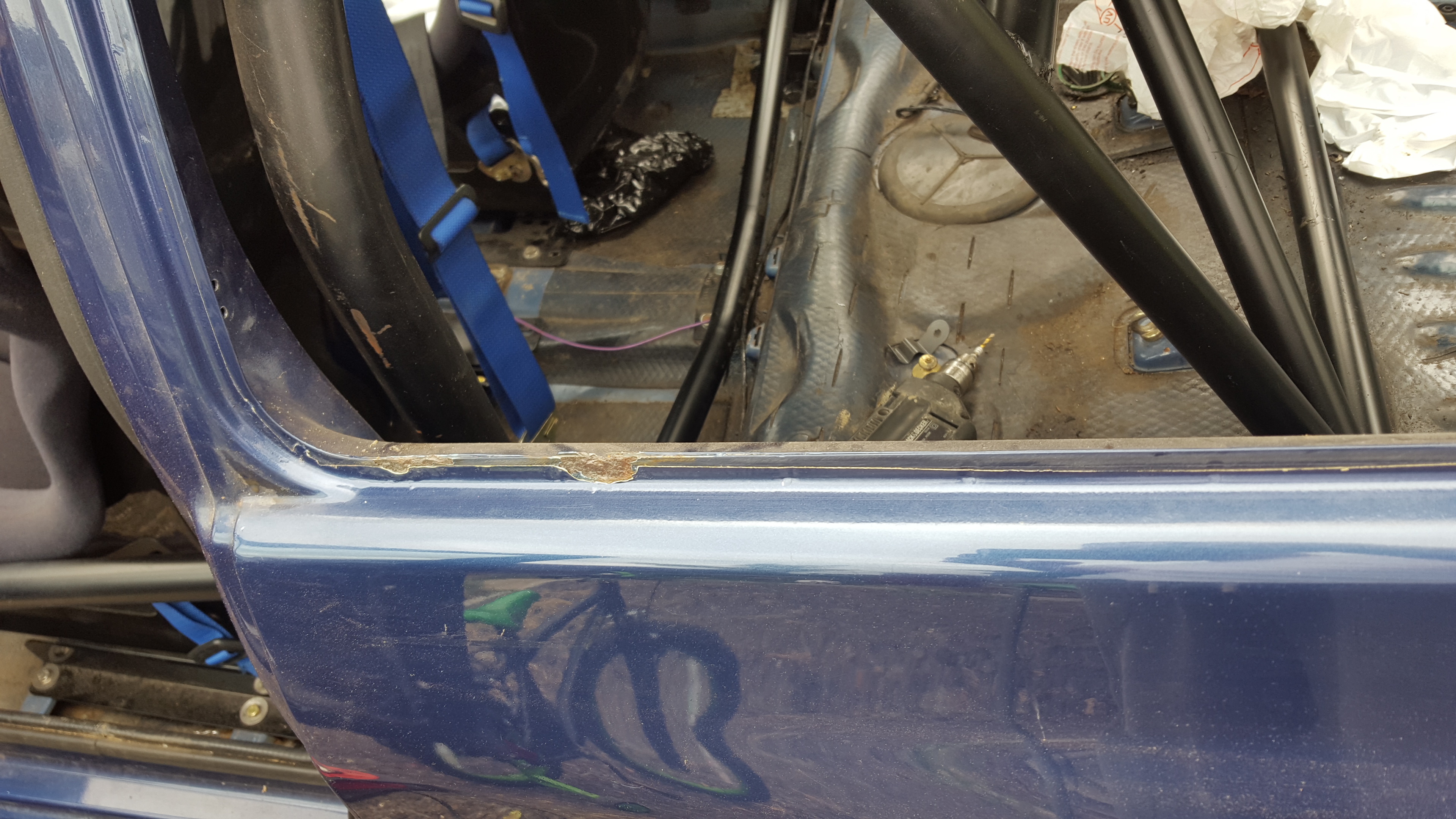

Found some rust!! took it back, treated it, painted it

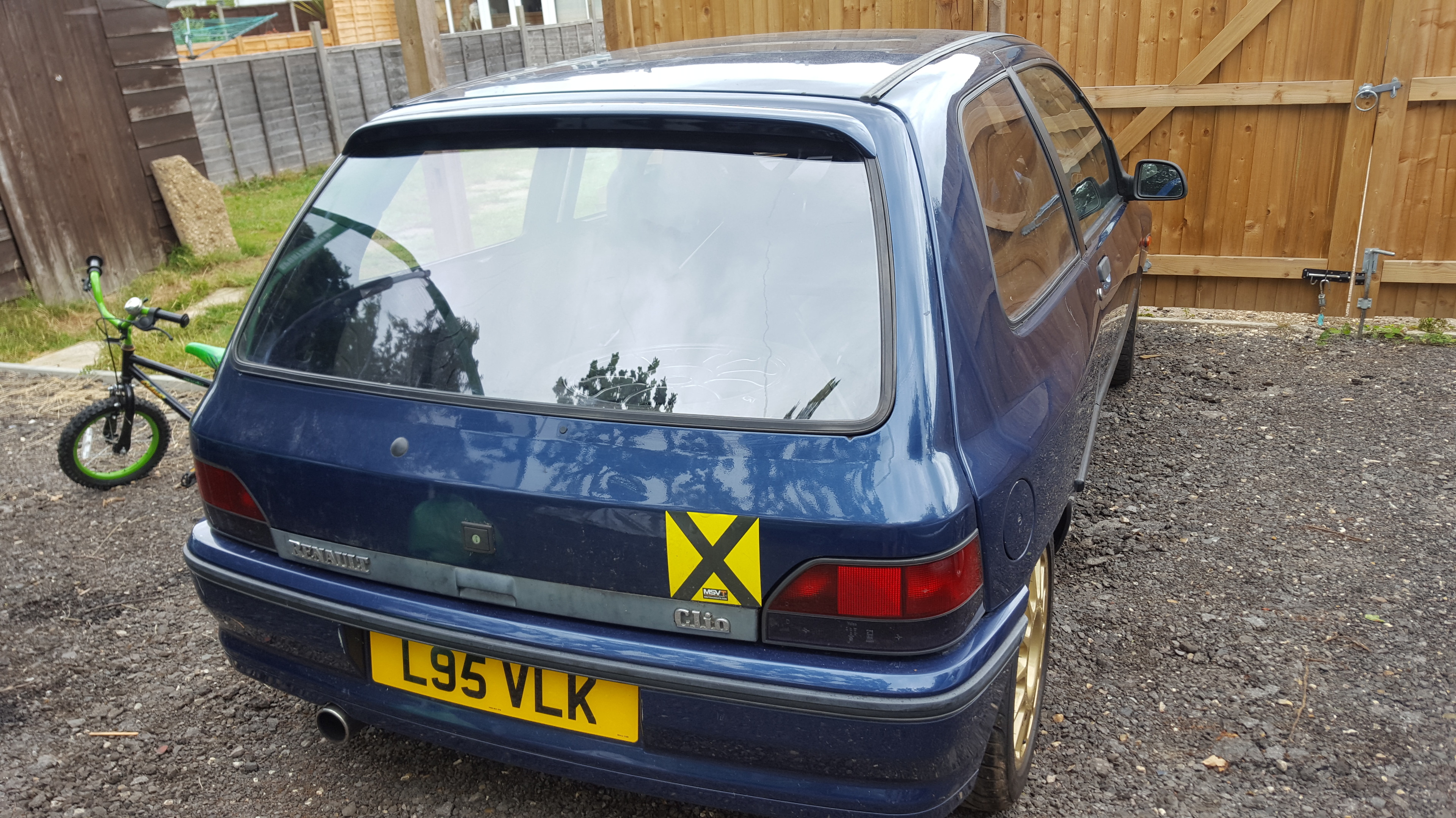

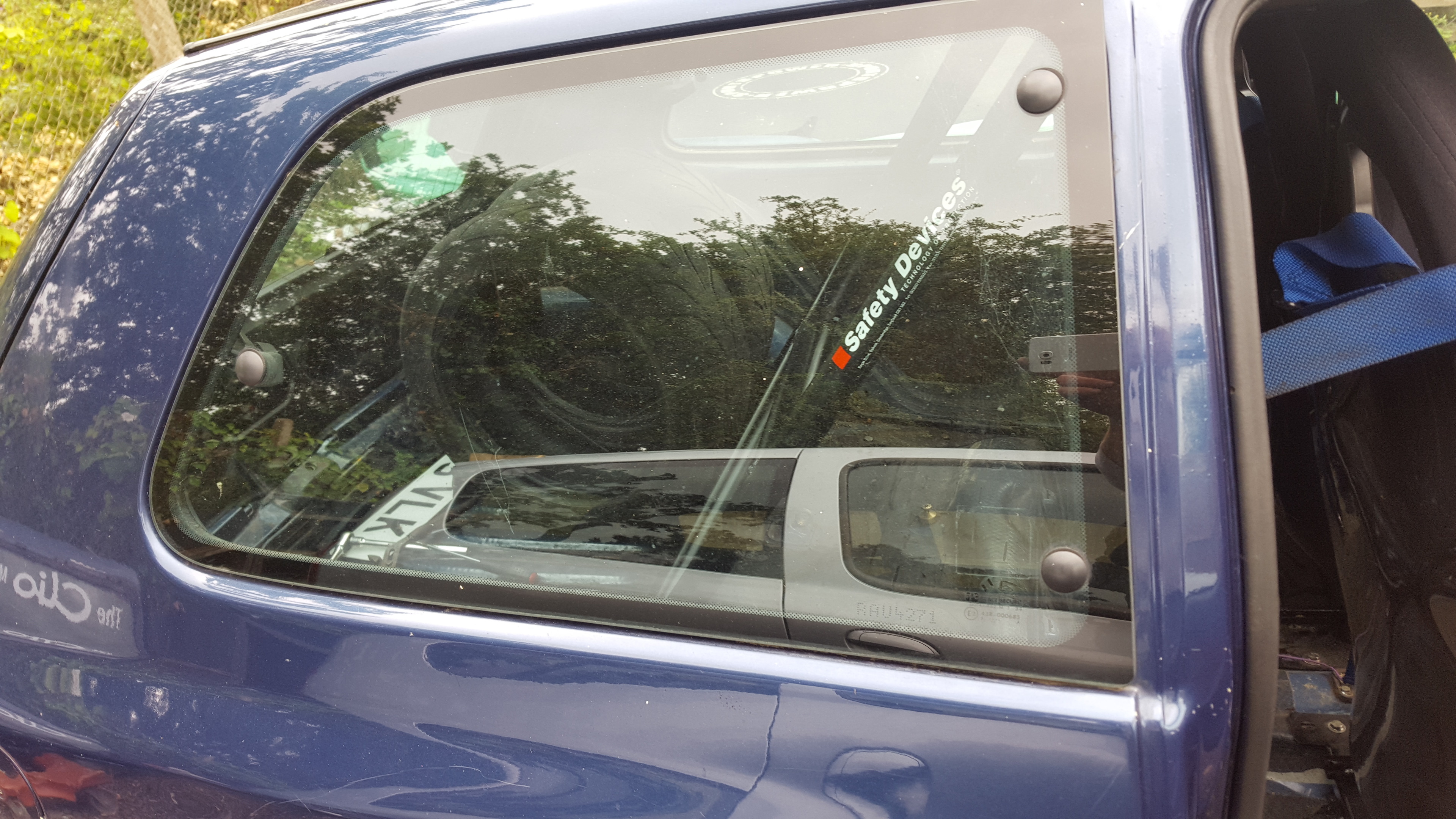

installed rear 3 plastic windows

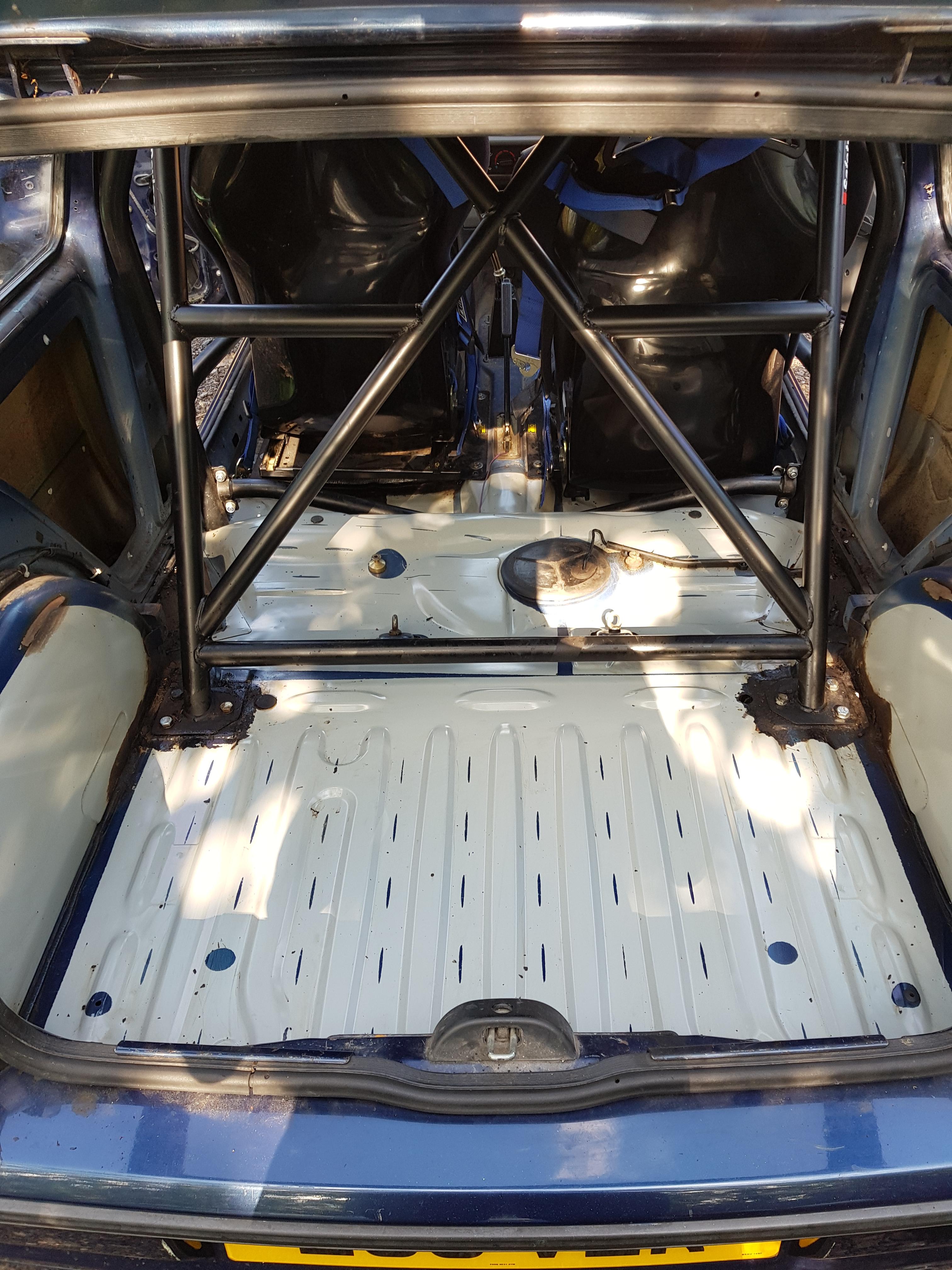

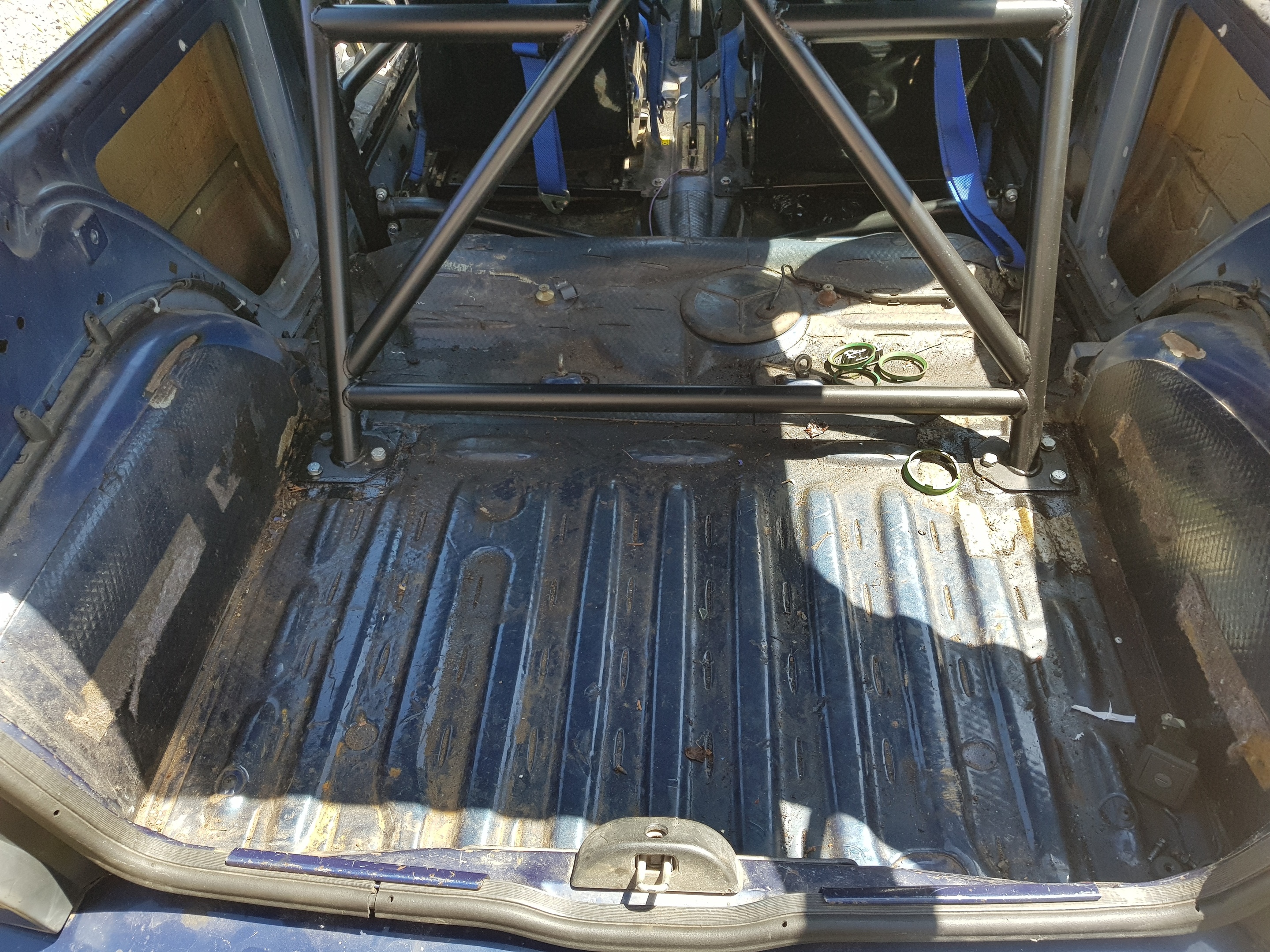

Removed all the sound deadning (an awful job made even more awful on the Williams because it has loads extra)

Rear 3 windows changed, rear opening windows changed using sealed rear seals from the shed
Rust
fixed
Sound deadning (weighed it all up when it came out, around 8kg)

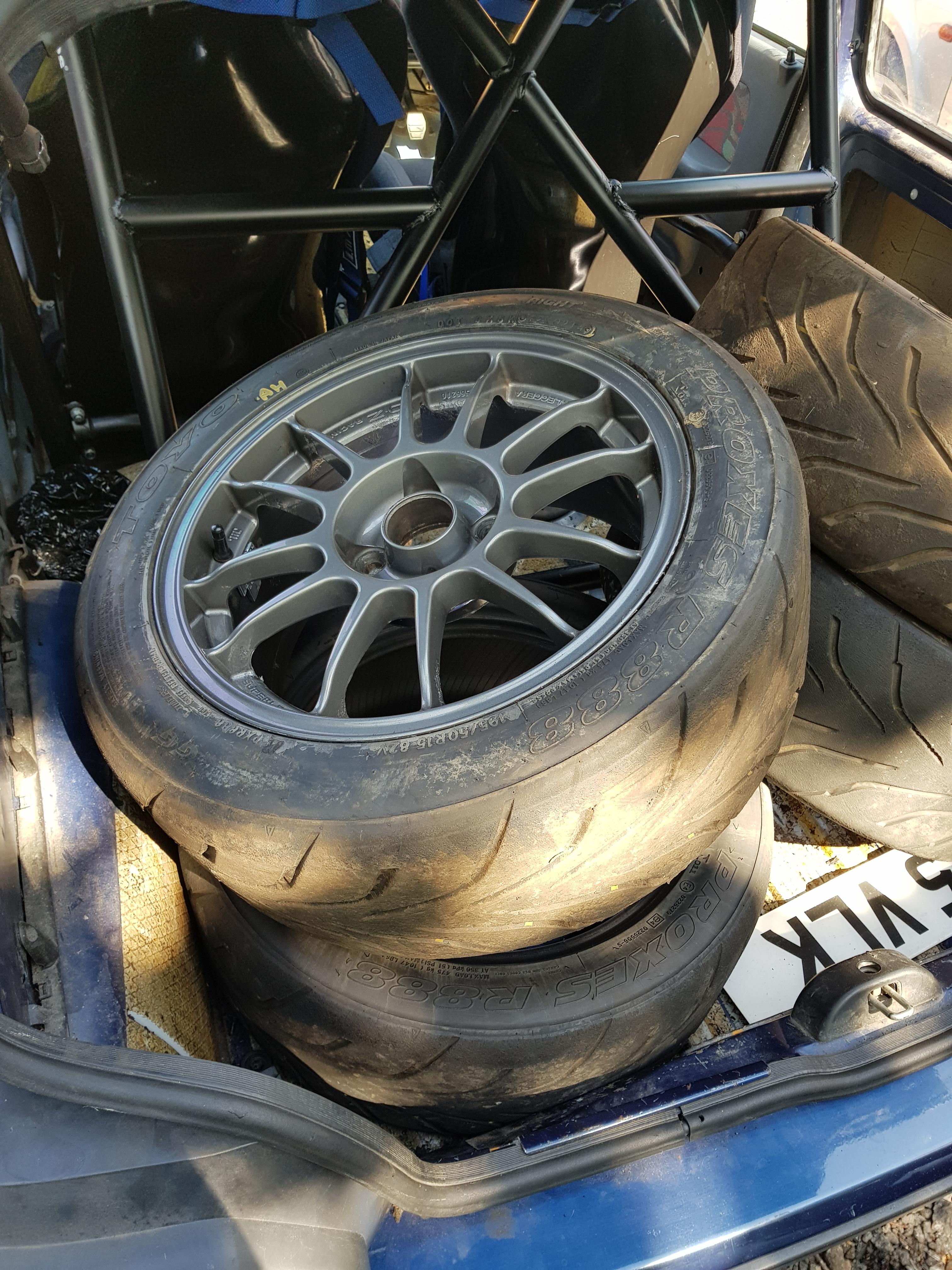

Wheels will be changed during the week as the 2118 are being sold
