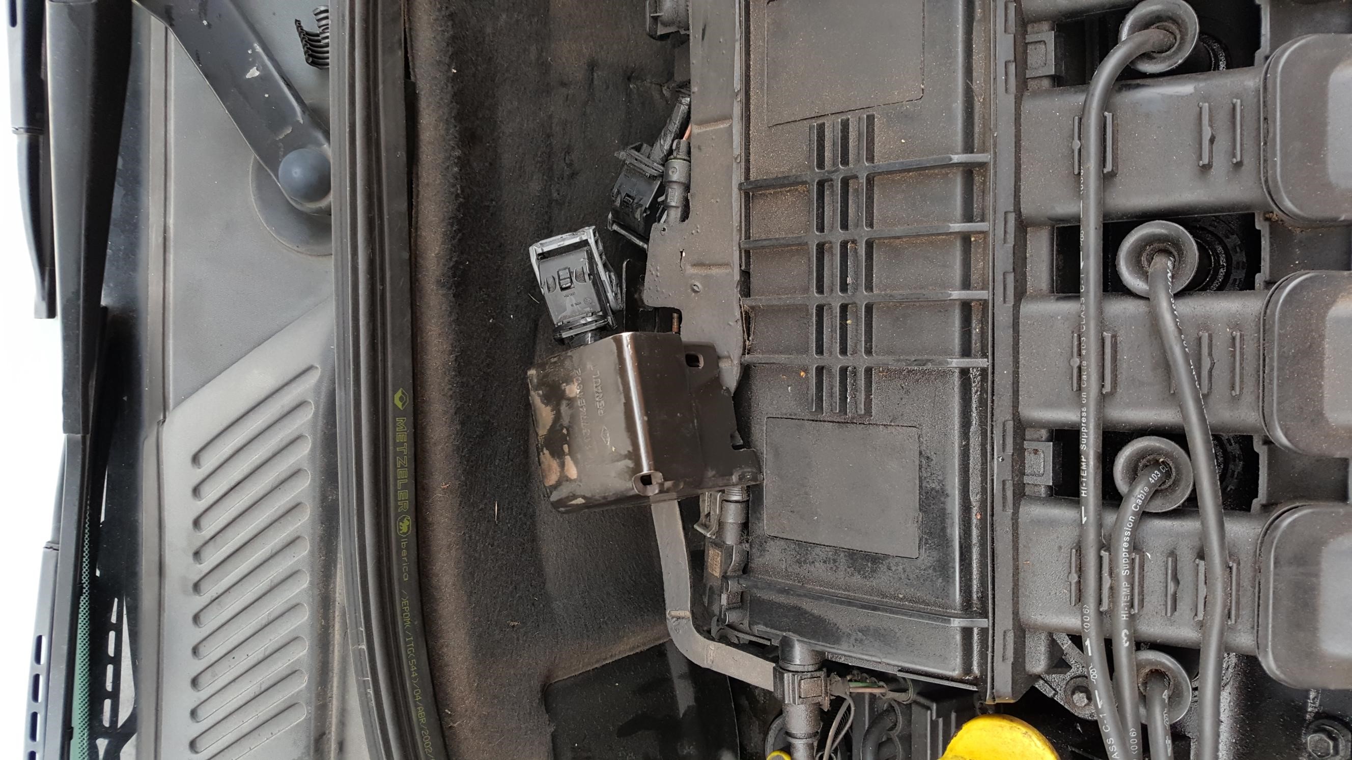

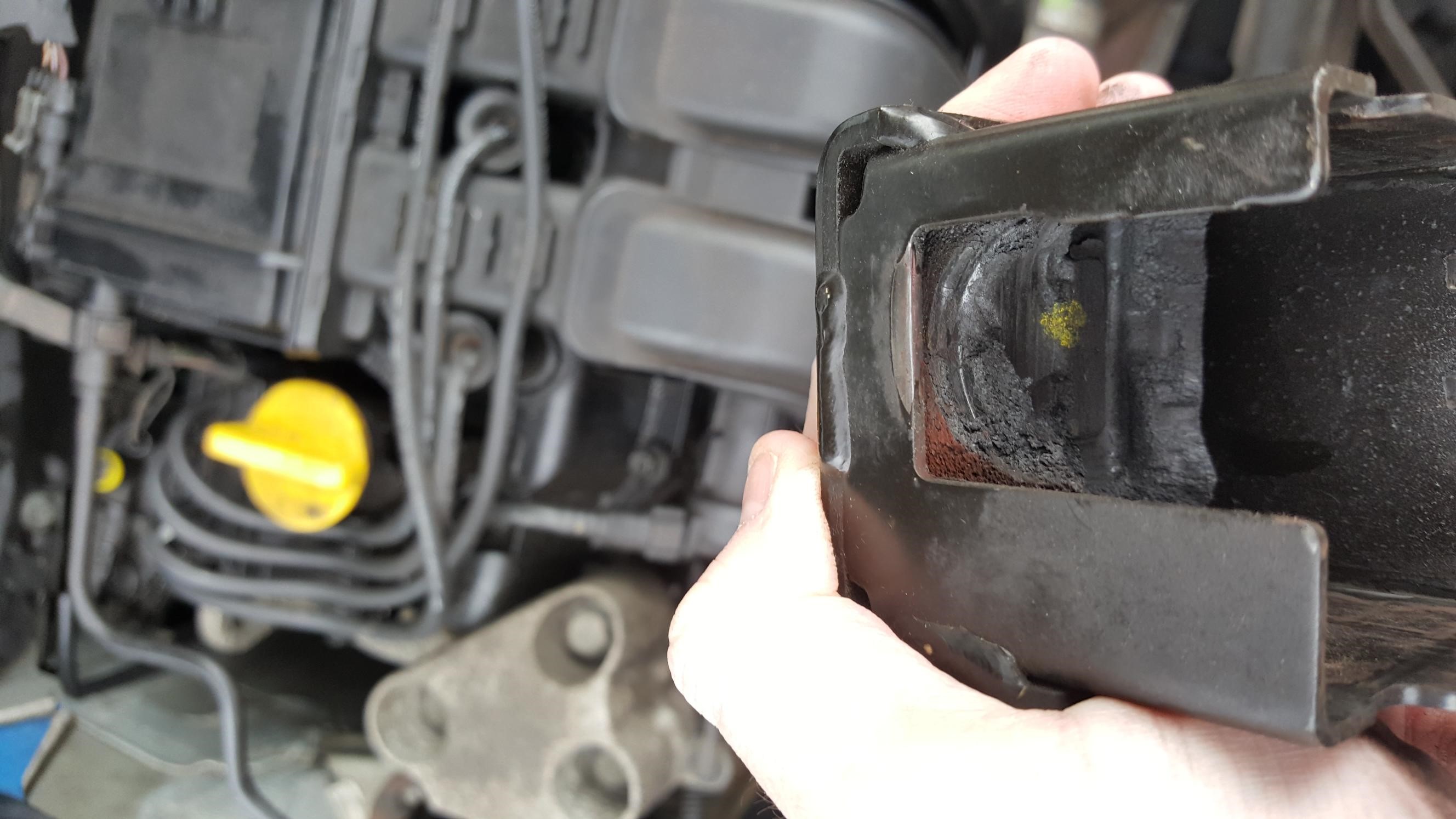

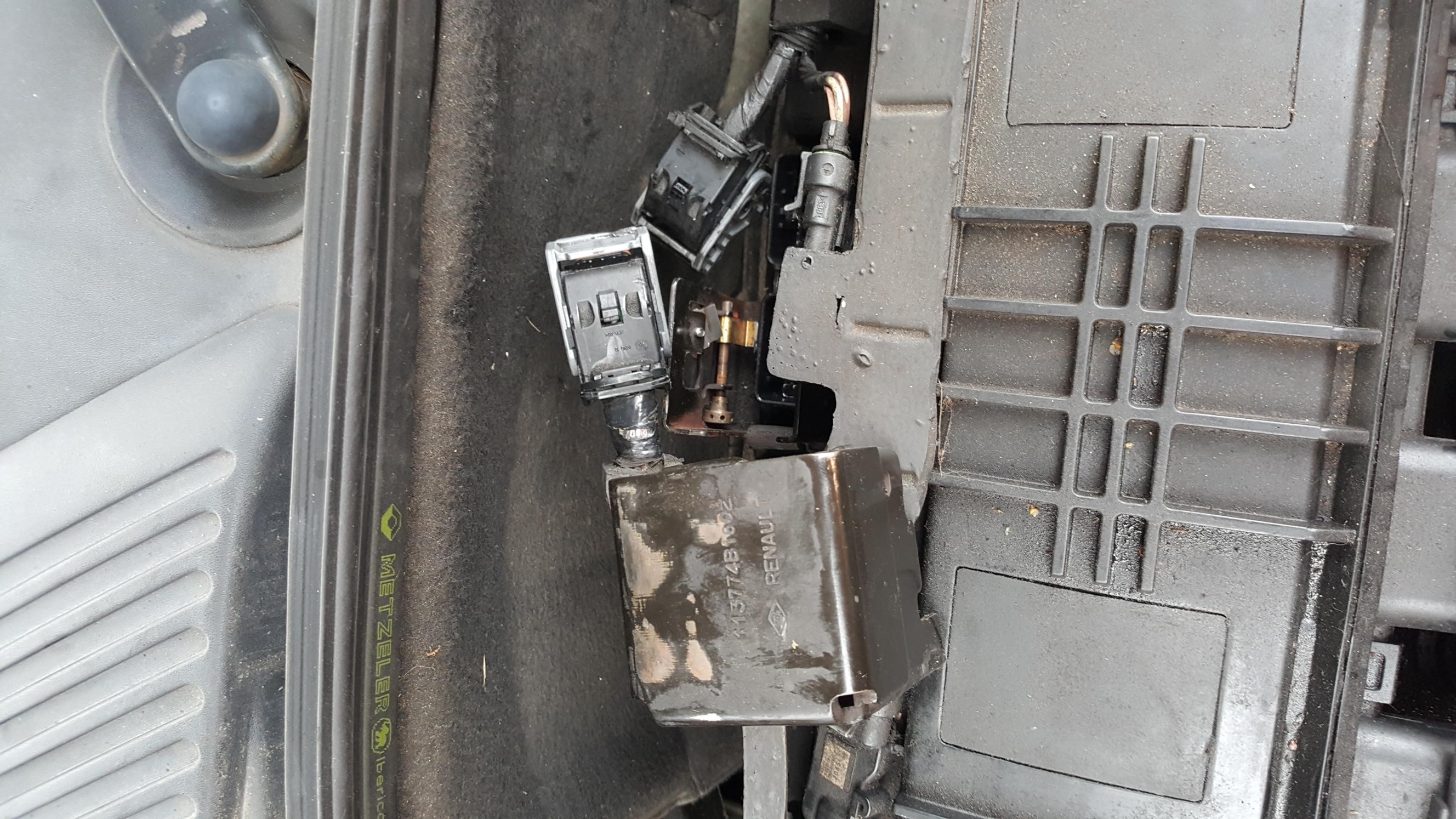

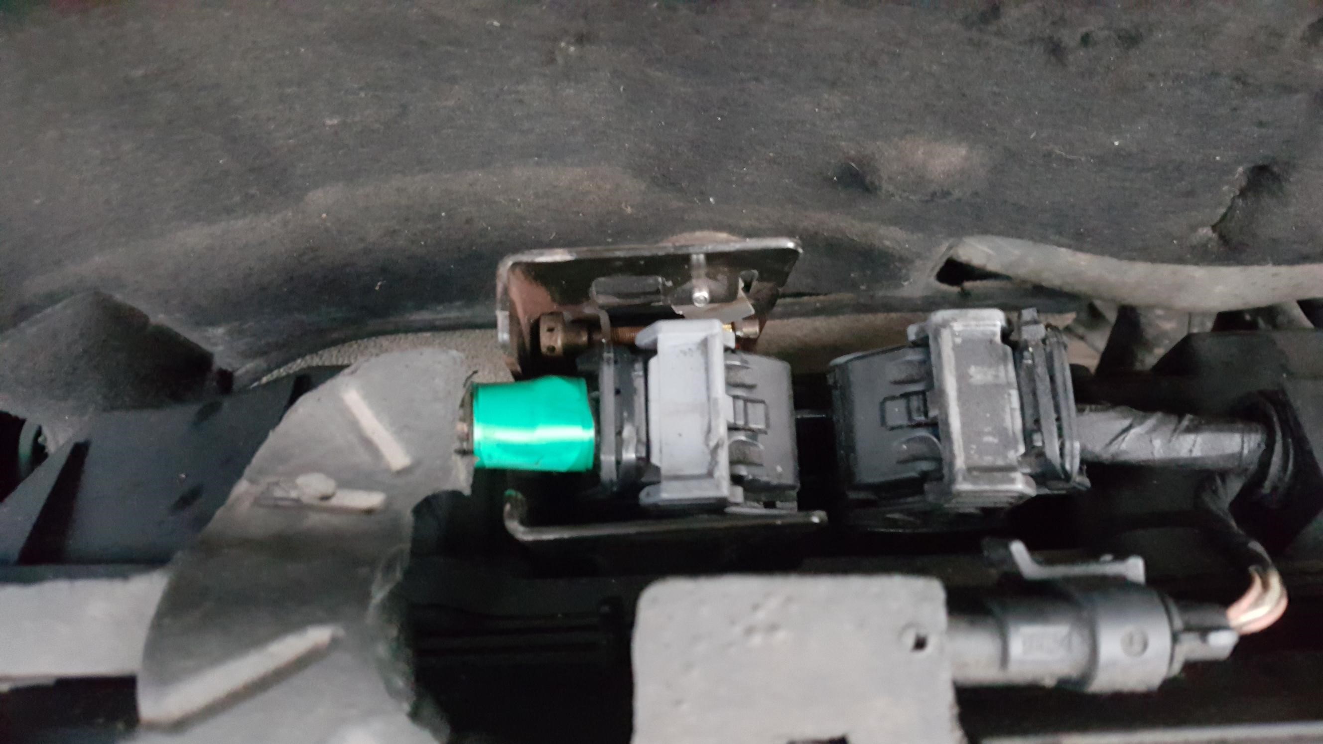

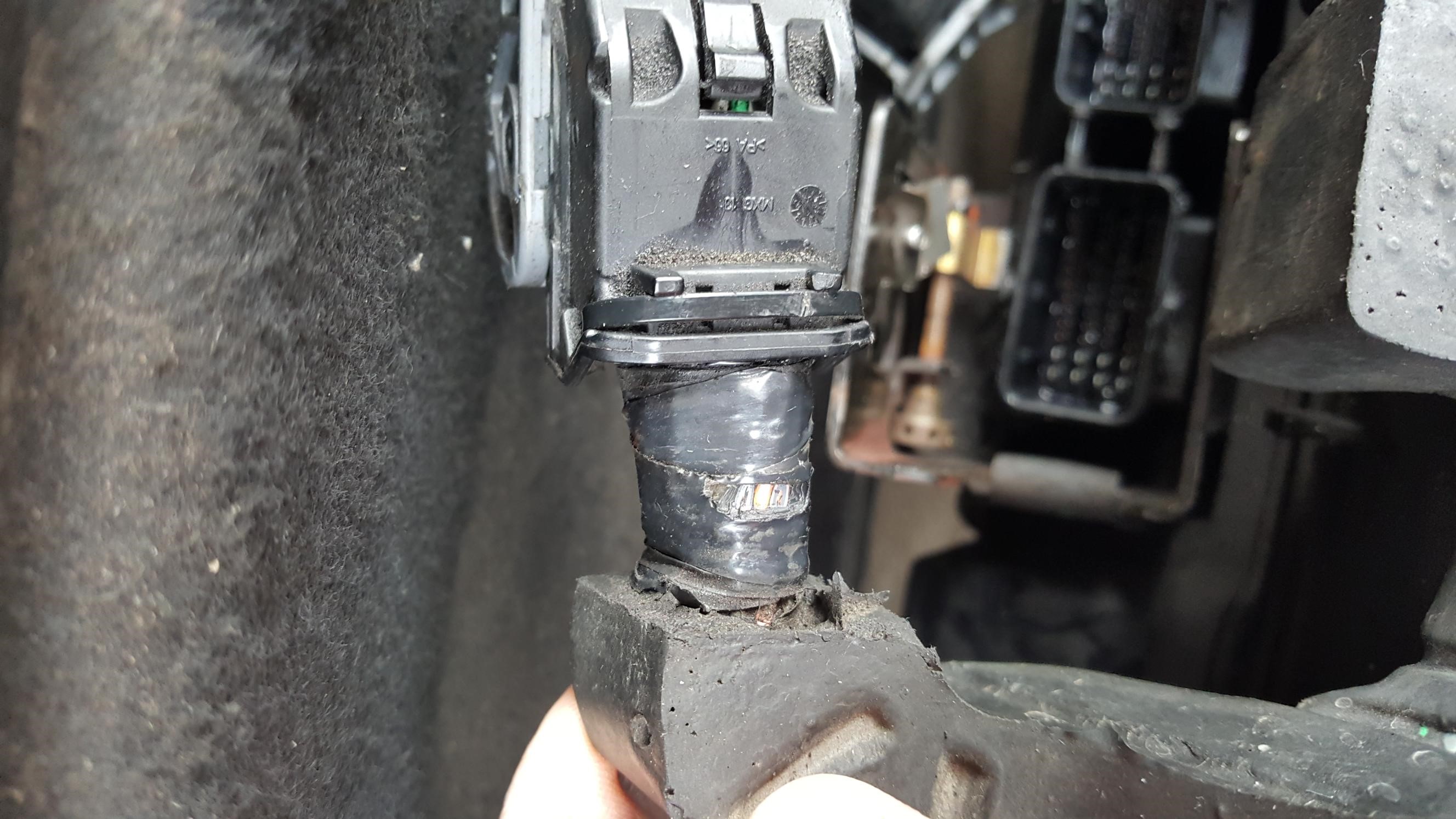

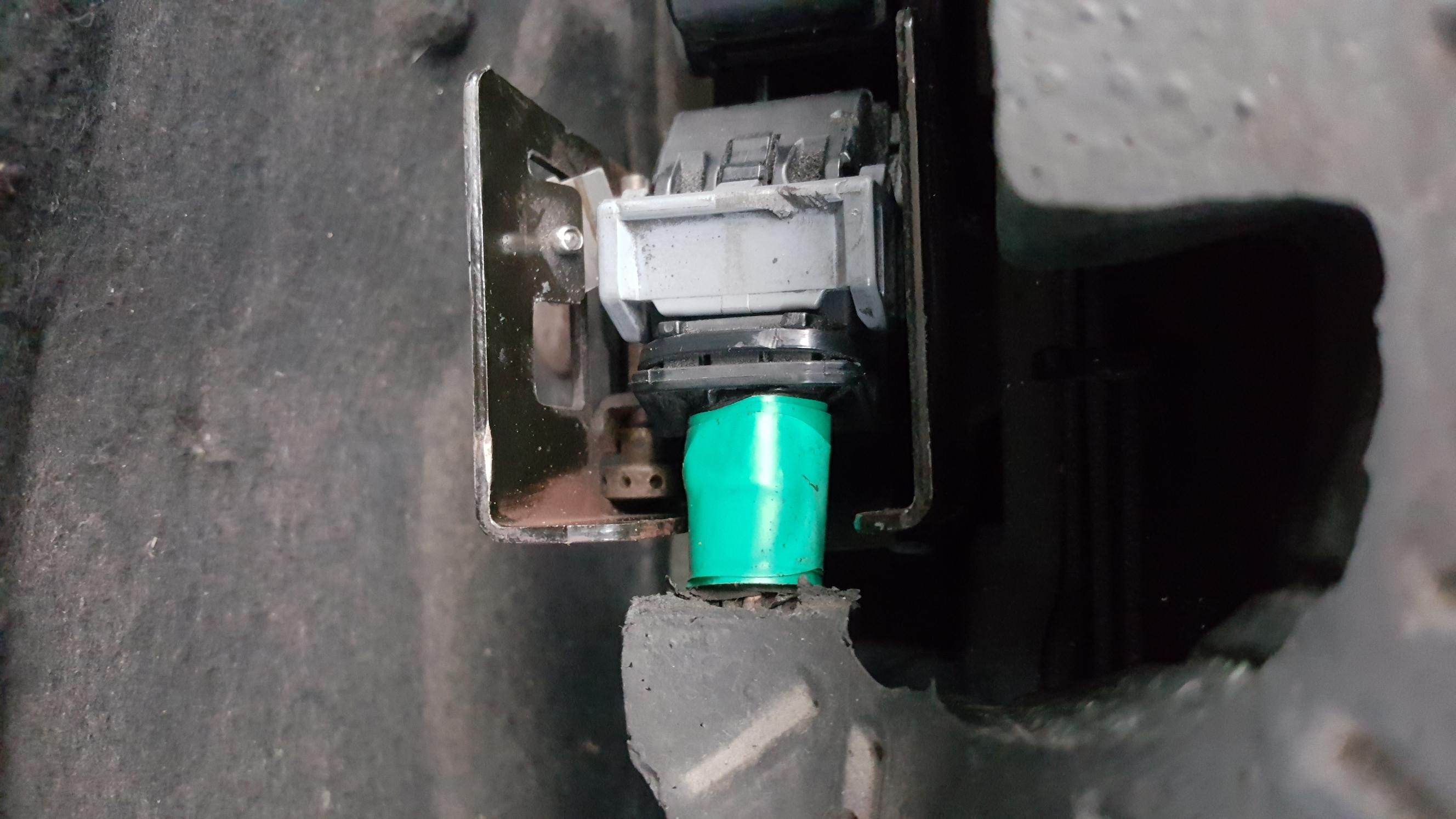

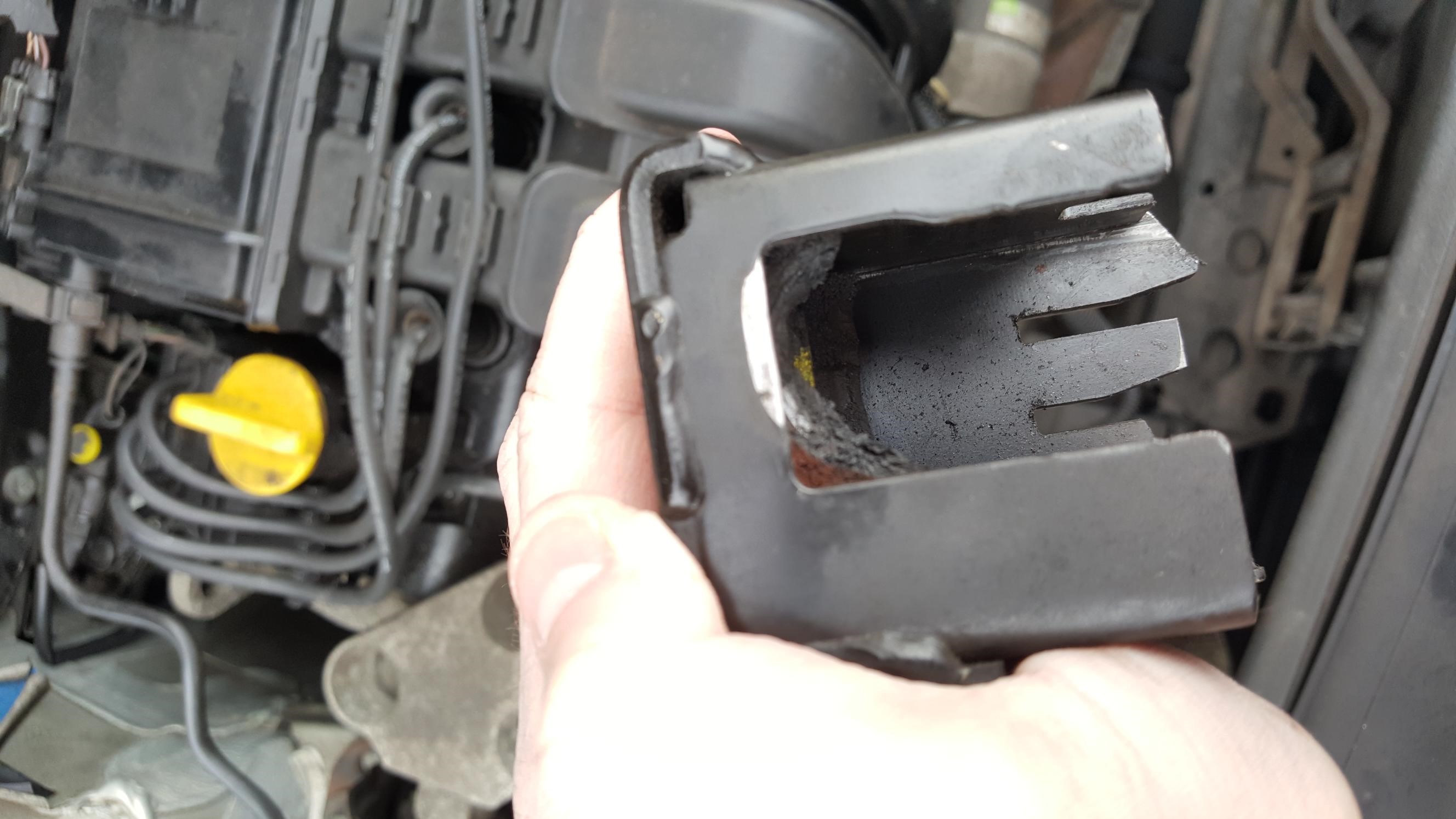

Hi all, sorry to jump on an old thread but i'm going round the different forums to let people know how i fixed my issue with the electrical light for FREE! :) in the hope that at least 1 person may benefit. I've had the car about 3 years now and in that time I've had the electrical fault light appear at various random times and it never caused me an issue (apart from the fact it becomes un-driveable) in that i could fix it quickly by turning the key in the ignition one notch anti-clockwise (think that's to turn electric off) then 1 notch clockwise (back on) the light then goes away and the car runs ok for however long until it decides to come back again and repeat the same process. Only this winter it got really bad! the car was jerking down the road as soon as i got over 3000 revs and the light was coming on continuously and was very dangerous, specially when on the motorway with kids in the car....Anyway to cut a long story short, i did some Googling and saw a comment about the black steel box that covers the plugs at the back of the engine (see pics) and how its a design flaw and rubs through the wires it's meant to cover. This causes the car to short out hence why the electrical light comes on. So, i removed this steel box and low and behold bare wire. My fix...................... electrical tape over the exposed wires chuck the black steel box in the garage and give the car a test. Well, what a difference a bit of tape can make, it's been a week now and i have had no electrical light appear, the car runs and drives superb! so smooth and idles lovely. I hope this helps someone else in the future. probably not many of these cars left though :(.
