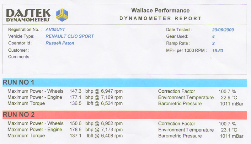

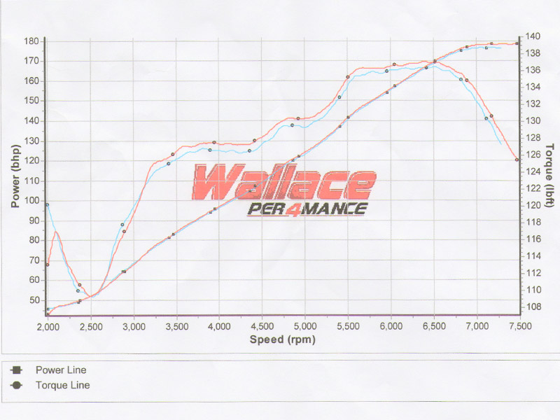

My Clio made it's power on the nose but at a different RPM than quoted by Renault. Torque let down but the exhaust as it leaks a little at lower loads/rpm.
Roller seemed to be producing accurate enough results. A couple of JDM Integra Type R's were coming in below book at 195bhp. VR6 Golf's, Subaru's and diesel Fabia VRS' all made book figures where standard and slightly more where modified.
The chaps at Wallace Performance said they'd had a few Clio's that made below book and were aware it's an issue.

was your car standard?
Yup, had 26k on the clocks. Standard everything, recently serviced. It might have been remapped as it revs quite high but I'm not sure the if that would have been something the previous owner would have done. He was a BTCC champ so that's prob. given it a few extra BHP haha
