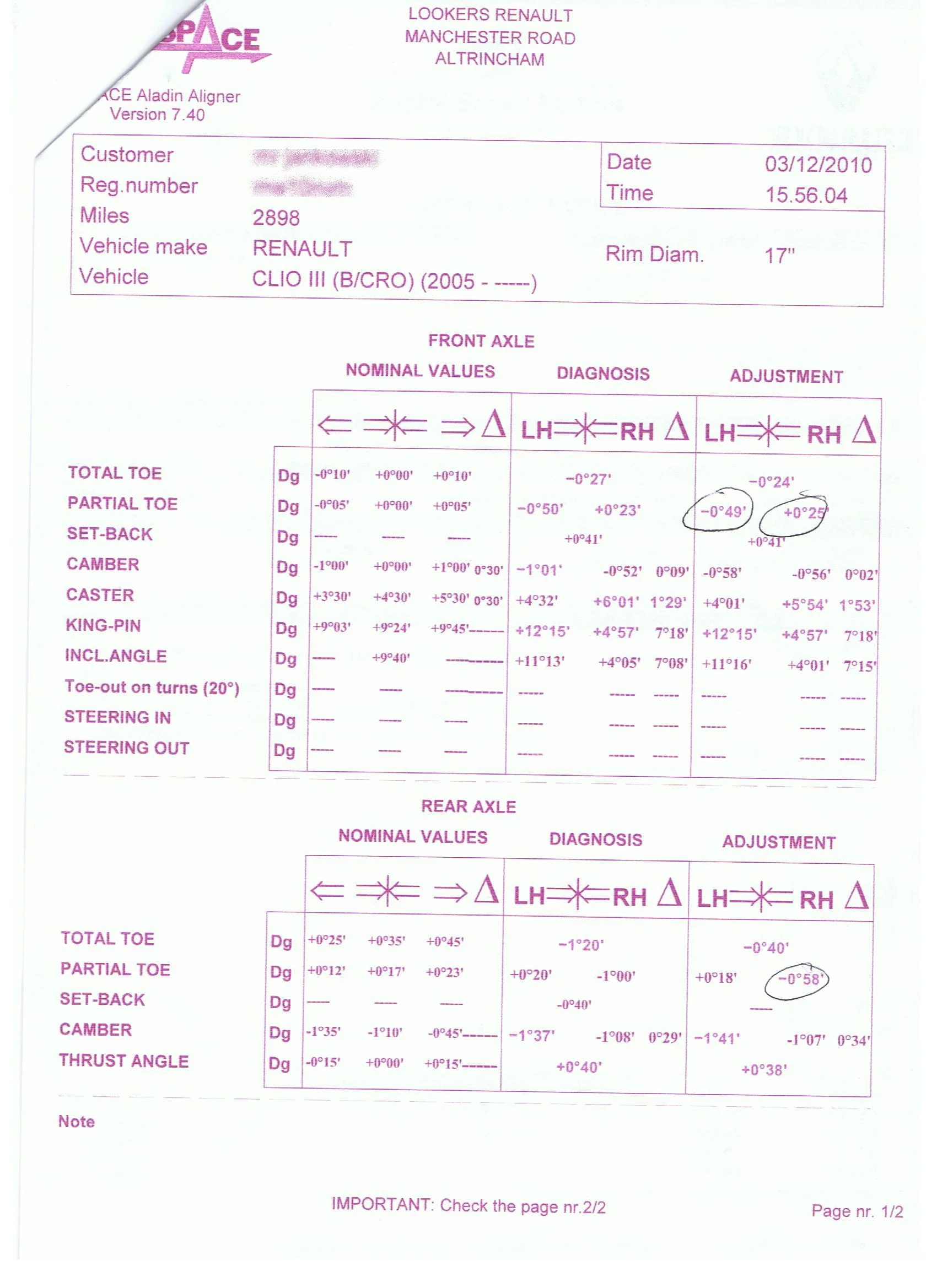

They advised me that it might be possible to straighten it up on the jig - anyone knows some specialist garage with proper equipment to do it ? I am based in Manchester. Below you can find the print out to see the degree of "damage"
I am in quite pat situation I do not know what to do now. Any help will be appreciated !

OK car is sorted now. Happily for my wallet Renault Altrincham (Bristol Street Motors) were wrong. They charged me 90 quid for tracking they haven't done or did not know how to do ...
Friend of mine recommended my an Accident Repair Center - they checked on their machine and from reasons unknown to me front wheels were completely out of alignment. It took few minutes to adjust and car drives same good as before. The wheel that clipped the kerb is alright + nothing bended or damaged.

If you have a look on the scan of the printout I pasted above the car they put as a reference was Clio III so maybe they were adjusting it to the wrong reference ? Machine that my car was on today had Clio RS in database.
So you hit the kerb with the rear left, didnt hit any of the front wheels but they adjusted your front tracking to straighten up the steering wheel?
