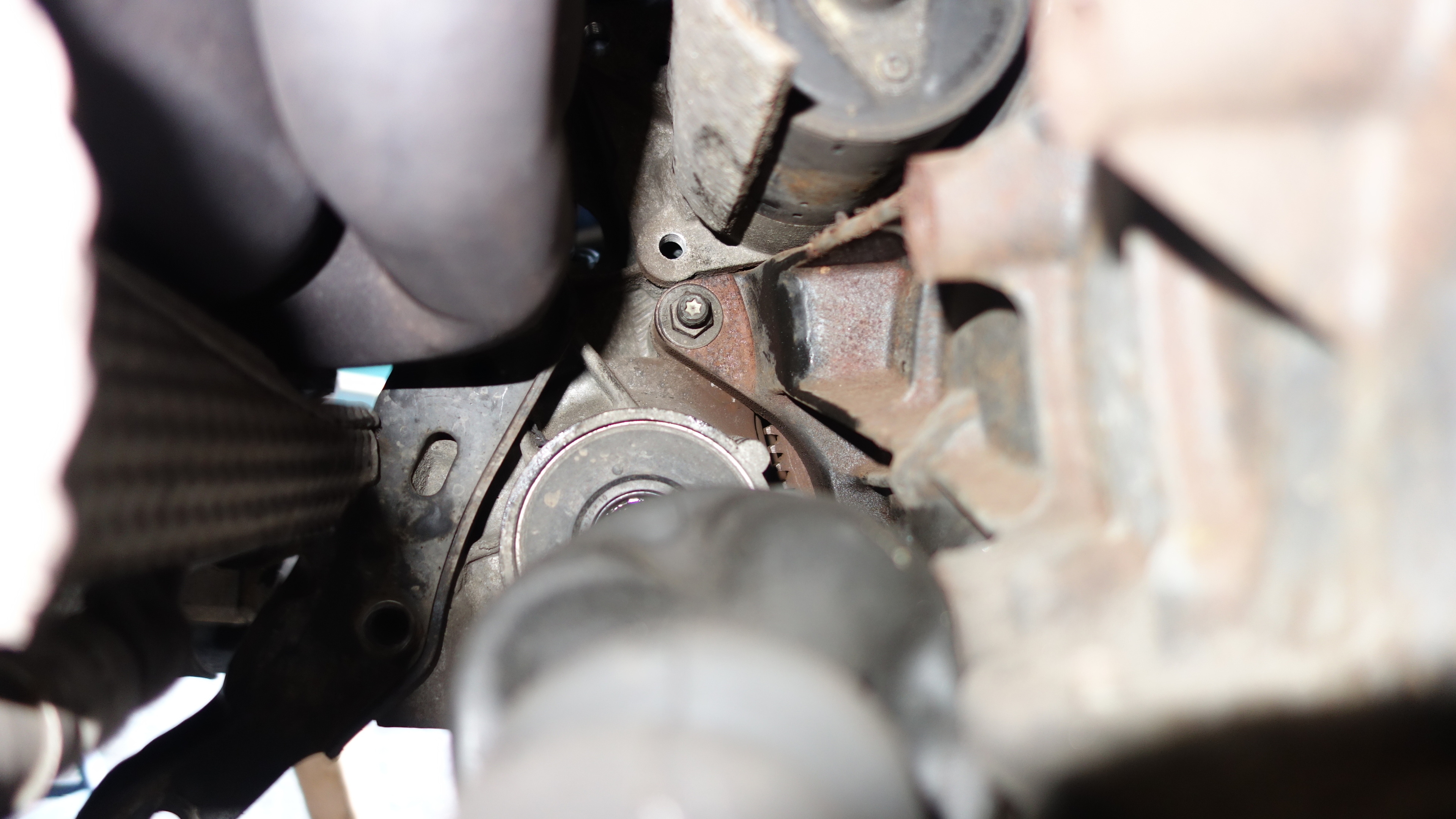

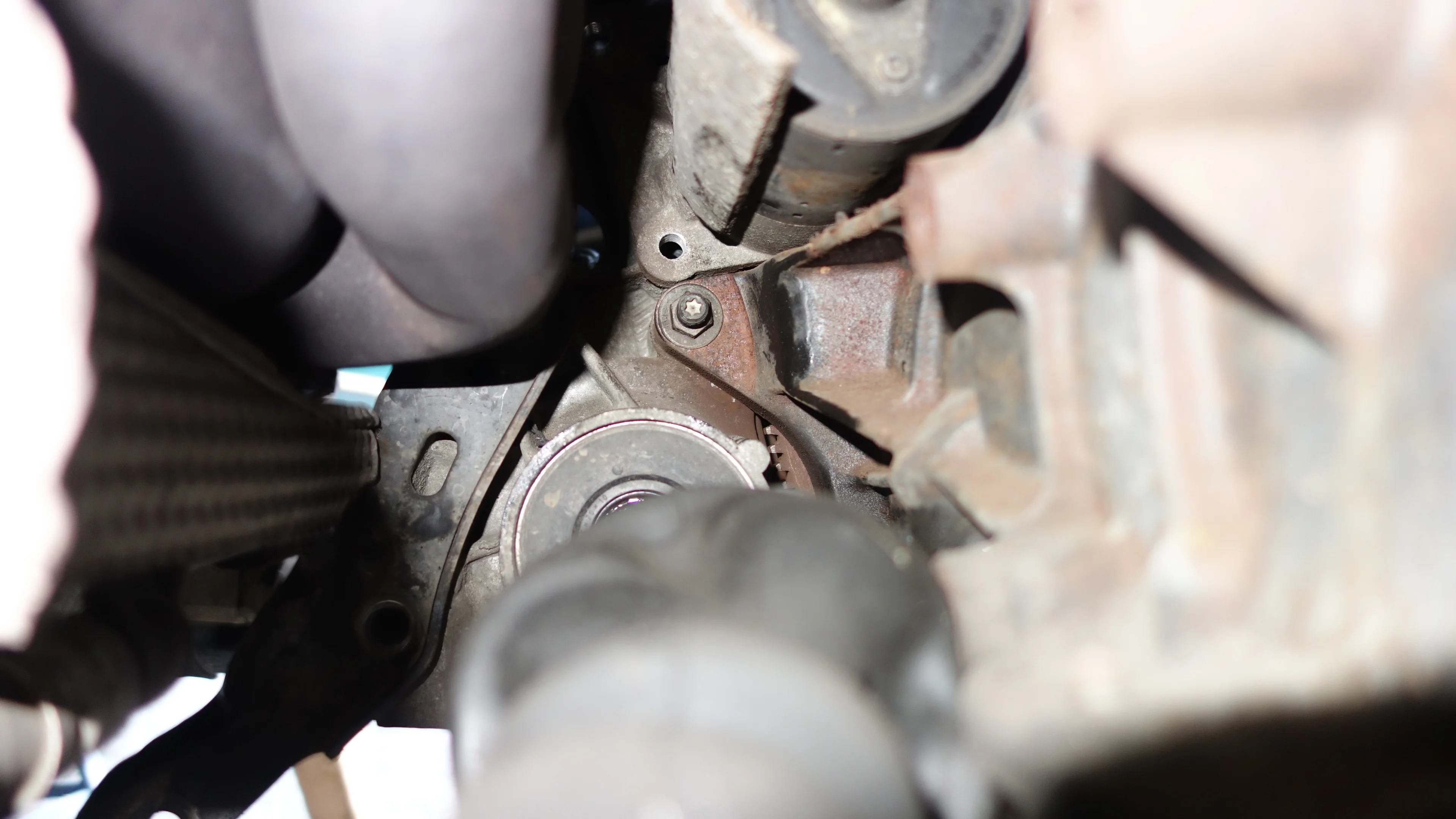

All shafts out, subframe lowered and plenty of clearance. All lower and upper gearbox bolts out, three starter bolts out, gearbox mounts disconnected. Used a gentle pressure on gearbox to seperate from engine and something is holding the engine and box - is it the 'torx' bolt/nut in picture - seems too lock the two together. I assume that the black 'clamp' that locates to the swivelled coupling can stay on the gearbox.
