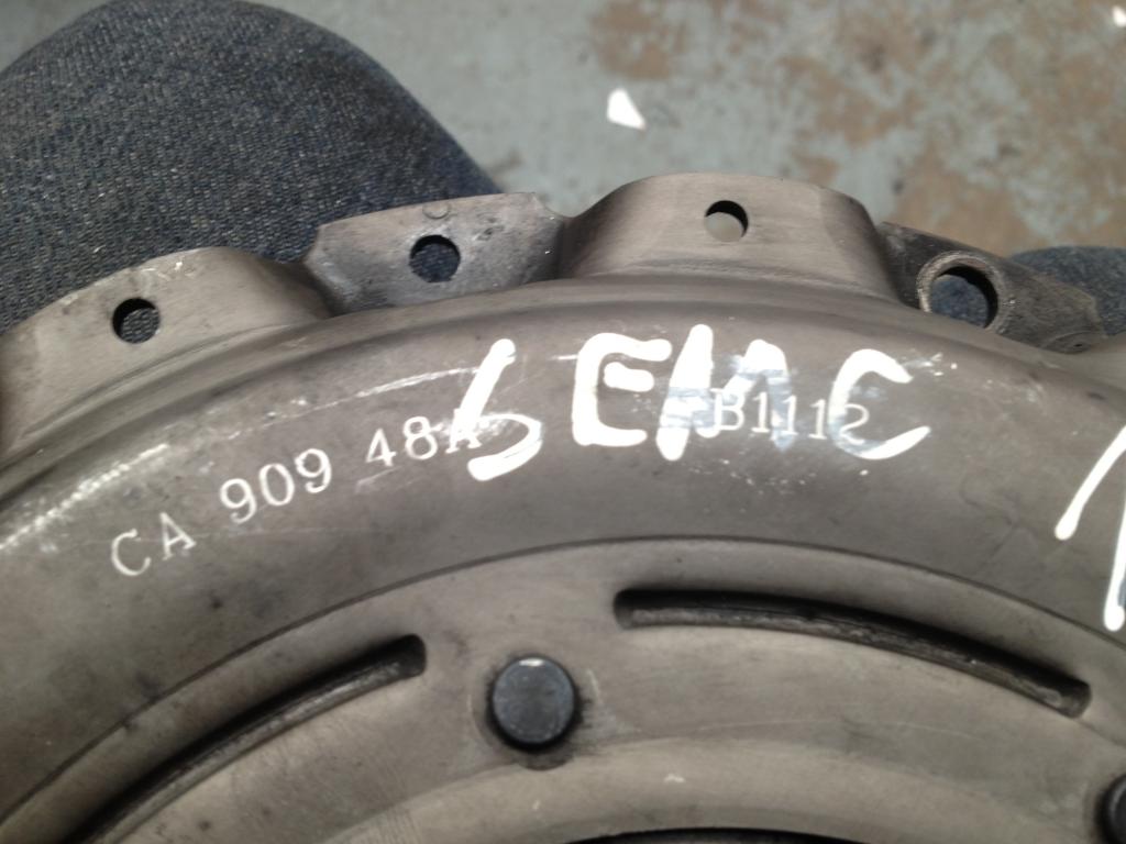

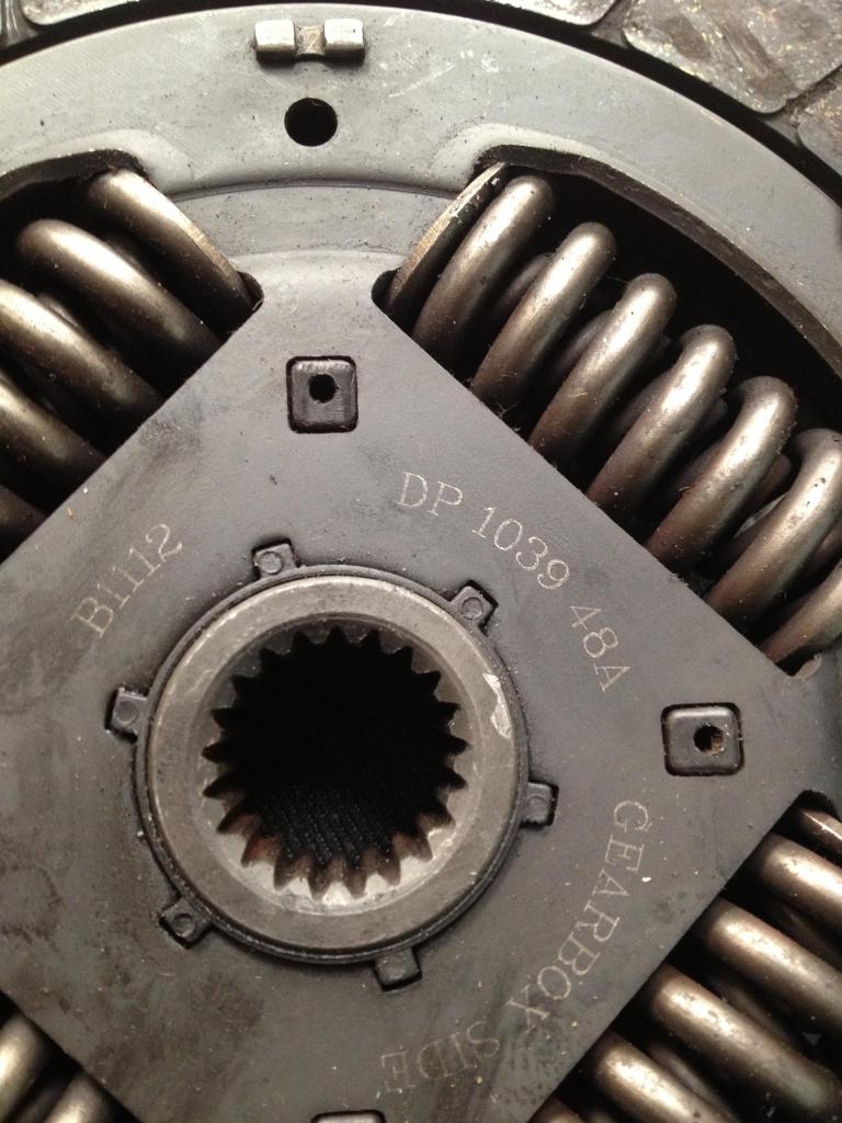

Bought a second hand Dual to single mass flywheel for my 1.9 DCi Laguna, came with a clutch, but trying to identify what the clutch is from. I basically want to replace it, as the one it has come with is quite worn..
However I only have the numbers on the pressure plate and friction plate to go on...
Any ideas?

Well from the white lettering I would say scenic 1.9 lol but you should also be fine with a traffic 1.9 clutch

Rarely, DMF clutches are unspung, whereas SMF are sprung. Which is true in this case, plus the SMF clutch is a lot different.

most of the traffics I have worked on are non duel mass and have the same clutch as the one in your pic it isn't nothing special
