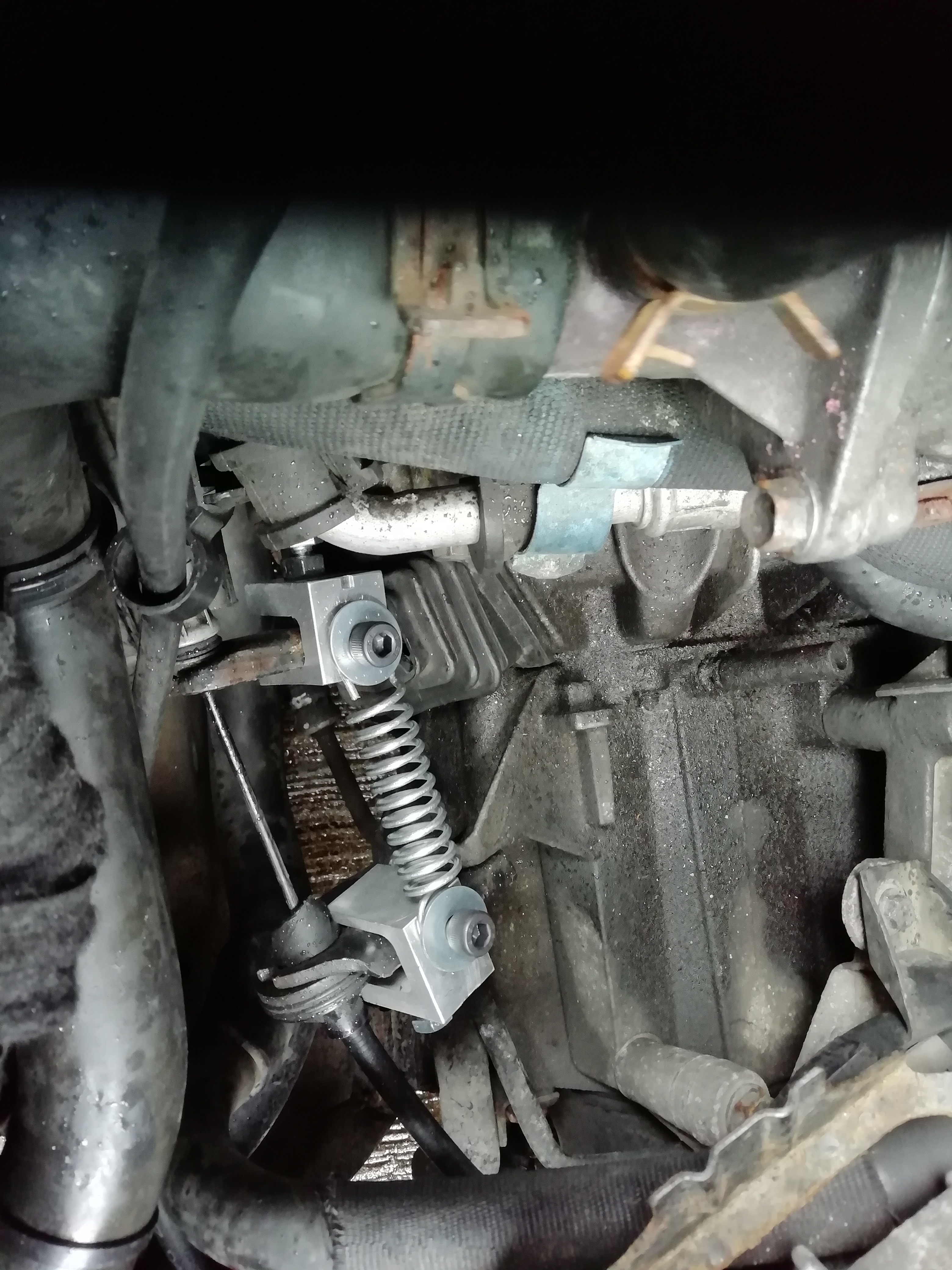

Evening folks, when I first bought my clio I noticed how heavy the pedal was. Looking online it seemed the norm, so a made some parts (Nov 2019) then winter, covid etc. Just didn't get around to getting any further with it.
Roll on to last week and using the clio more now for back and forth to work decided to crack on and fit the parts.
The result is the pedal is much lighter, had to fiddle around with the spring as had to modify it.

Stock clutch only becomes heavy with age and mileage, probably needs changing if your finding it heavy. Id be concerned at adding extra load onto the release bearing with the tension.
There's no extra tension on the release bearing when the clutch is up. The arm is in the same position as when there's no spring tension on it.
I like the idea but I'd worry about the clutch sticking in whilst driving hard
The spring is under most tension when the pedal is up, if the spring broke it would just be a heavier clutch again.
I'm not saying about the spring breaking, im saying about the spring jamming.

Theres got to be more tension on the release bearing with it pulling on the arm, unless the spring is very weak, which would essentially do nothing.

Yeah basically a helper spring, had the idea from a land rover of all things. Although that's on the pedal itself, didn't fancy doing down that road.

All your doing is taking away some of the force from the clutch pedal when you press it. It's not like your dragging your foot on the clutch.
Yeah I can't see that being a problem at all, it's like how the vacuum system works in the brakes. The applied vac doesn't adversely press the brakes only until you press the brakes and that's when it assists you.

If you were able to make a bracket/spring combo that you could put over the clutch line itself you'd be onto a winner.
The line would act as a spring guide reducing the chance of it snagging leaving an 'open' clutch whilst also looking oem. You'd have to make sure the line could still clip in but this is easily done.
Line easily disconnects from the brackets.

Assumed it was an old high mileage stiff clutch at the end of its lifespan needing a heavy spring for assistance - loading up the release bearing and removing the free play at the end of the pedal when not pressed, on the plastic cased oem release bearing which is not that strong in my opinion. No idea if continuous pressure running release bearing against pressure plate forks would cause premature wear.
Another option for lighter clutch is extend the clutch arm a little, 20mm more or so if room available. This should be fairly simple to drill and bolt on a piece for testing in situ with an angled drill.
We used to run the clio 172 standard length arms on the gtturbo for similar results back in the day, the extension making a very light clutch. Downside is moving the pivot may put a little bit more stress on the casing on the gearbox. On the plus side the release bearing will not be loaded up and have the correct free play when not engaged.

Simple and no drawbacks. It would be very very bad luck to jam something if it brokes, and even that very unlucky situation, can be mitigated by sleving the spring.

That was my concern too, as surely it can only either 1. Put extra load on the clutch release bearing or 2. make no difference when the pedal is pressed. Surely one is a consequence of the other?
Why would it put extra load? The force made by spring is subtracted from the force made by the leg. The force needed to actuate the clutch is constant.
