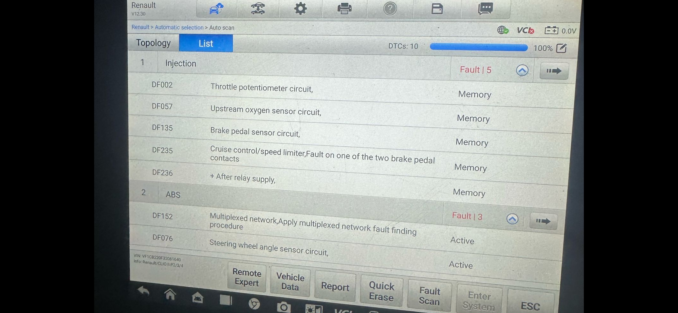

Faults on his code reader, does this help? the guy is an absolute legend, he's still on it now to try and sort it!
At a guess Df236 listed, even though not currently active is suggesting there is or was a problem with the injection locking relay in the fusebox or other power or ground issue.
