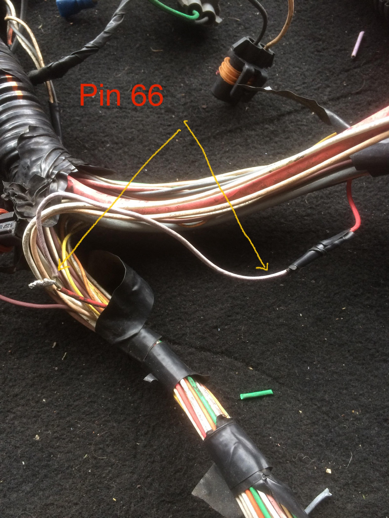

Them faults you have on the screen makes it sound like you have a broken wire with ignition on do you get the throttle body working?
If you want to determine if the ring around the key barrel is any good , swap that first as it’s cheap , also with codes all clear , disconnect it and then try to start it again and see if all or similar codes return , indicating that the key is not being seen like @Brigsy has suggested.
It’s a little diagnostic I have done in the past just to confirm your on the right path with code popping up if something is removed from the circuit .
I have also seen a bad 12v feed wire in the loom that feeds pin 66 , so if that’s power is not getting to the ecu it’ll never start .
Can you or anyone else tell me where this is exactly? mechanic hasn't checked this and doesn't know where to find it!

The lad is looking at it again tomorrow If anyone can tell me where to find this, I'll pass it on.
It literally lives on the key barrel.
A black circular electronic coil that reads the chip in the key when inserted into the ignition and ignition turned on.
