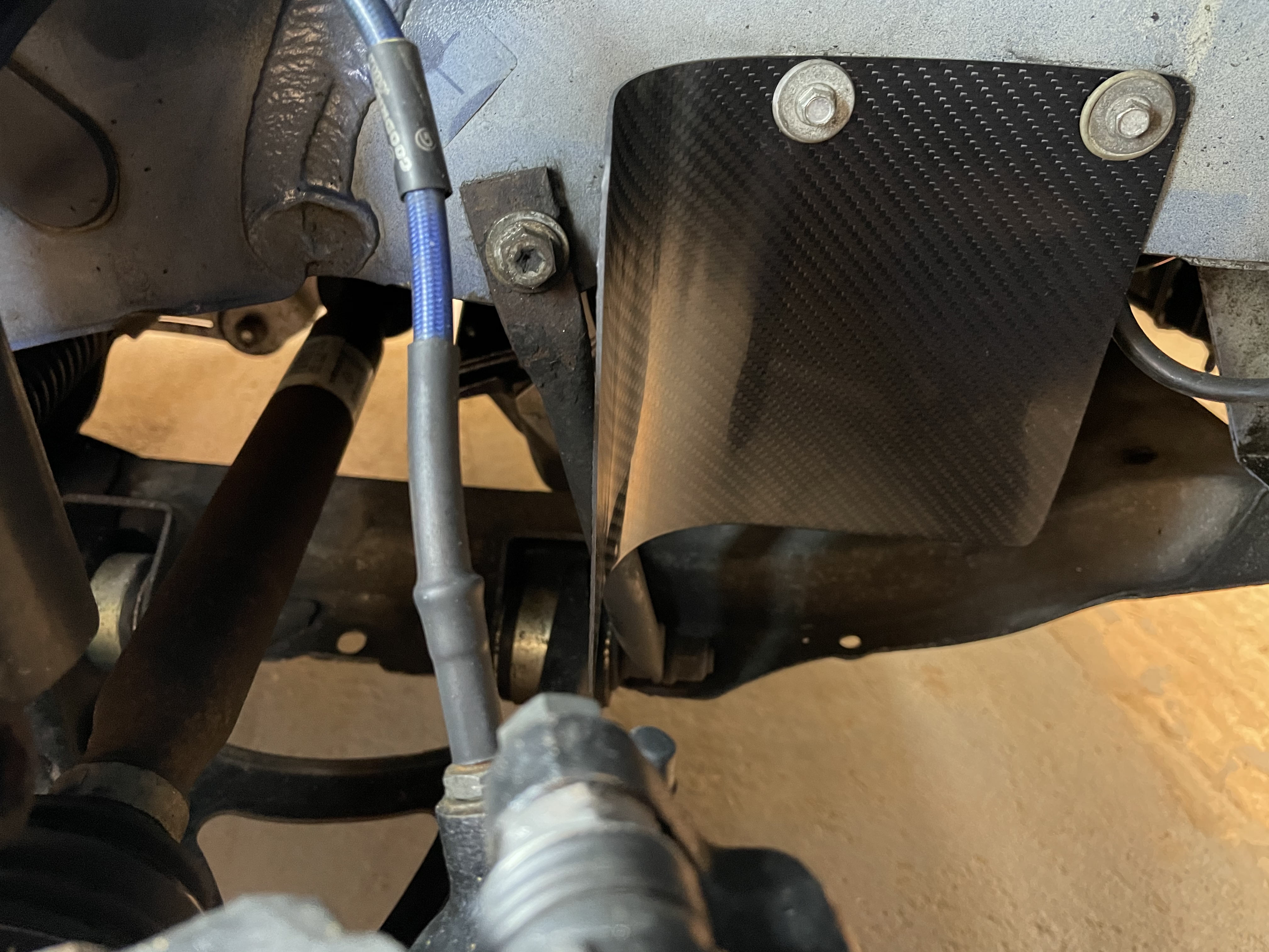

Bought a set of the below ages ago ready to fit this year, just been outside to try and roughly line them up to where I would want them, however wherever I put them there is only going to be one rivet holding it on each side at the top, which I can’t see being good enough to secure them, how have others mounted them? The proper ex cup racer ones I believe have an extra bottom mount which bolts to the wishbone area.

Two at the top works just fine, not cm composites deflectors but same principle.
JamesBryan
The cm ones are dog s**t, I bought them, offered them up and put them in the bin😂
Similar thing when we tried to fit a set to my mates car.
They bend that far towards the brakes that it hits the brake lines/caliper on full lock.
Would have needed a fair bit trimming off.
Better off making your own.
