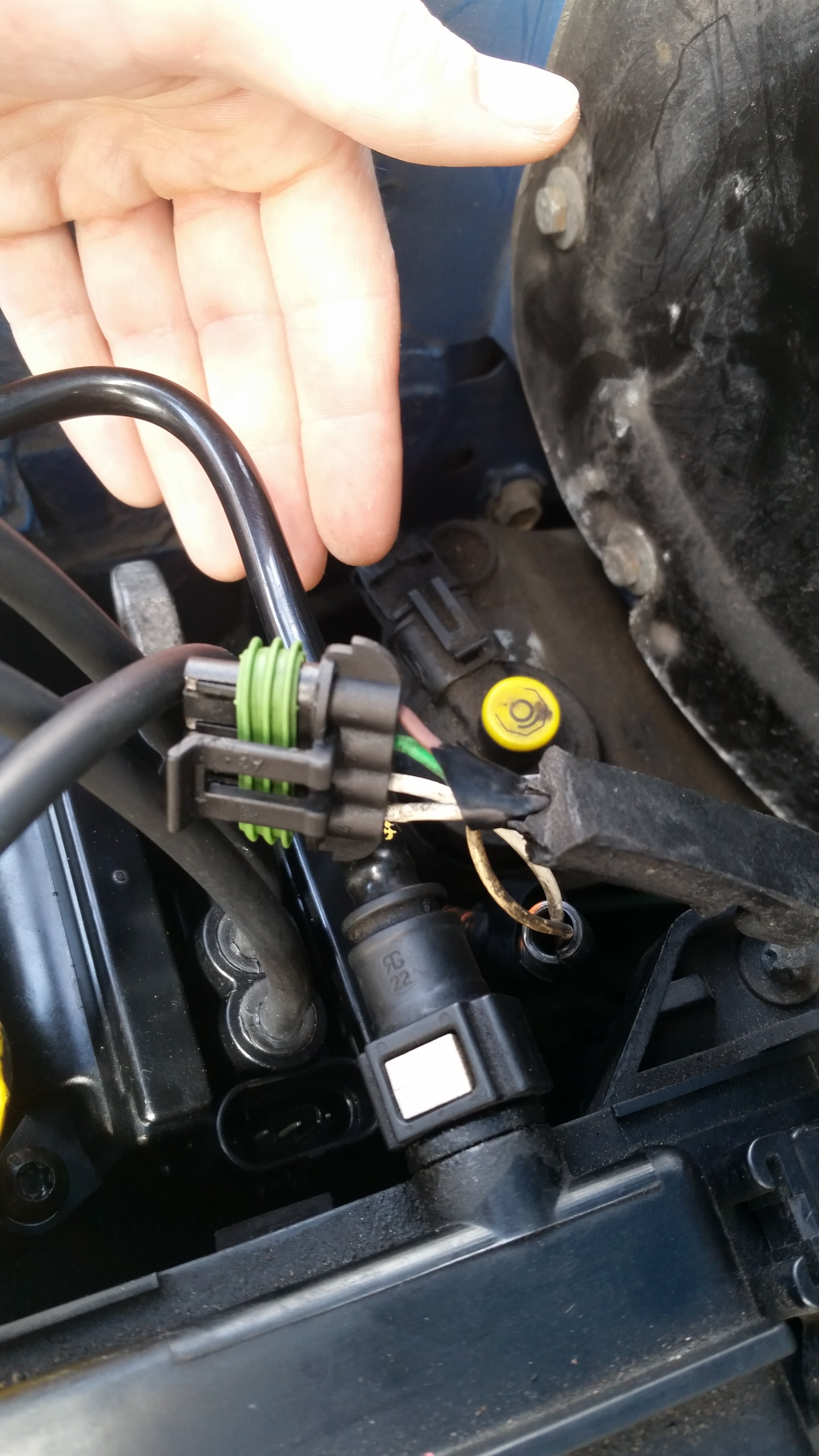

Ever since the car will not start. After many hours fault finding, I've realised the coil pack connector is not receiving any 12v power. So no spark to fire the fuel, hence no start!
The connector on the plug is four pin, it has green, white, white and brown wires. Can somebody please enlighten me on where the earth points are? Also any relays or fuses that could cause this.

There's no earth points at the coil pack plug mate. It's only a 12v feed and 2x signal wires. The thicker of the 3 wires is the 12v signal. There should be a relay for it, but I'm not familiar with a 1.2, so I can only go off the position of where it is on the 1*2's and that's on the n/s/f inner wing just behind the headlight.

One thing though, my connector is four wires and four pin, not three. Two white, one green one brown.
I will get onto that earth point in the morning, cheers mate.
Think I'll replace the relays too.
Here's a photo :)
