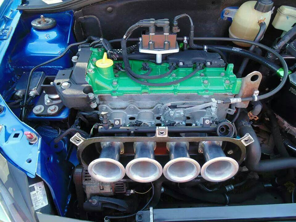

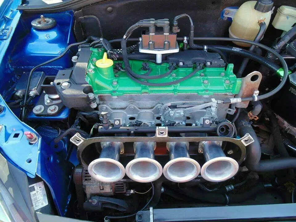

Not really anything to do with the op but what do you mount it to when you mount it on the battery side of the engine? Mine is on top in the standard position but I'd like it at the side?
NorthloopCup
You can buy a bracket off ktec to relocate it. It bolts on to where the engine lifting eye currently is in your pic on those 2 lugs sticking up.
  XC90, 330d, Trophy’s
I'm hazarding a guess that Ktec only sell that mount as part of a kit, probably within a ITB setup as I cannot find that mount on their website.
