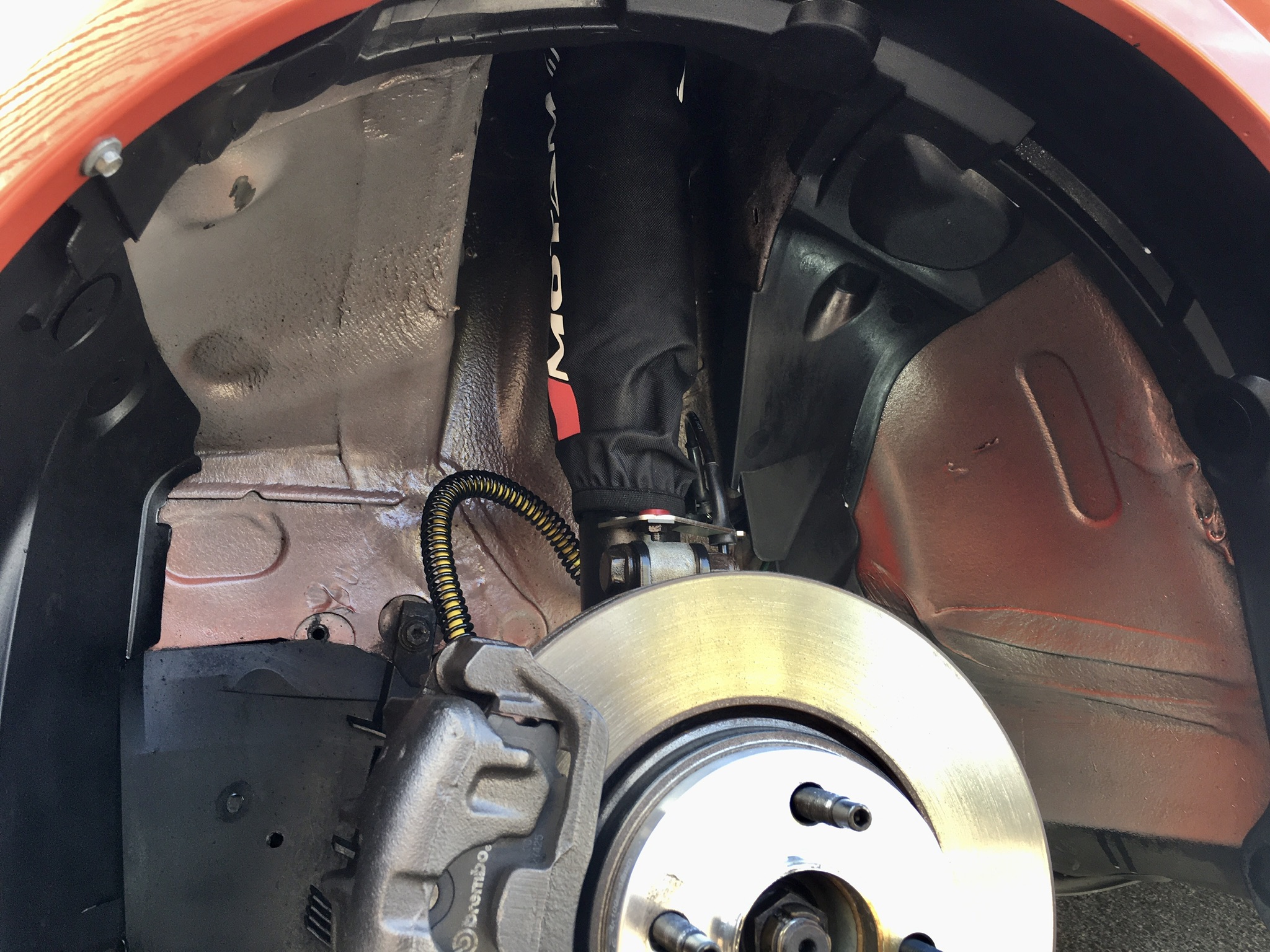

I use ACF50 and the Motamec items.

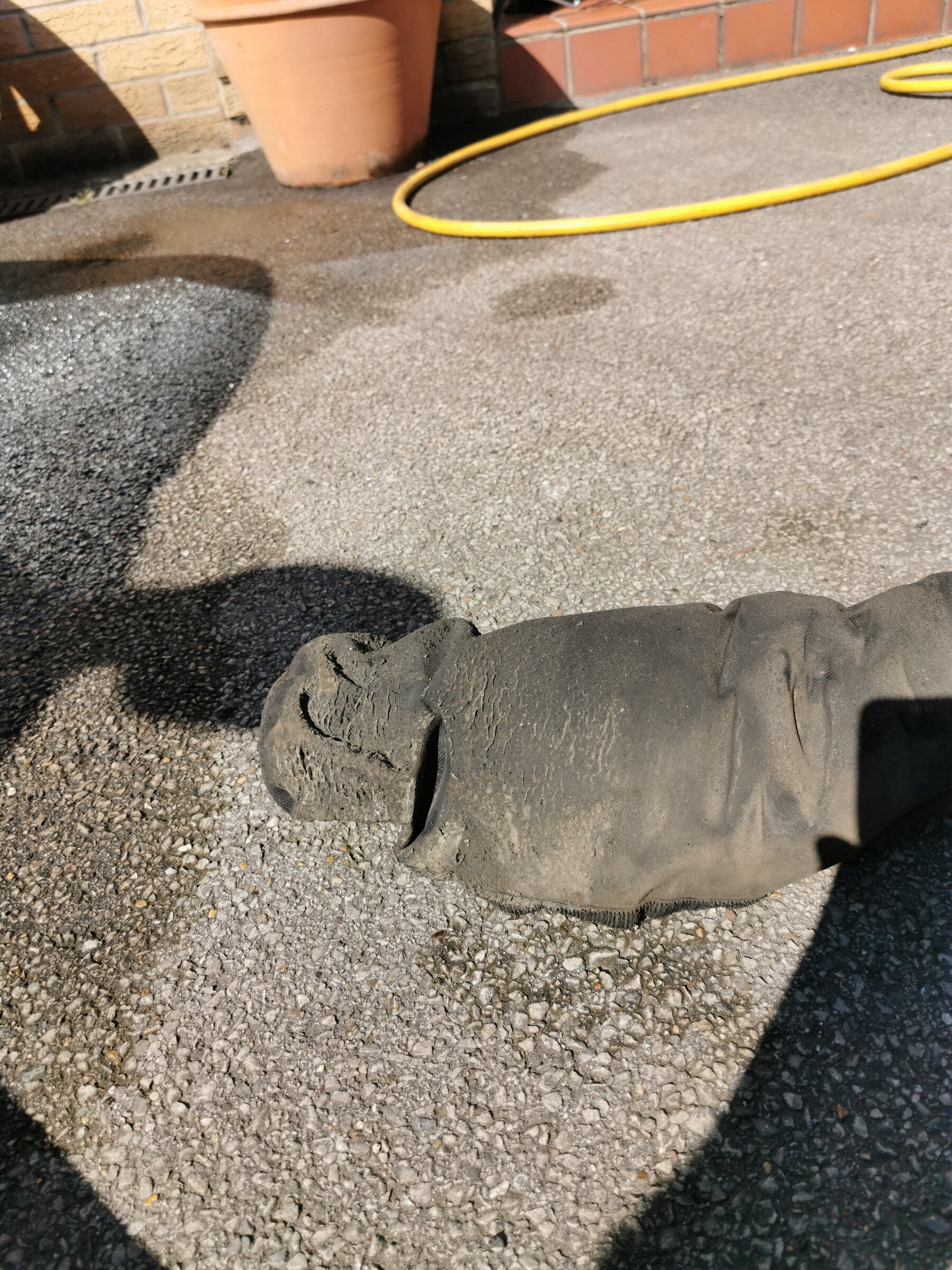

Took mine off after a year or so the other month:
The covers were filthy, the shocks were lovely and clean😊. Mine are these ones on ebay: 154005908157

As above, use some sort of grease/corrosion inhibitor to protect against trapped moisture and make sure that the bottom velcro of the sock doesn't sit on any important threads as, if anywhere was going to corrode, that's where it would be.
