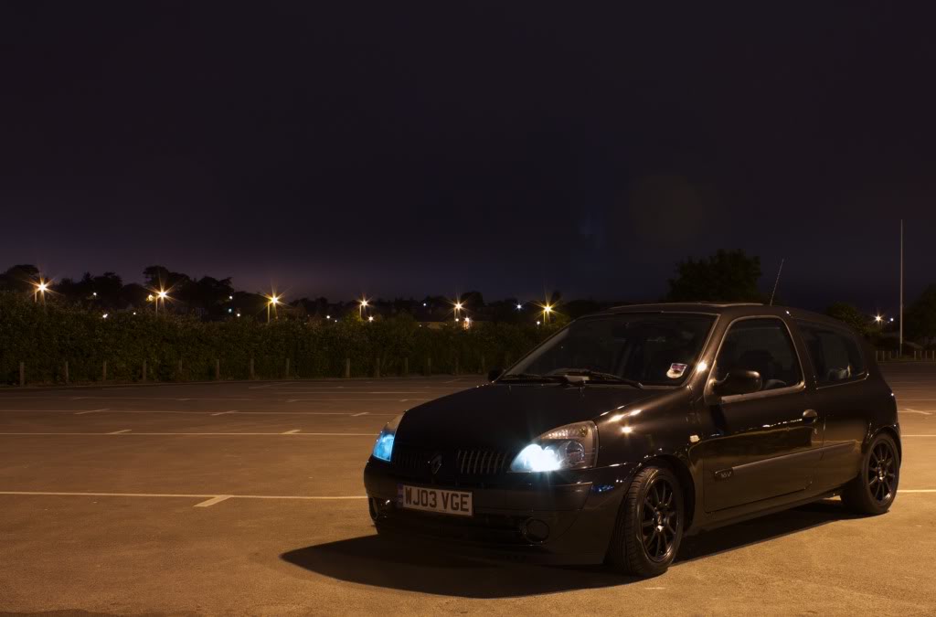

  MK3 GTI golf 16v
there not raceland coilies there AP's but you get the idea
