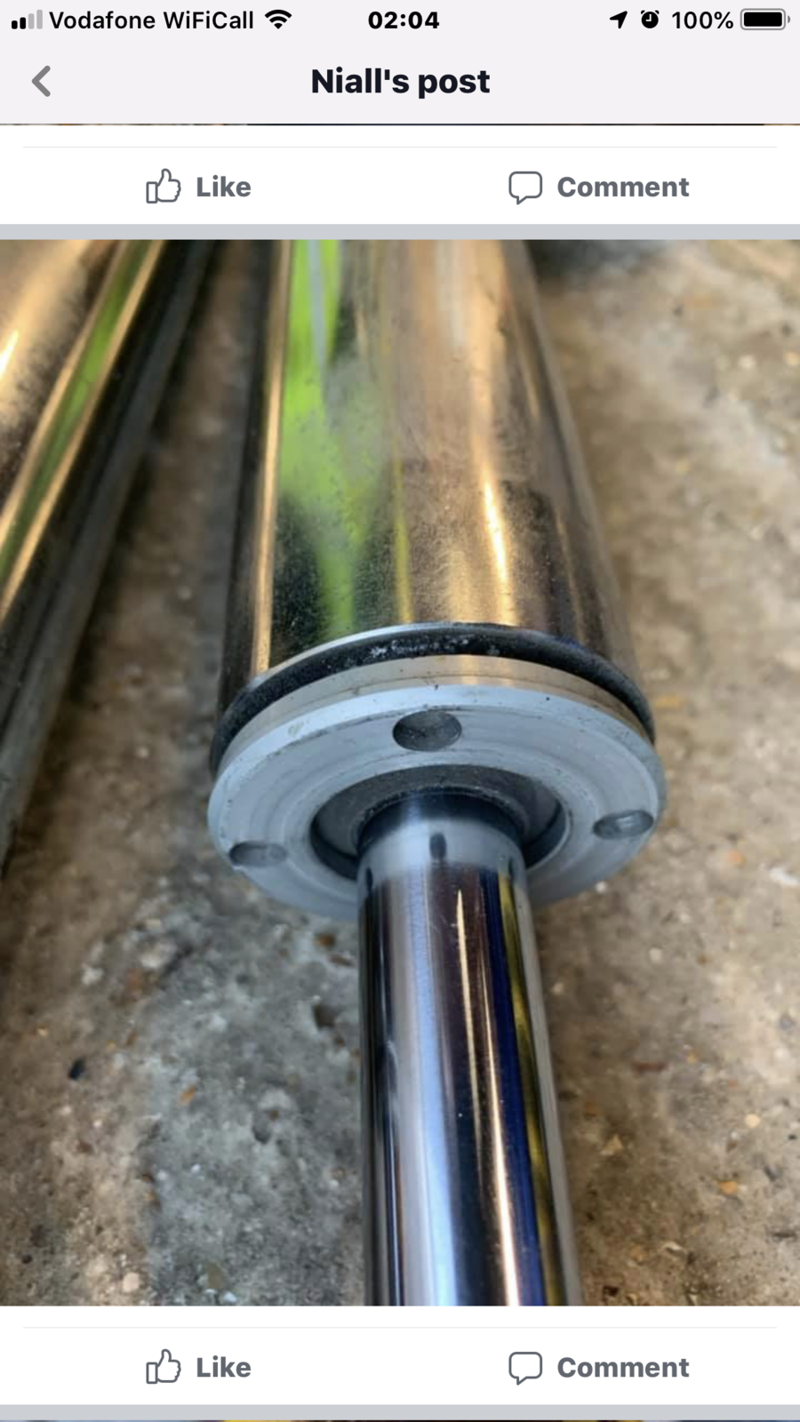

Couldn’t tell you For sure. This is the top of the damper though:
Does your damper have a Schraeder valve on the bottom? Or sometimes it’s presta and sometimes it’s a needle valve, similar to a football.
The bit on top looks like a wiper seal, not an oil seal, very similar to the Twingo R-whatever-it-is Sachs.
