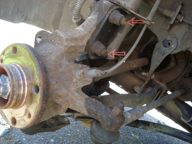

Im thinking of getting this coil over kit, but im unsure about if it will fit my clio or not. Its a 2002 Clio expression 1.2. If someone could show me on a pic where the actual bit is that needs measuring (either 52 or 58 mm) that would help loads.

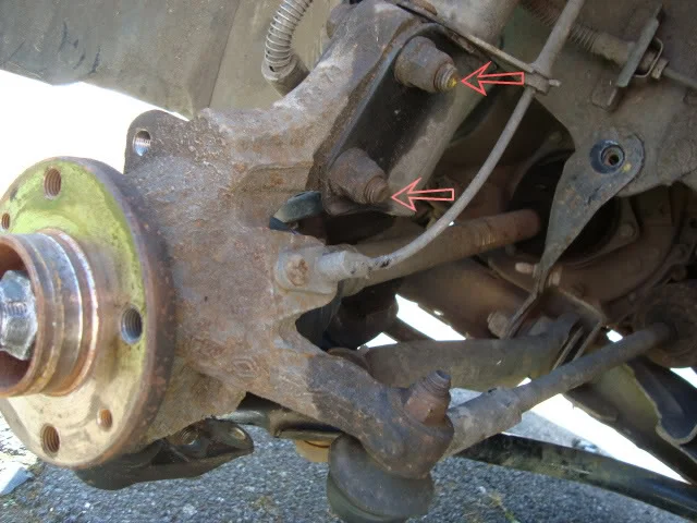

Basically the distance from one bolt (arrowed) to the other bolt (arrowed), measured from the centre :)
*excuse the dirt!
Ive just gone and measured that and it turns out I can get those coilovers as its at 58mm
Happy days :)
