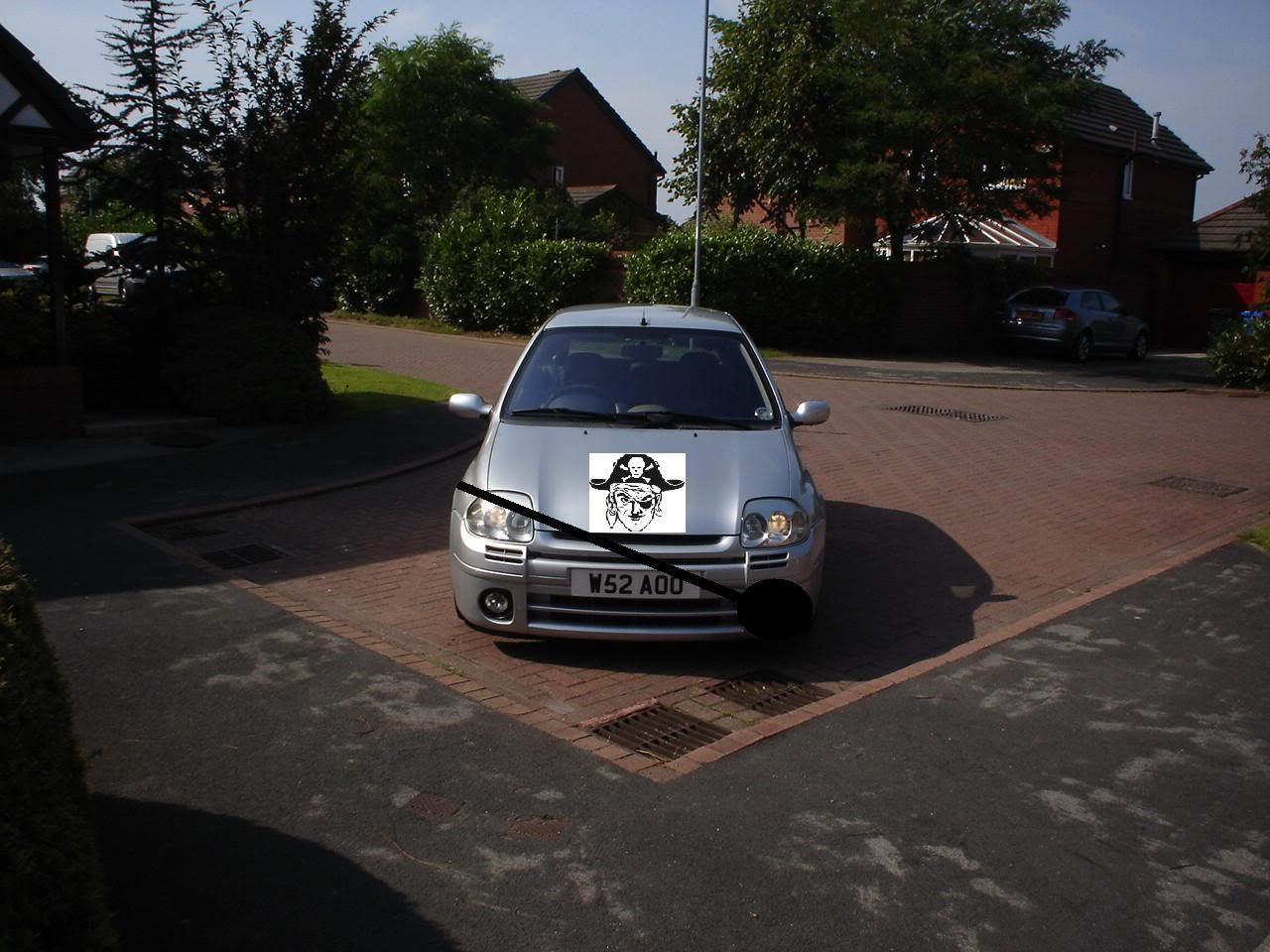

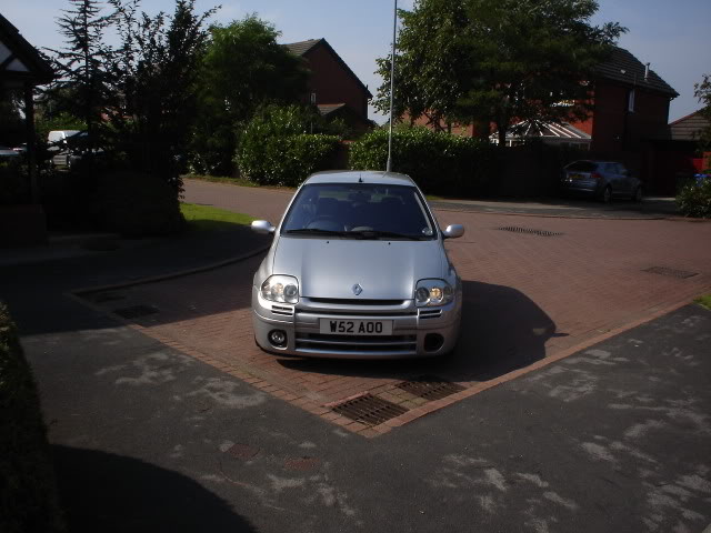

Atm its perfect as im missing the passenger fog light, due to putting the car in a ditch! :(

^ i think it looks awsome (not with the pirate eye patch, it needs a parrot to compete the look)
LMAO
