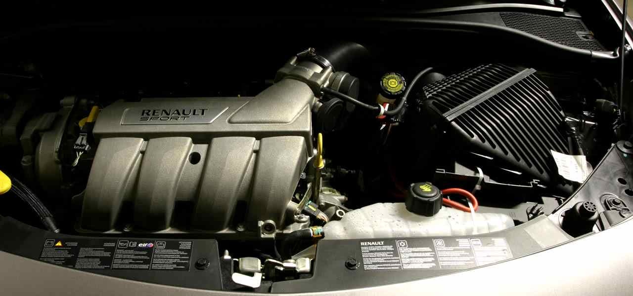

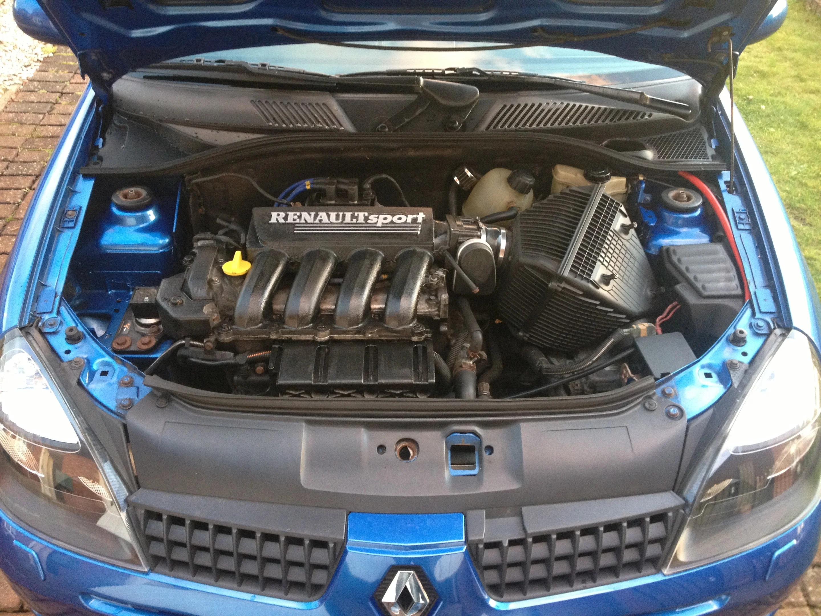

I bought my 172 Cup in June and the previous owner had fitted this airbox. It doesn't look like other V6 ones I have seen - is it an Espace one? It's fitted with a panel filter and does make a nice sound.
My water temp needle usually sits just below half. On hard driving / acceleration it climbs a fraction to halfway.
Is it getting enough air there or should I fit a feed? If I should where to route it and I take it 70mm will be sufficient?
Cheers
Haha yeah I did wonder a little! Hopefully someone will know. If you google V6 airbox an occasional picture of one like this comes up.
Getting a chuckle out of this :smile:
Surely someone must have one like this or know what it is?! The guy went to a fair bit of effort relocating a smaller expensive battery to fit this. Other things done point to a fair bit of knowledge and common sense...

Google - yep It's a Ph2 V6 255 airbox.
May or may not keep it. 20kg? It's plastic not made of lead :-D
Well, that's different. No idea if its any better than the standard setup though, probably a waste of money and effort.
I doubt it's better than standard. It gives a loud warble / roar if that's your thing. It's not mine so will be looking at changing. Either OE or ph1 airbox.

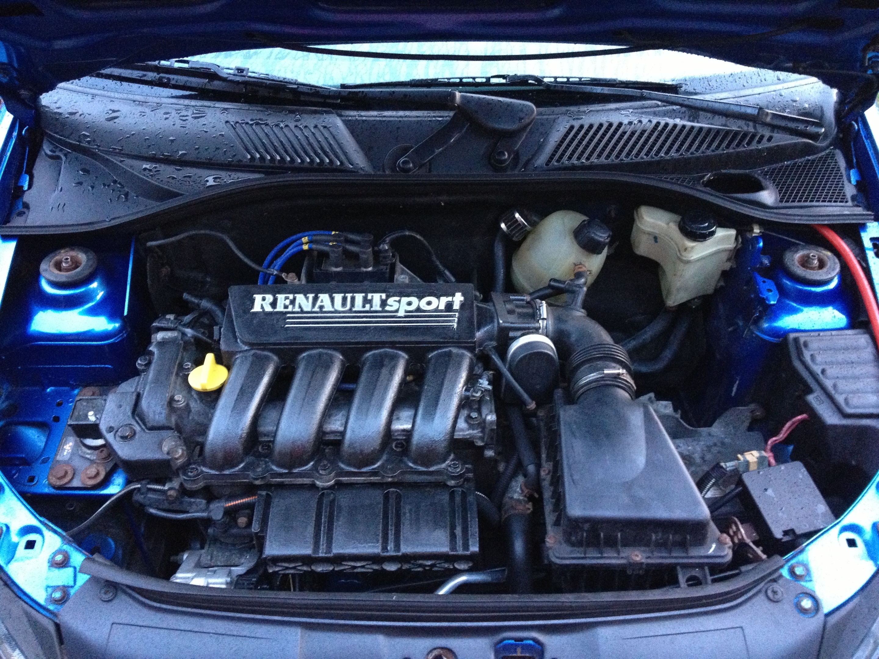

Dug out the box of bits that came with the car and found original airbox!
Don't know if its fitted perfectly but it's fine. The cold air feed which was a b**ch to squeeze thru a tight gap so left it off. Breather pipe at top missing also. Don't know if that'll do much?
Took for a spin and its a little quieter. Doesn't sound as good though. It's never going to be a quiet car and its lost the rumble / warble at low revs which I quite liked in hindsight.
Driving wise though it is definitely less responsive low down and feels slower up till about 4k. After that it feels quick and a decent shove in back but don't think quicker than before.
Overall not as good I'm sure. Going to stick the V6 one back on. Also noticed the V6 has a nice KTEC panel filter inside. Will get it on the RR next month and see what it's putting out.

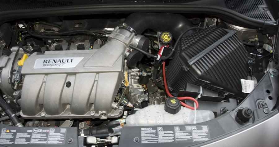

A little more digging and they seem to use this airbox on the Clio R3 rally car.
A few 197s have it too.

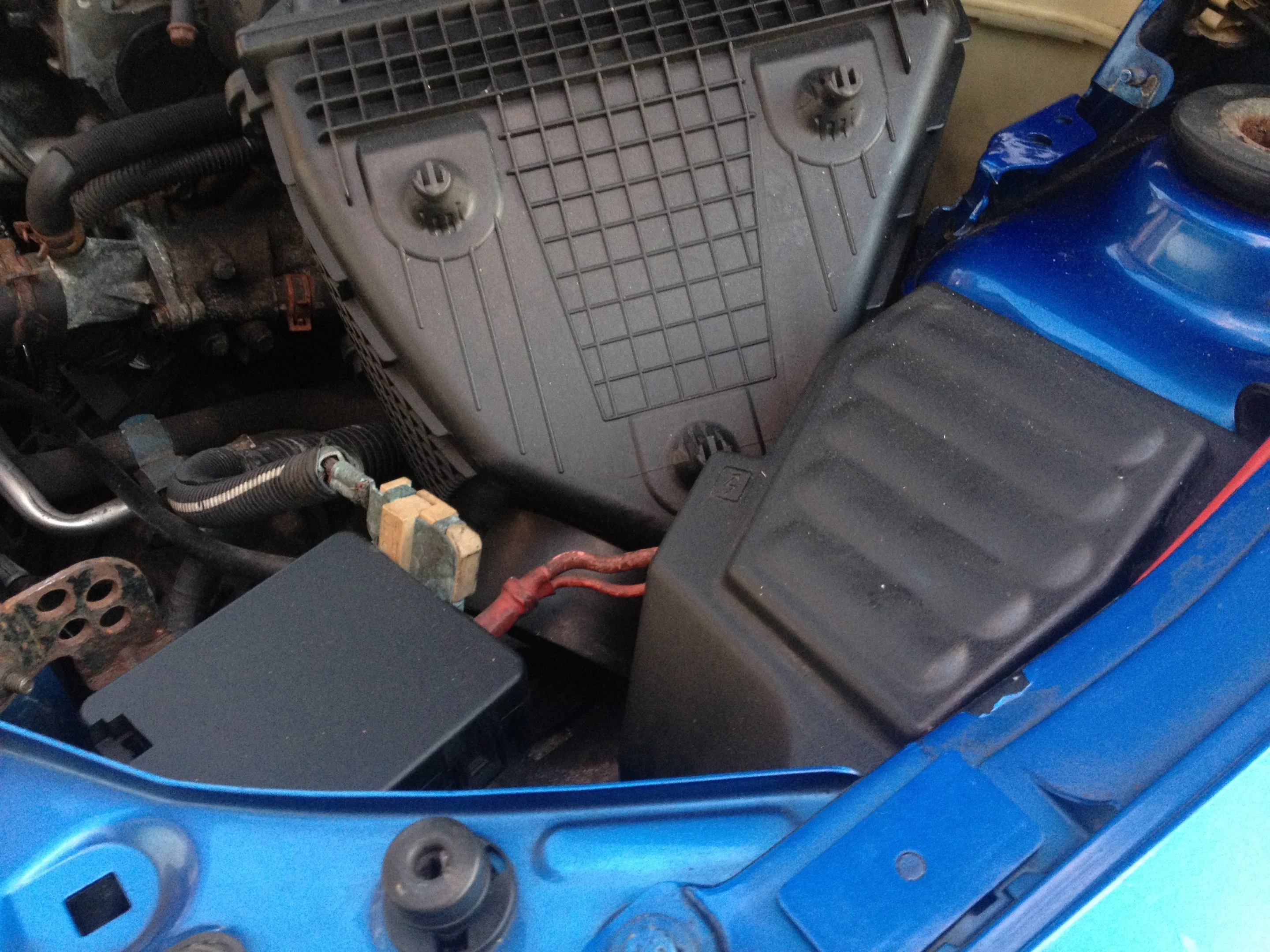

So the cold air feed pipe goes to the bottom hole? Not the hole on the right hand side? Where does the pipe go? Below the headlamp?

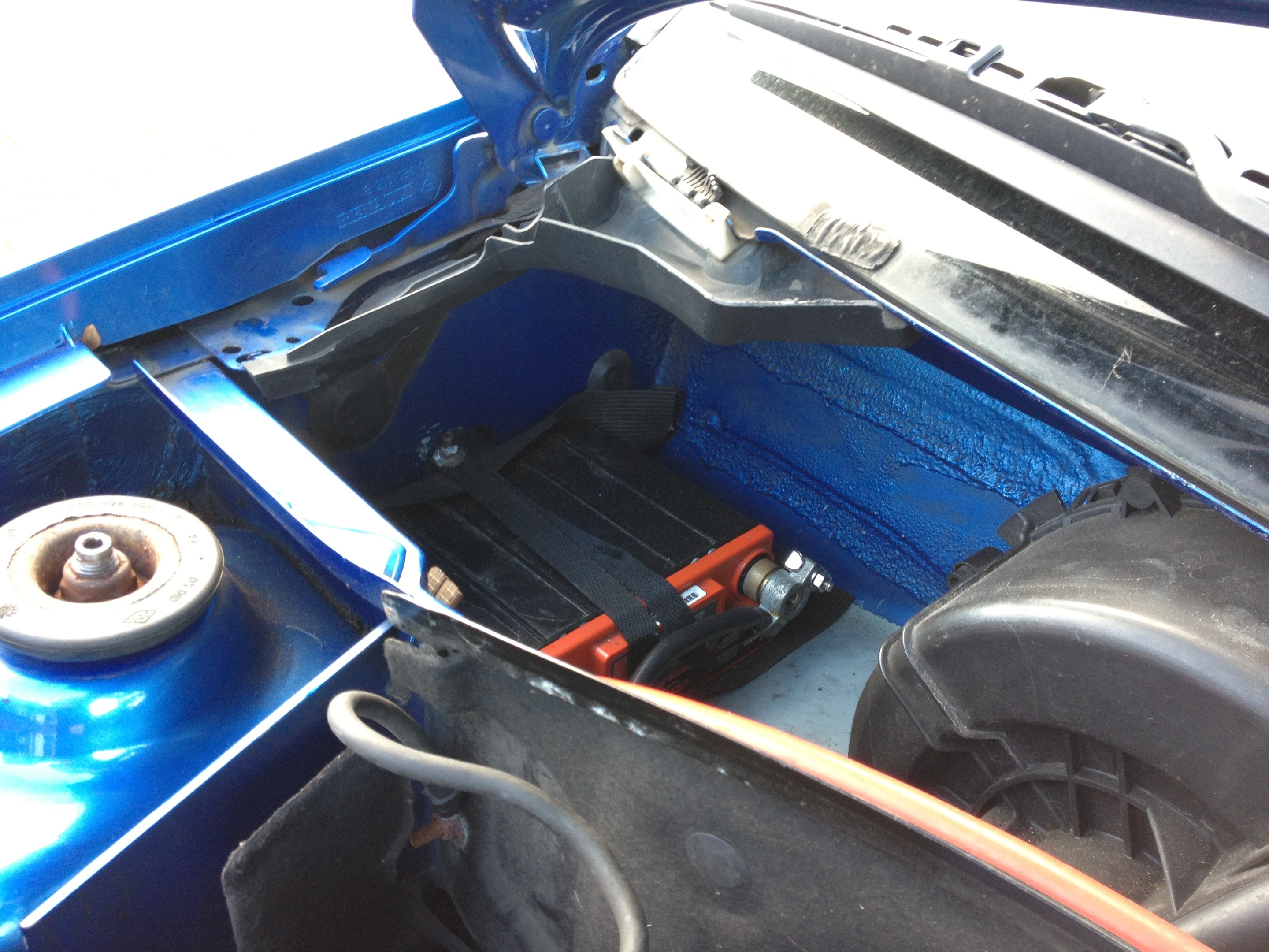

My battery has been relocated under the scuttle (left hand side). Basically above the left hand strut top.
you want to get that breather blocked up or piped back in.
It won't be happy if it sucks in any grit!
On the standard airbox, there are 2 cold feeds, on goes through the hole just infront of the airbox behind the headlight, the other goes downwards iirc.
If your battery is under the scuttle, wheres the washer fluid bottle gone?!

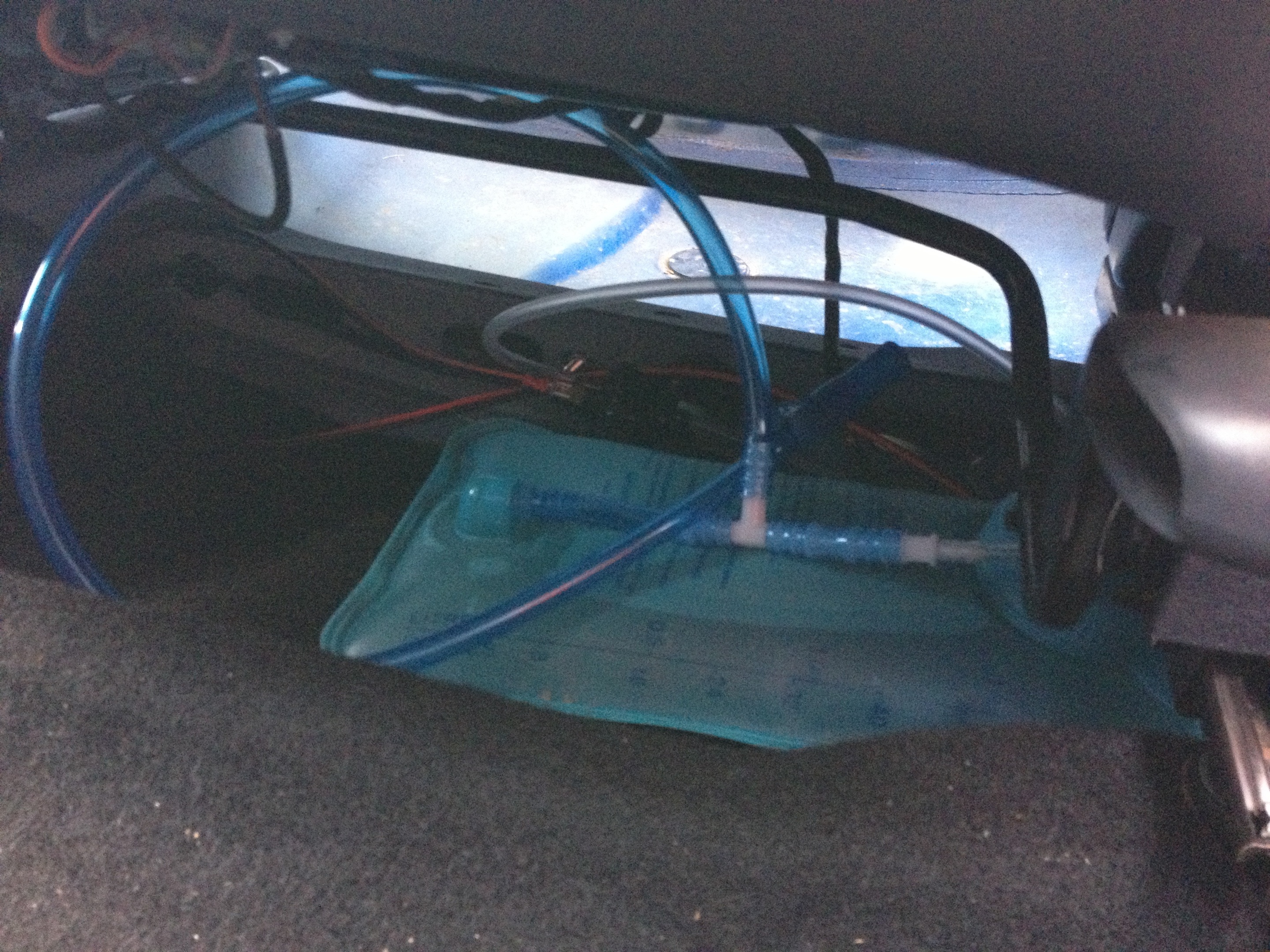

Here's the battery location
Washer bottle removed and replaced with this under the passenger seat
I read it as the battery was on the other side where the washer bottle normally lives.
Right odd setup you've got going on there!

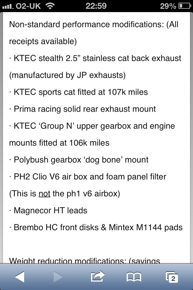

Here's the spec when I bought:
V6 255 airbox
KTEC sports cat, centre and backbox
KTEC engine, gearbox and polybush dogbone mounts
New Cup dampers
Brembo high carbon discs
Mintex 1144 pads
Magnecor leads

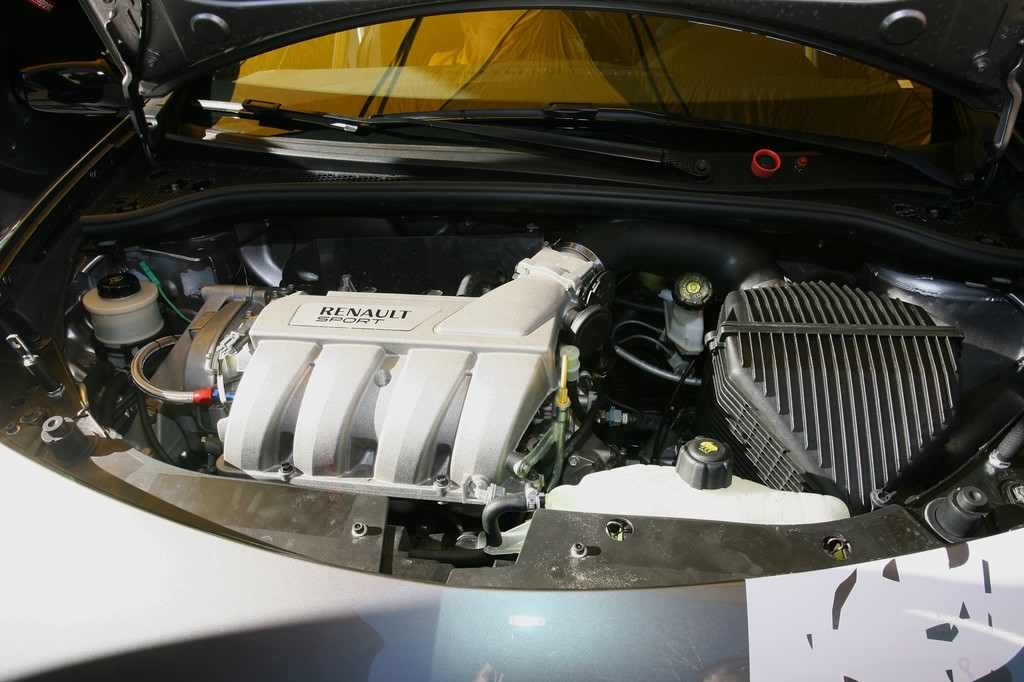

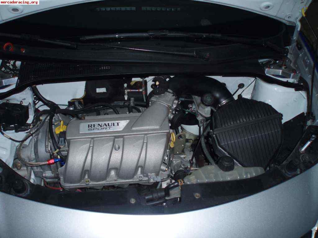

I don't think those are the same airbox in the 197 and R3 rally car, those ones look a fair bit smaller.

From what I can find on 197 net and also a few old posts here it seems to be the same box. Possibly angled slightly differently on mine so it fits- that's why we see a different side.

Some other pics I found:
