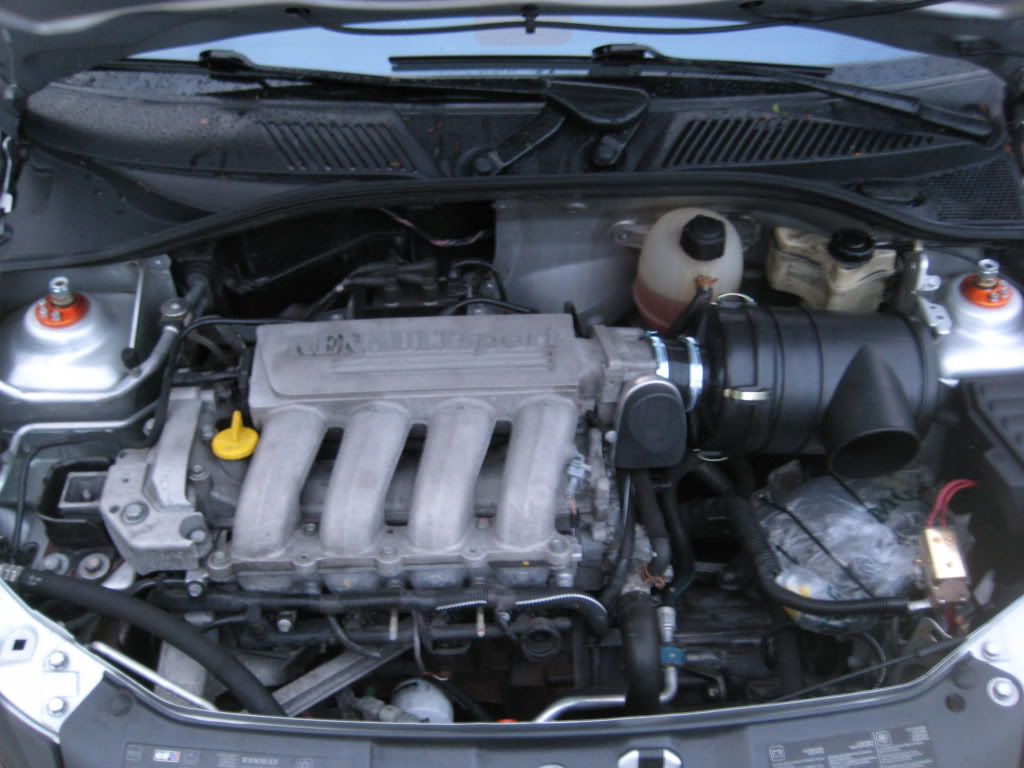

This was my old air box set up.
Sounded amazing too when the CAF wasnt on :)

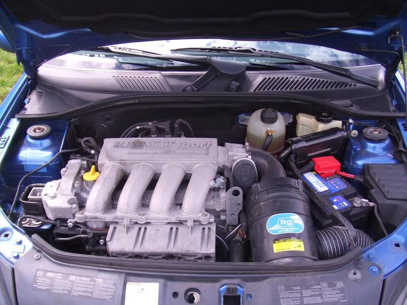

V6 air box and ITG filter

Interesting that you stuck it straight out from the tb, all the other pics ive seen have had the V6 box on a 45 or 90 degree pipe. Is it a tight fit that way? Where did you put the caf, where the original one was?
Moving the battery is the biggest pain rather than anything else I would have thought :) Thats why most are just on a 90 degree bend..like mine until I get a redtop in the summer.
