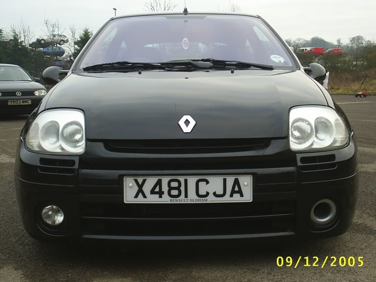

piccy. :)
i cant remember the dia. but the lamp comes out with 2 screws so its easy enough to measure. i got the bit of kit from ebay
weird thing the rear fog on the same side packed up when the front was disconnected must be linked, i'm not bothered you only need one for MOT and i don't use 'em anyway
I have 2 cold air feeds:rasp:
Hill Power Induction Kit is supplied with 2 x 65mm CAF's. I routed one to the front lower grill and the other down the side of the gearbox to the wheel arch liner.
The feeds go into the side vent in the air filter housing on the right. The one visible goes to the front lower grill, the other is underneath that one.
I tried to fit 2 but the left front one is too hard to route and at the moment goes no where near the filter. Just didn't want them to look uneven
