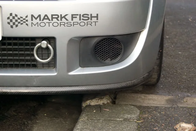

Hi Mike,
I have cold air feed via the fog light's. It was done when I brought the car, will take some pic's and add then later this week to give you some ideas.
John
Loads of people have done this. I have - not too difficult, but it will require you to remove the carbon canister and reposition the horns.
I just bought a load of CAF piping from Merlin, then cut it to length and taped it to the actual fog surround itself.
Do a search, been covered loads :)
