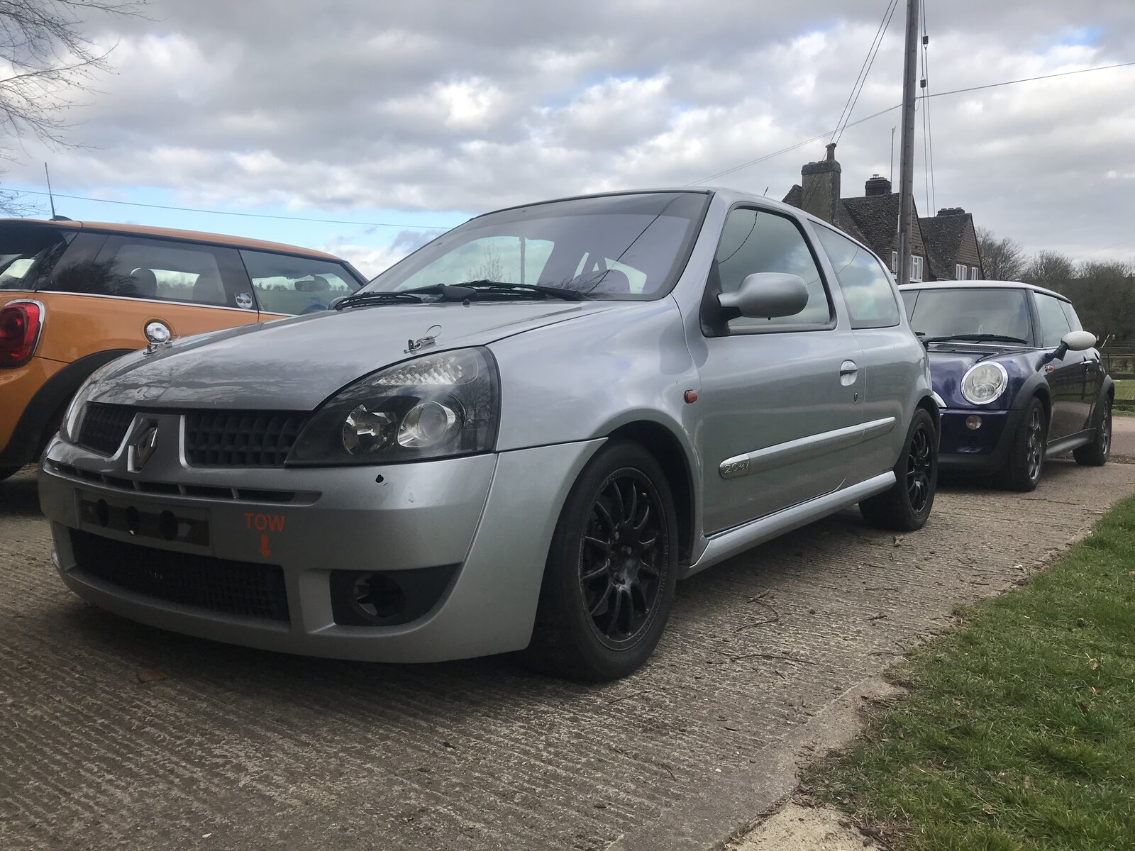

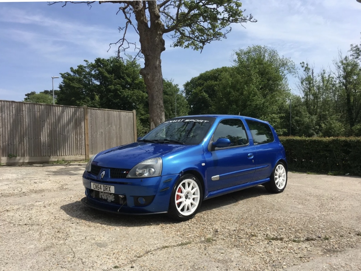

So back in December having just sold my hawkeye Impreza wrx situation allowed me to get another little Clio. I was going to have to use it daily for a few months while my mrs used my F56 Cooper S. I found this car in rugby, 143,000 miles Bilstein B14’s, ktec induction abs exhaust fitted, £1300. For mileage it wasn’t in bad nick at all.
colesy
  172 182 197 E61 530D
So fast forward 3 months no longer needed as a daily things are going to get interesting. In the time I’d been using it daily I’d fitted a sparco seat on extra low frame and fitted a ktec bolt in cage.

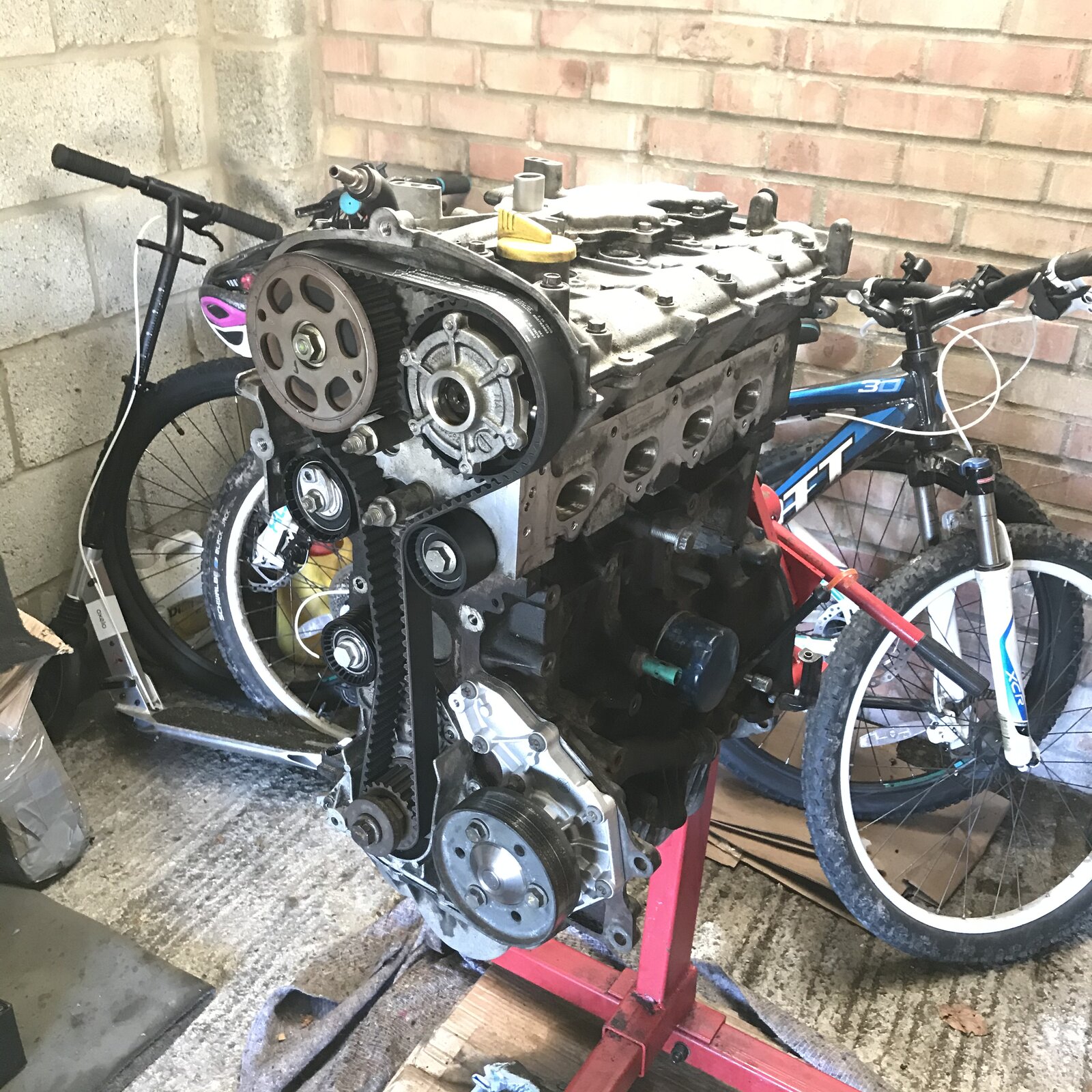

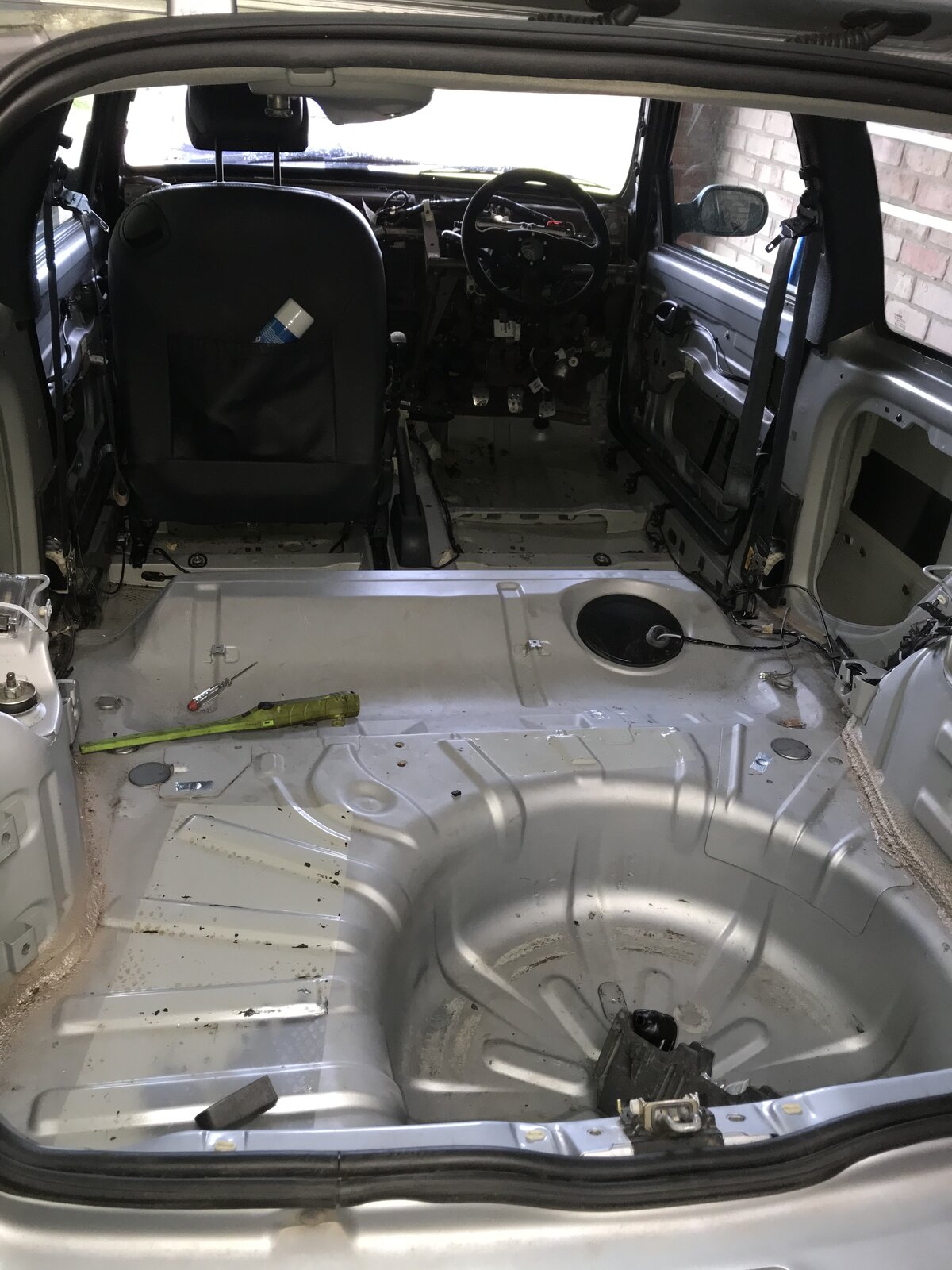

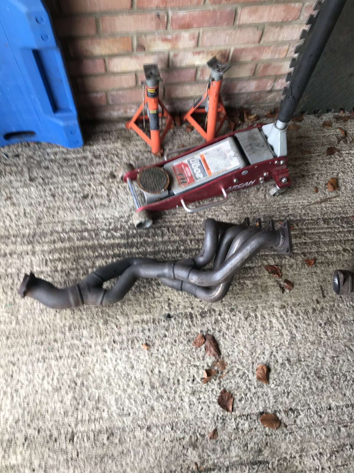

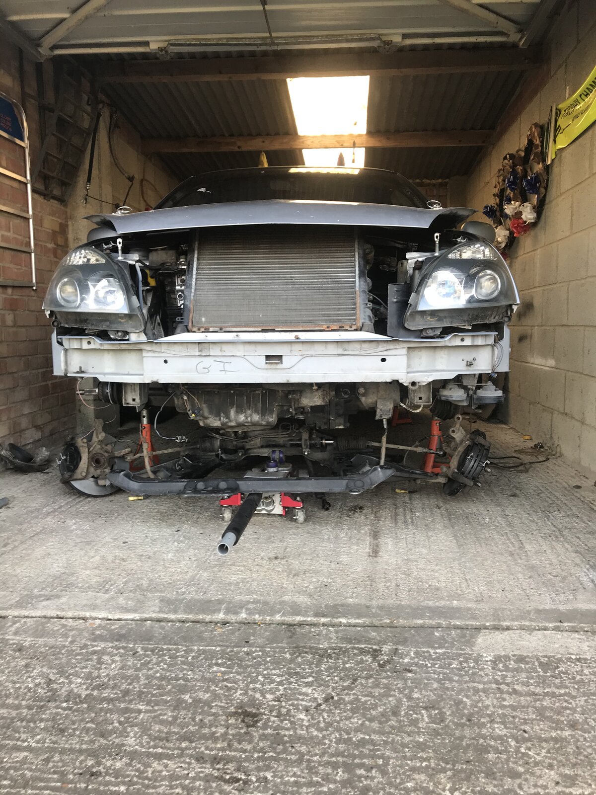

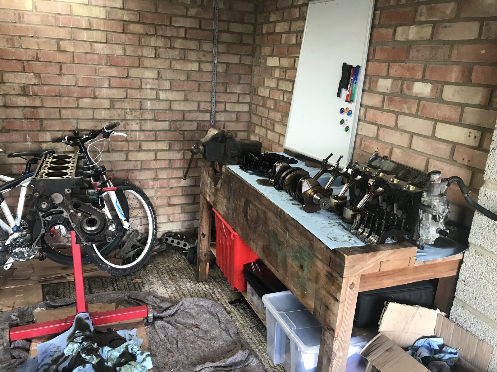

At the beginning of March I took the engine out the old girl to do the belt, fit a clutch and generally tidy up the bay and engine loom as it had been out before and not refitted properly. At this time I decided as it was going to be going on track this year to strip the engine too to check the wear of everything and replace as necessary. Surprisingly it all looked good so I rebuild it as is. I will build a ‘proper’ engine for it at some point. I also decided to do group n timing thanks to @1985micheal182 for lending me the tool.
colesy

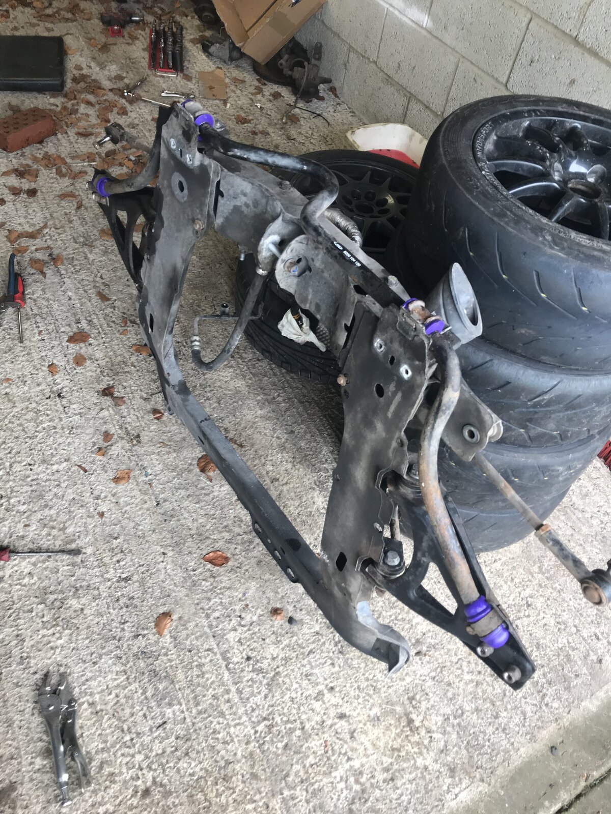

As it was all out I also Polybushed the subframe, black series bushes in the lower arms and purple series rest. I’ve also renewed the engine mounts with added powerflex insert for now although in time I’m sure these will be replaced too. Also taken the opportunity to upgrade to a 182 manifold.
Have also got some TD 1.2s, these will get refurbed in time but not a priority at the moment. I fitted a pms stud/nut conversion kit.

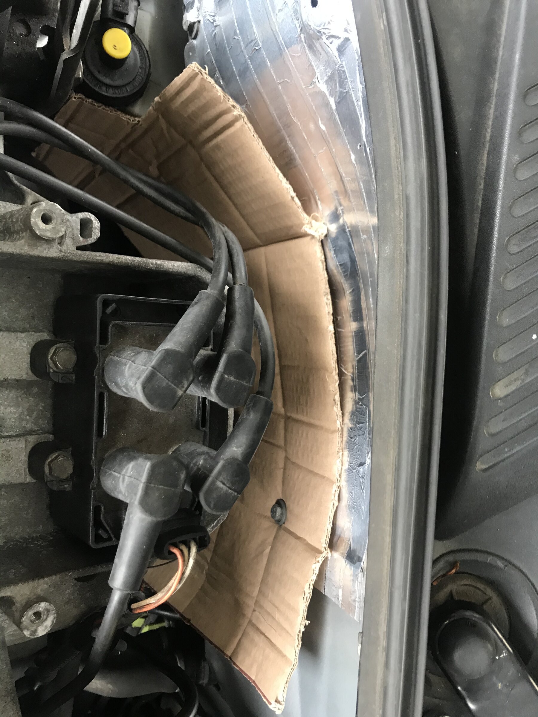

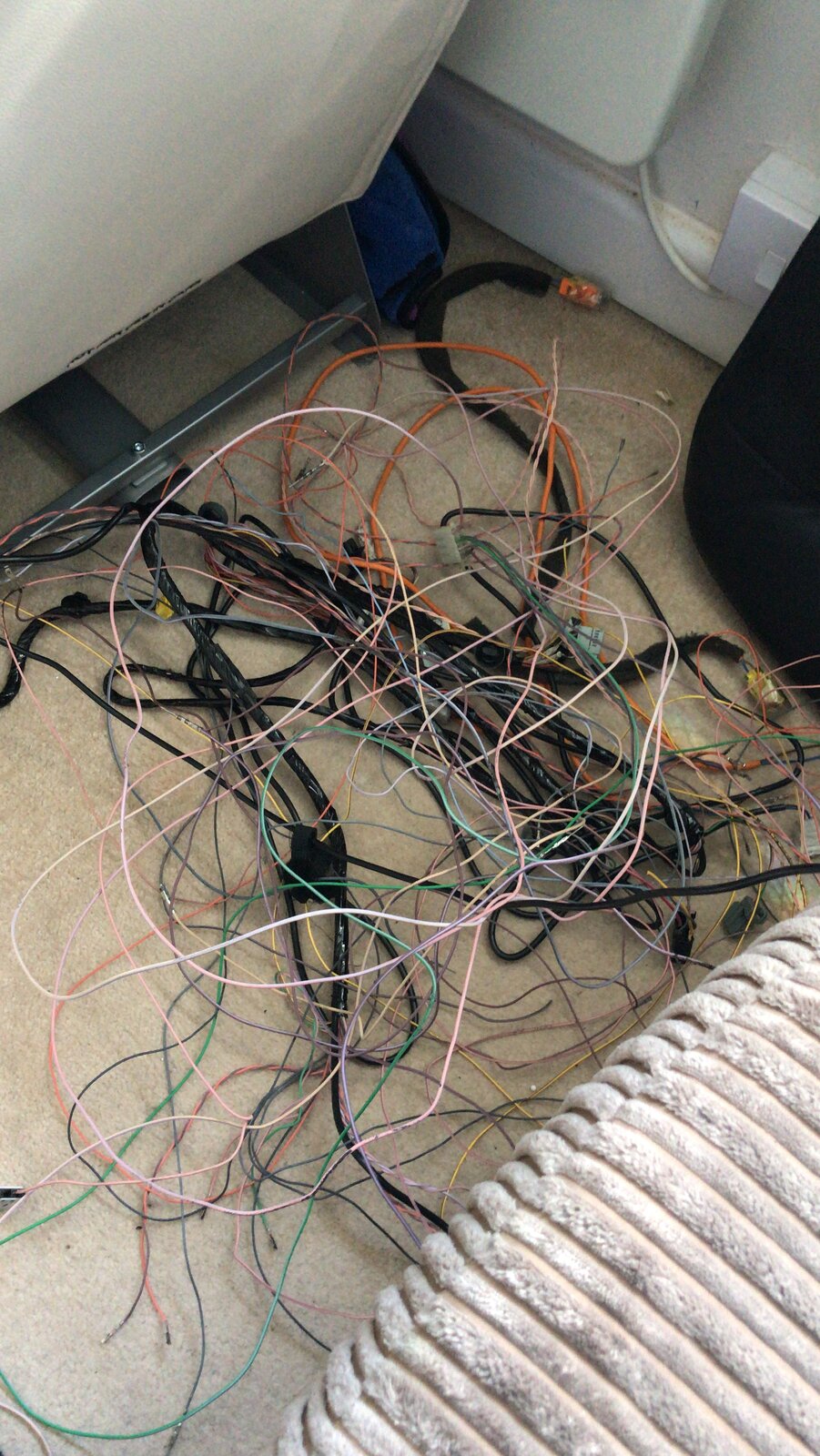

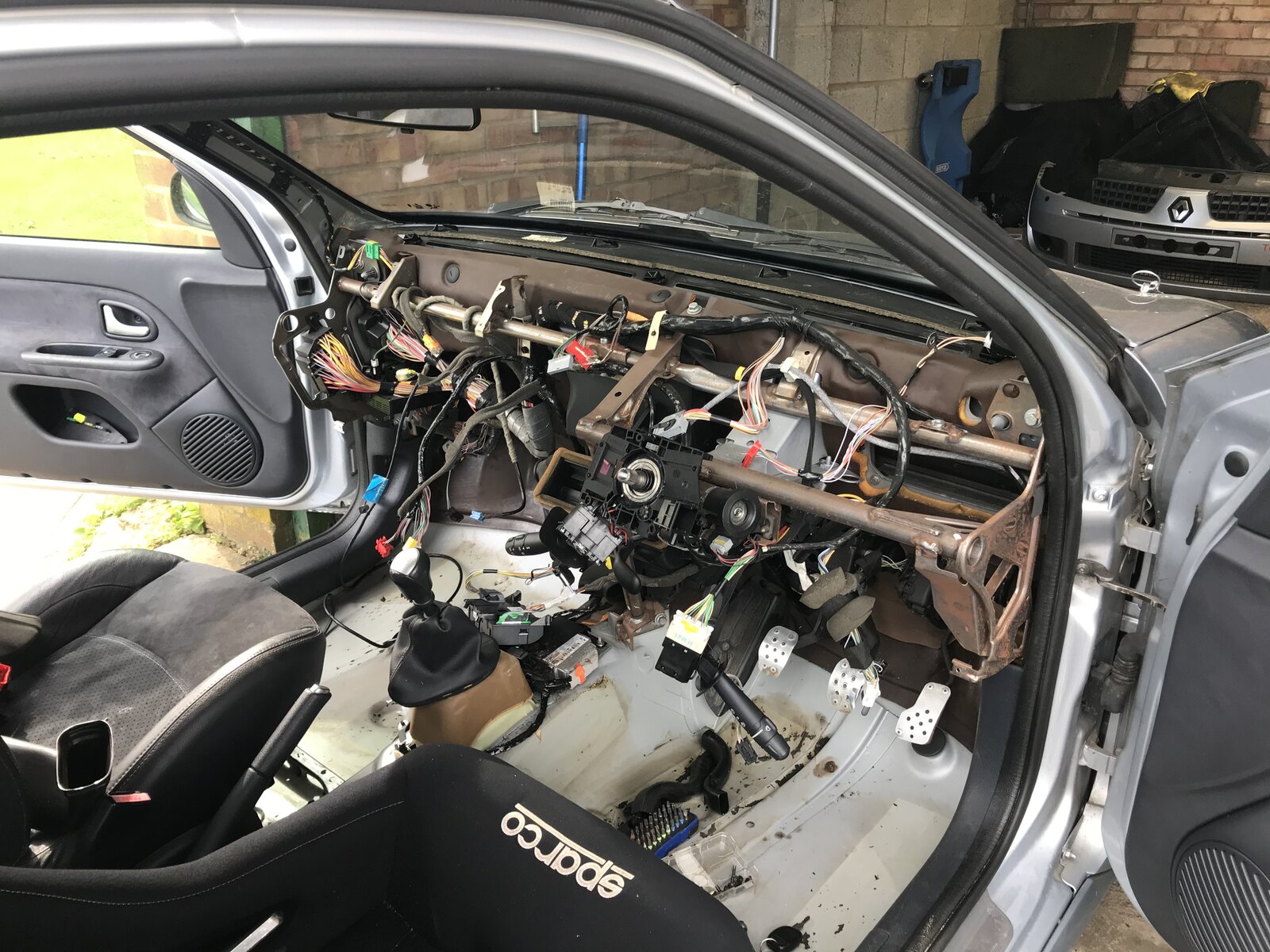

And that brings it up to date. Yesterday I’ve removed the dash to trim back the body loom of unneeded plugs. I have also bought an EPAS setup and cup alternator setup and full strip out has begun. I plan to get a full cage fitted even if I only do track days, hate being on track without a cage.

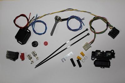

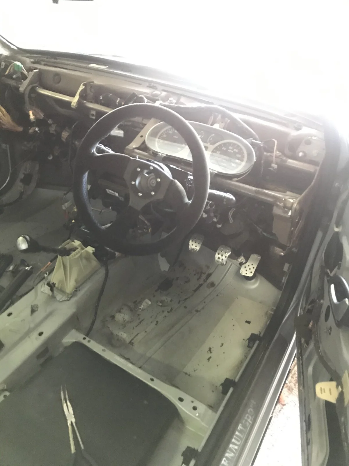

Bit of progress today, the EPAS kit I bought turned up 😊
so I immediately got cracking (furloughed life) got the subframe off with the rack I know could’ve probably removed the pipes without taking the subframe all the way off but I really couldn’t be bothered to struggle. Rack blanks and link pipe from BRT motorsport should be here tomorrow. How much fluid shall I put in the rack?
Then I got the column swapped over today, now I just need to wait for the adjuster to arrive from Portugal so I can get it wired in.
Hopefully my new cup alternator setup will arrive tomorrow so I can get that fitted.

So a quick update today, removed the unnecessary wiring from the body loom. Airbag and radio wiring removed and plugs/wiring removed that were in the loom but not spec’d with. Worth it
just to make the loom look tidier even though it’ll be behind the dash.

So not much of an update recently. I have hopefully bought a full sparco bolt in cage for the princely sum of £300 and it’s FIA approved so could in theory be used for racing (not that I’m going too) will be fine for track days though. A good friend of mine is going to weld in the spreader plates for me in the next couple of months.
wiring loom is back in and it still runs 👍🏻 Dash is still out but will stay out until the cage is fitted. EPAS is also now all wired in and works, I’ve driven the car with it for about 200metres and initial impression is I really like it.

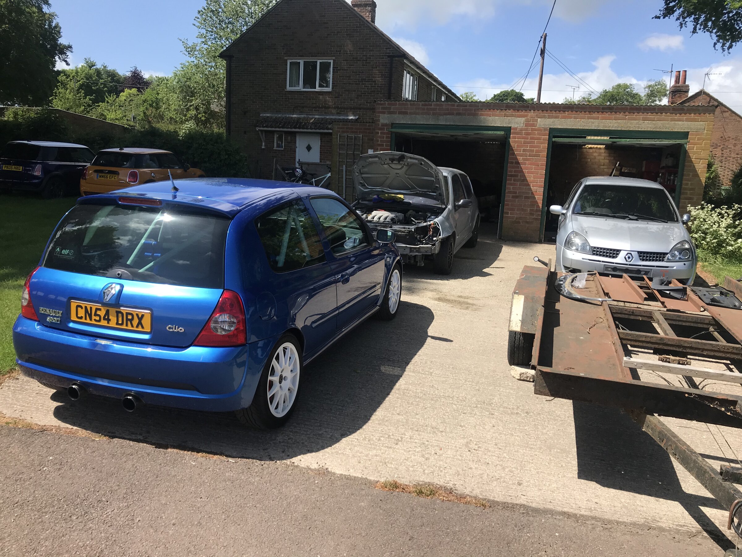

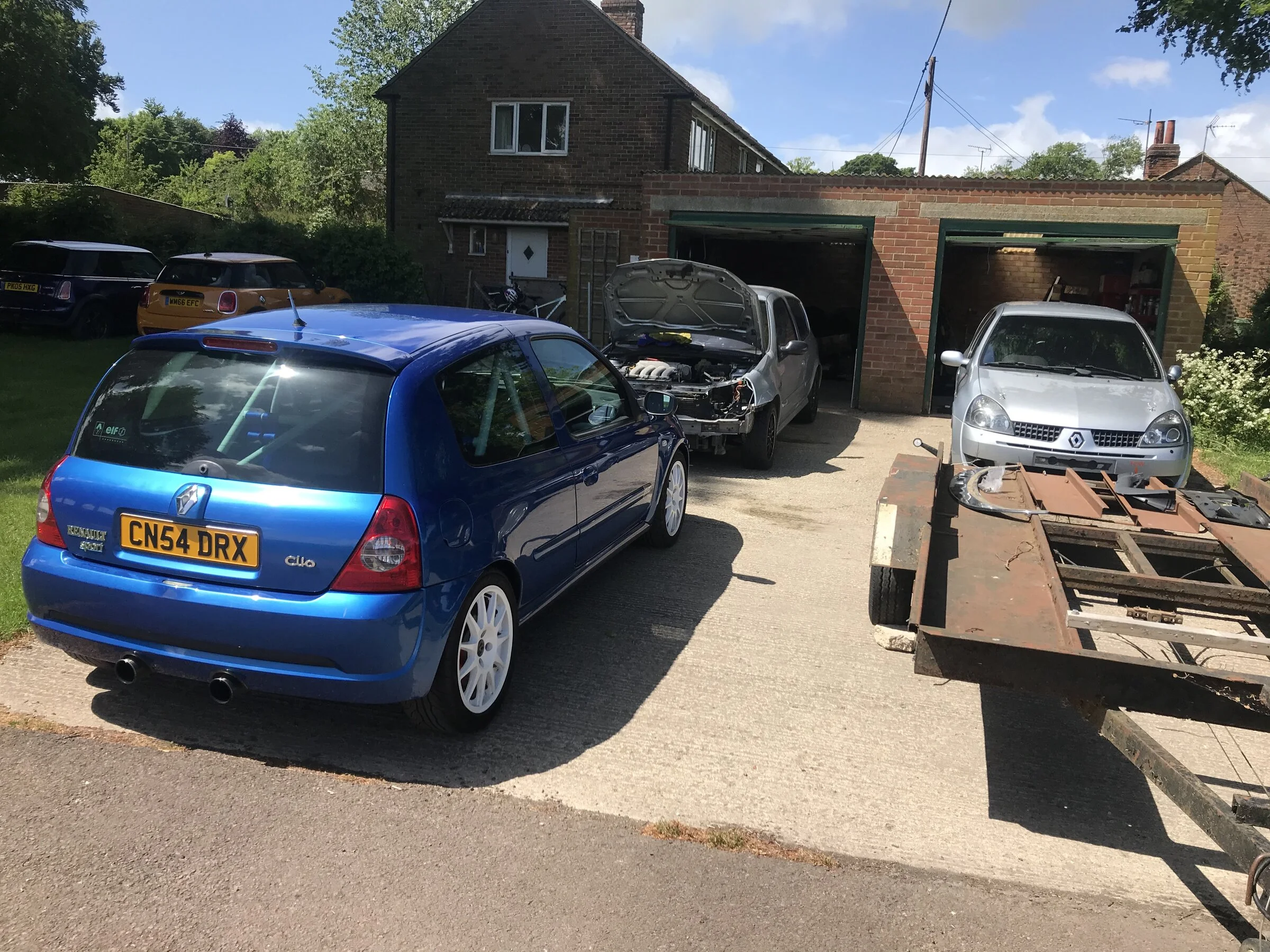

Today I’ve welcomed another Clio into the family. I think my dad was feeling left out so he’s bought a 182 turbo so we can go to track days together next year and have some fun. Looking forward to developing the cars side by side.
colesy
Not a lot has happened recently, now being back at work progress has slowed down massively.
As I mentioned above my dad bought a 182 turbo which he has now taken delivery of. It does make some cool noises but I think I’d miss the scream of an N/a engine. (Plus when he’s bored of it I’ll most likely buy it off him anyway)
The plan with it is to make bearable for him to drive on the road but also do an occasional track day in. (He’s 64 so I think he’s doing well just owning one 🤣)
We’ve now got a trailer too for when we do track days and I eventually race mine. We bought a third 172 that came with the trailer and lots of tasty bits that we’ve either sold on or kept for our cars. I’ve now got some solid engine mounts, forge coolant hoses, white line rear arb and headlight Blanks for mine. Got a full cage coming for my car too which will get me on track but eventually will be upgraded to a fulcrum one most likely.
And that’s it really, bit of a ramble from me. Oh I still need to get to EFI and get it mapped for the group n timing too so we’ll see how that goes. Would be ideal if they did some sort of remote mapping just to allow a base map on it so I Can drive it and make sure it’s all okay before going up to Chester.
If you’ve made it this far well done
Got rid of this now so I’ve got some space again. (The wheels stayed though!)

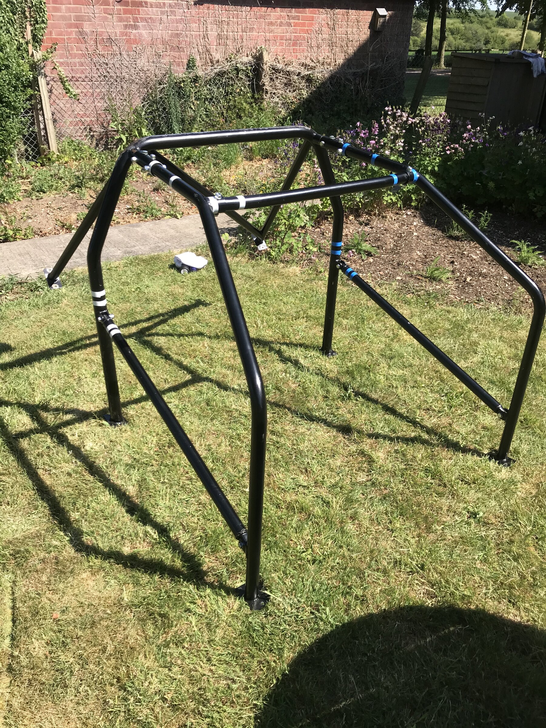

And EFi is booked for mapping in July! I’ve now got the sparco cage to fit, and some door cards to make/fit.
Then I just need to get some track tyres (Dunlop 03G direzzas) and it’ll be ready the first trackday.
I haven’t managed to get the inlets matched but I’ll sort that out next year when I race the thing and get a map tweak at EFI.
Some pics of the cage waiting to go in:

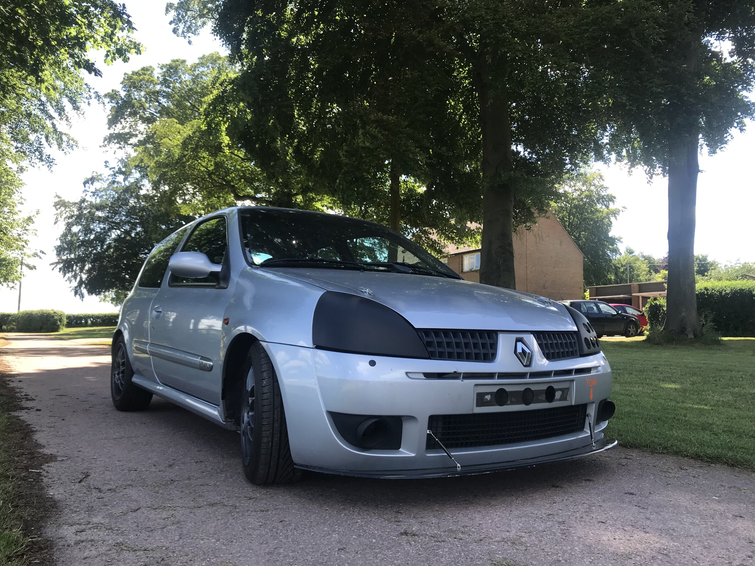

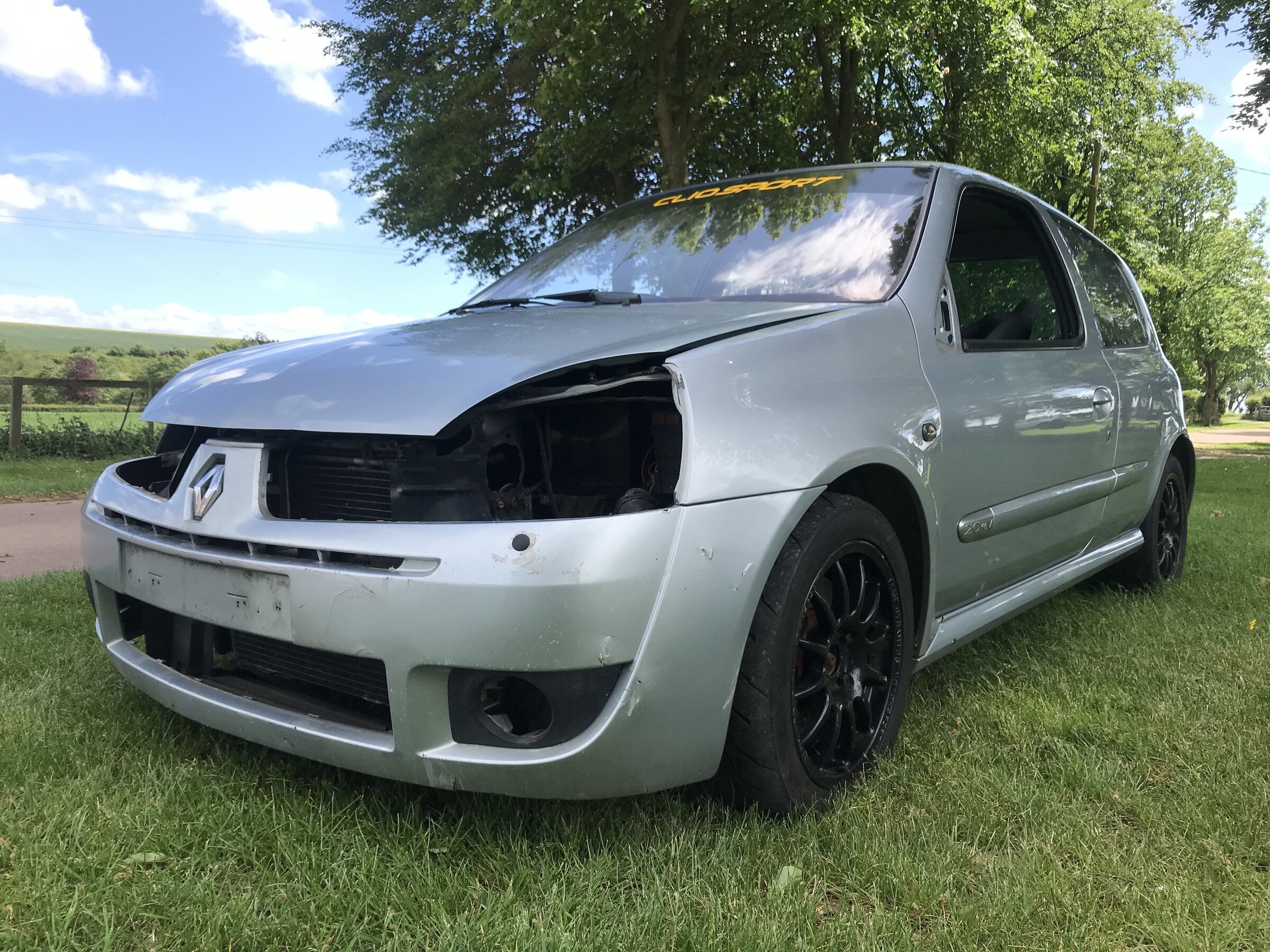

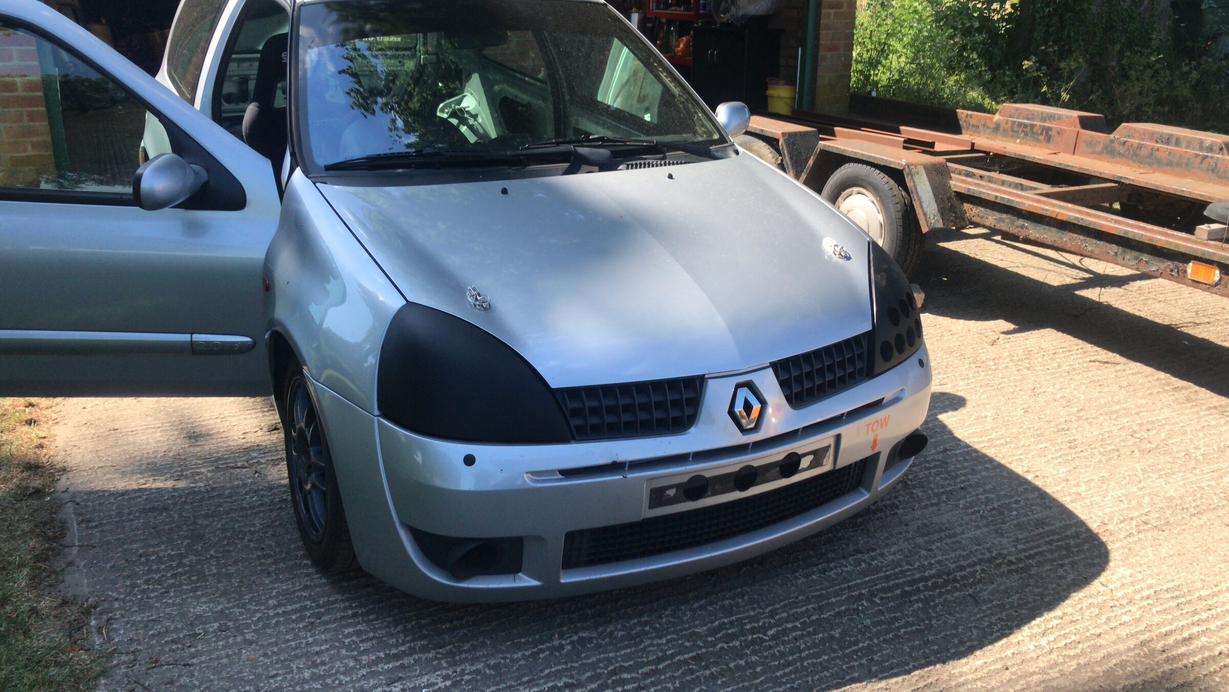

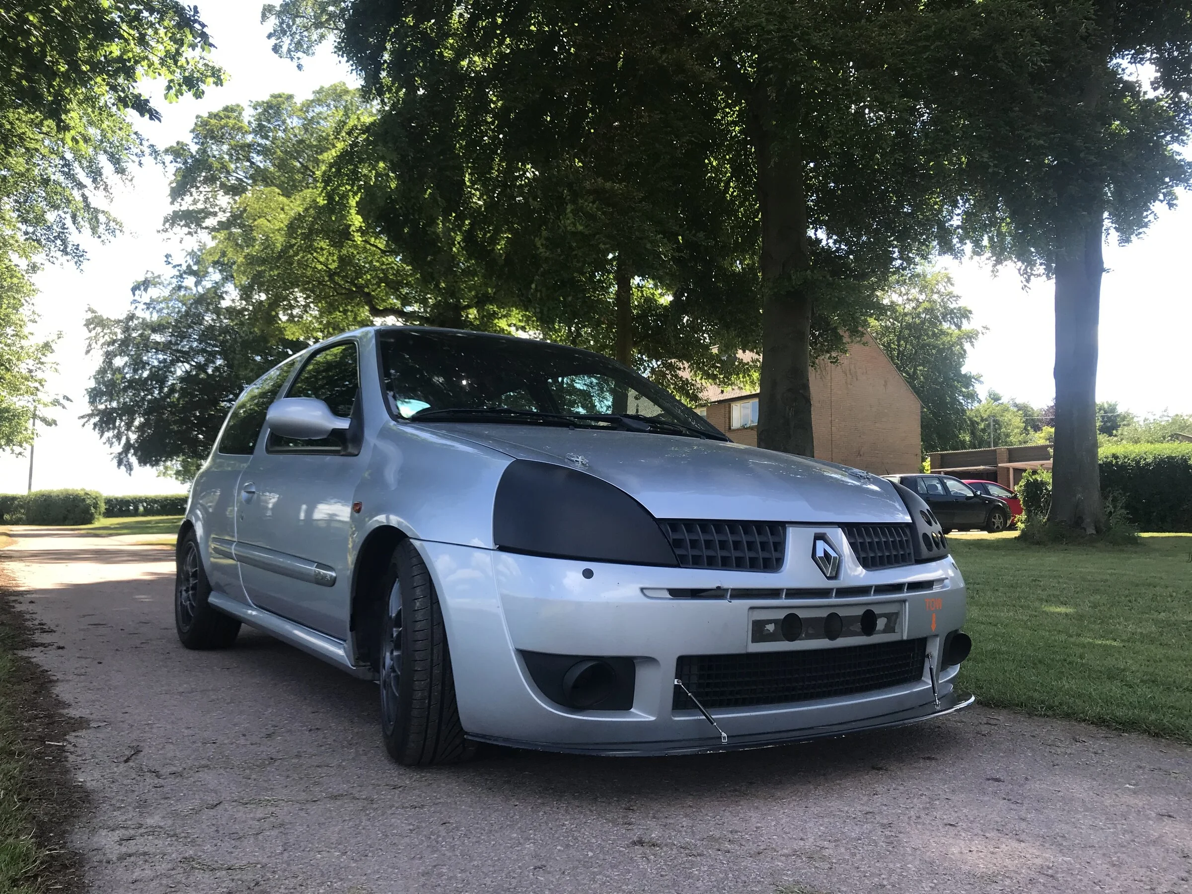

I’ve also re routed the body loom and I’ve now got the race car look with headlight blanks!
colesy

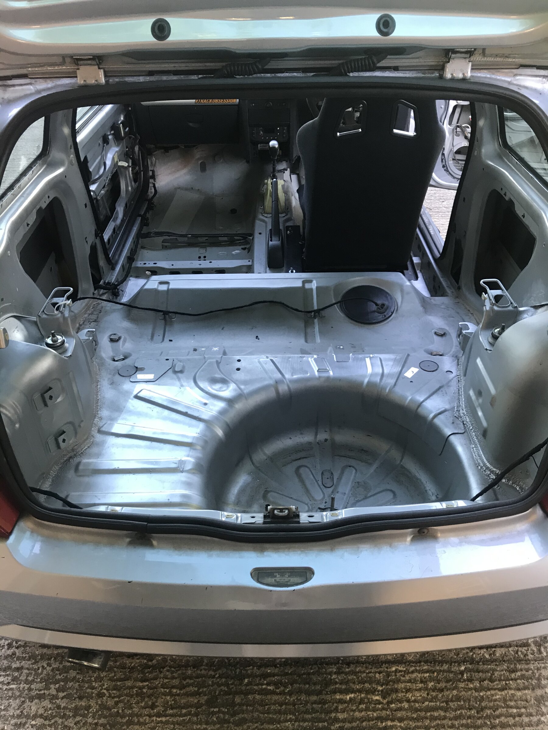

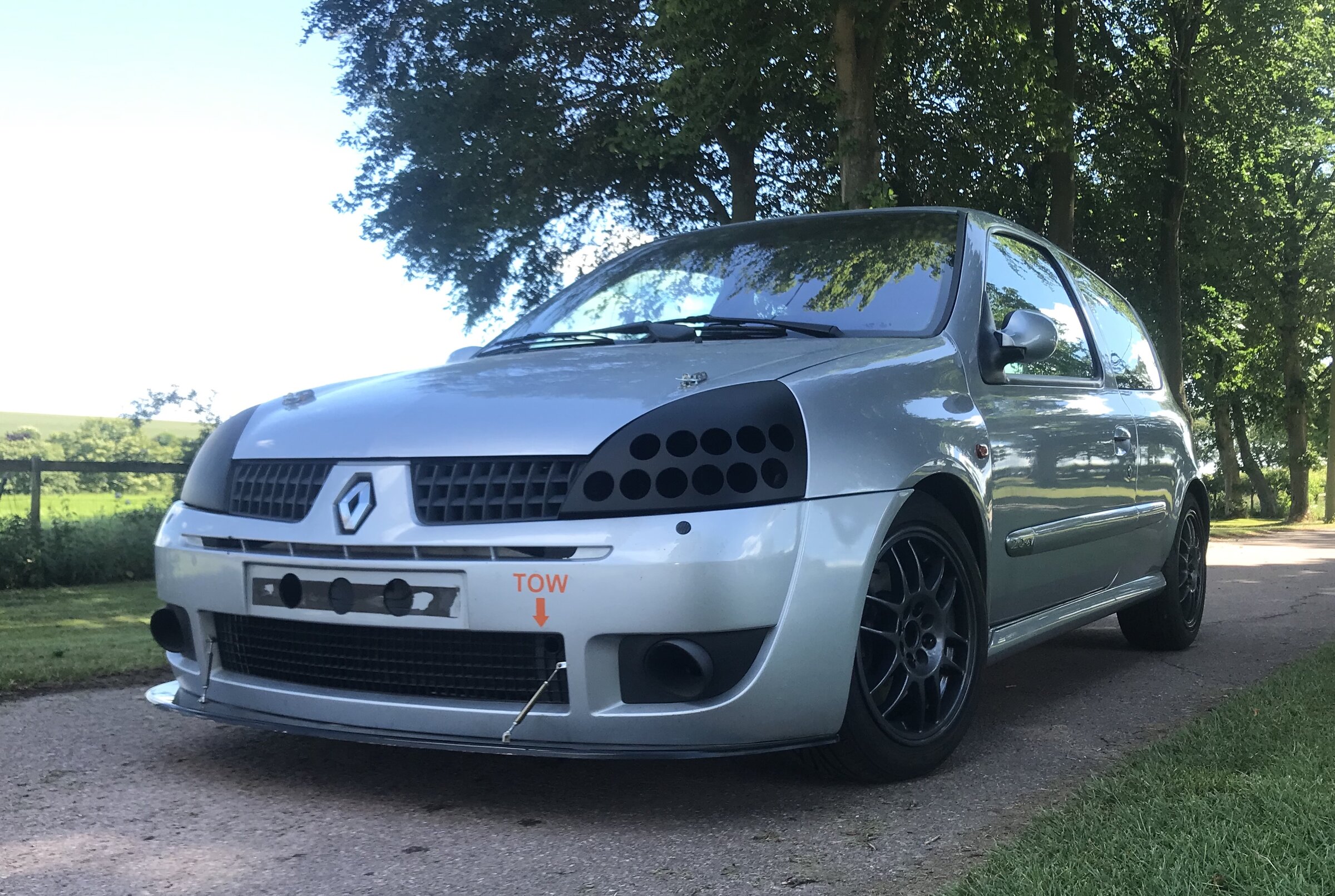

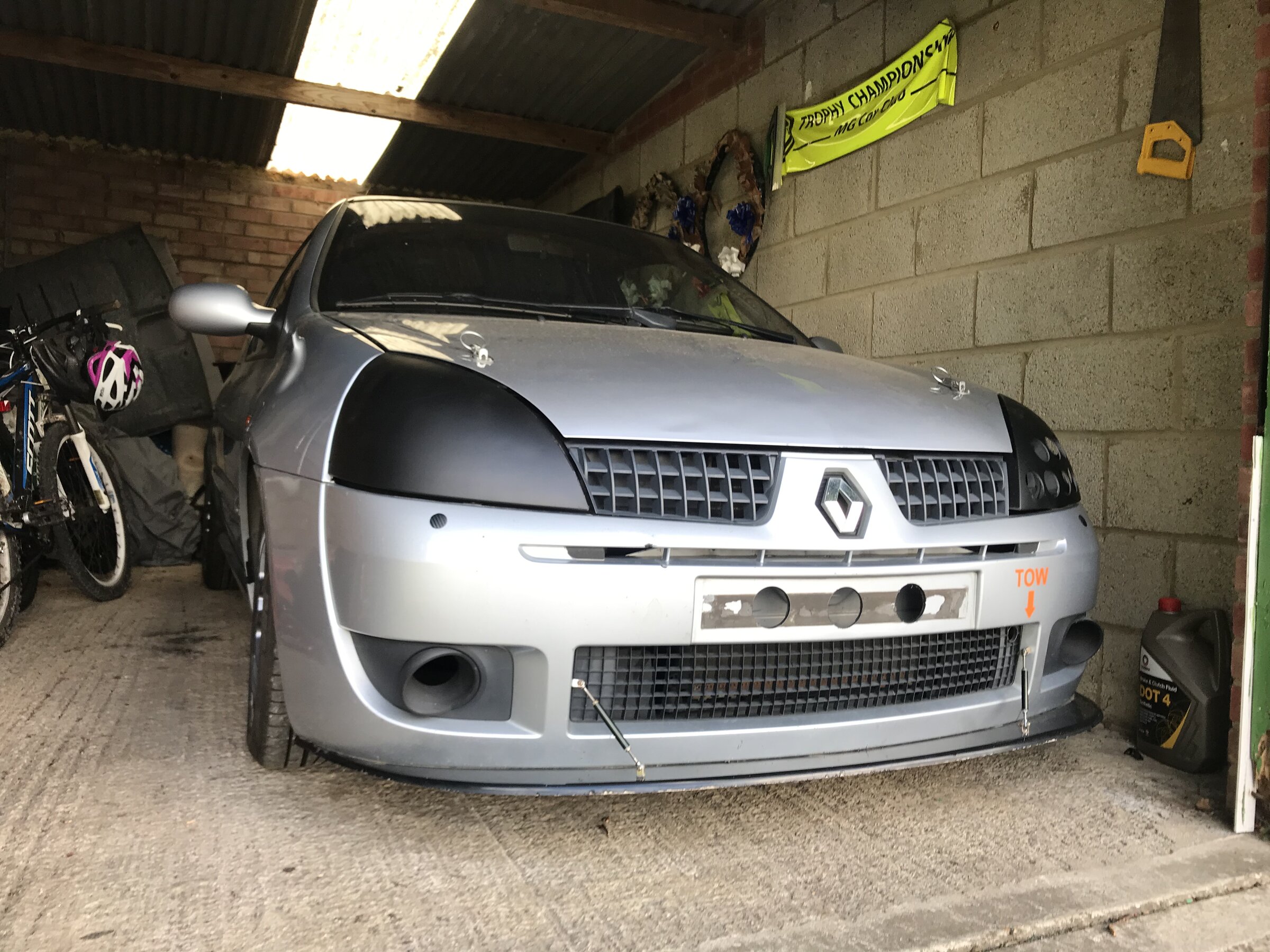

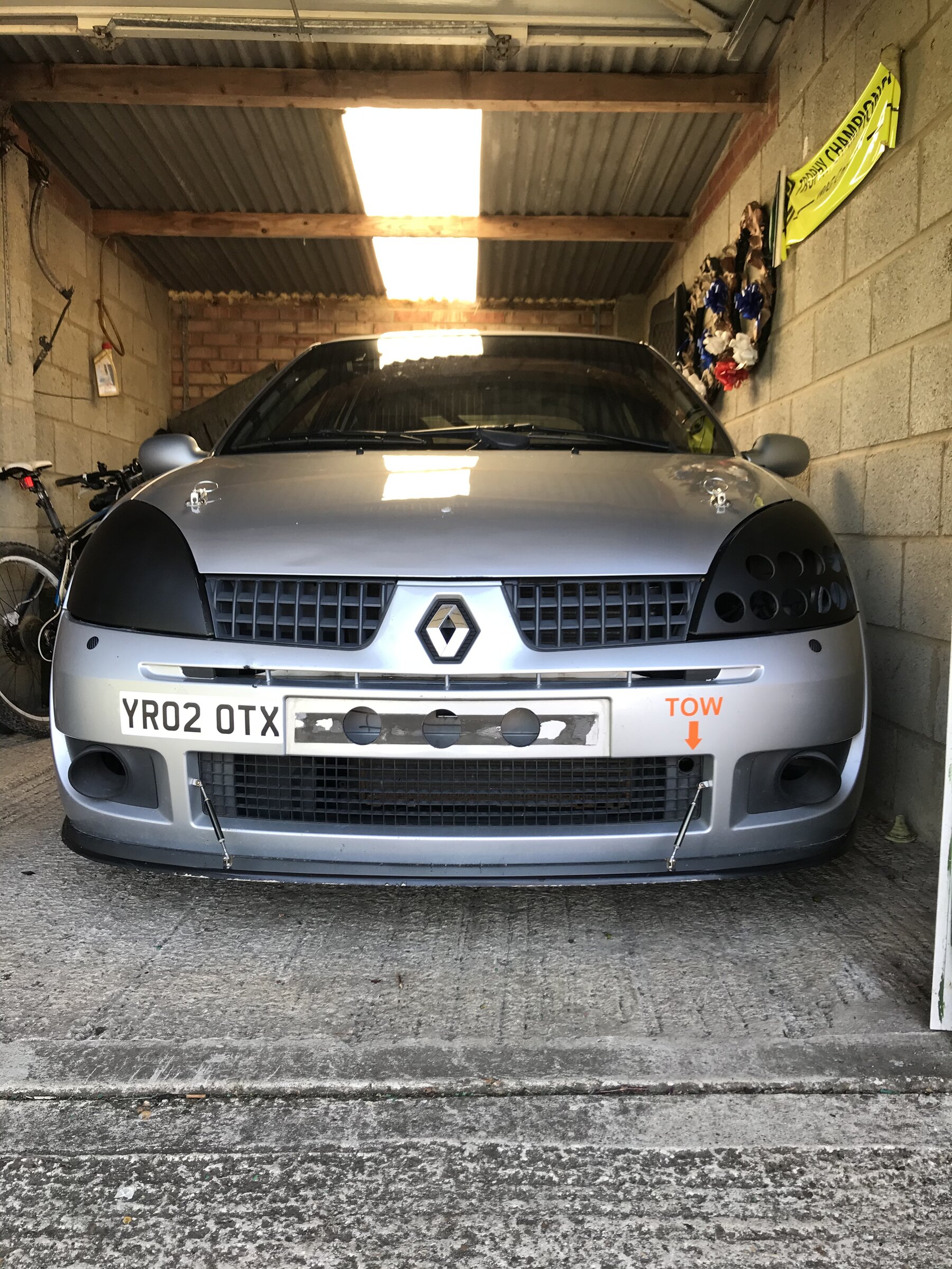

Another small update today. Sorted out the niggly bits I need to get sorted before mapping, getting the exhaust clamps on properly and sorting some heat shielding out. Made a cardboard template for when the nimbus arrives and got a heat resistant sheathing for the starter cable that runs under the manifold.
I shall give her an oil change before mapping then it’ll be the wait to get her on the dyno at EFI!
Also fitted a splitter today to it, it came off the 182 but I quite like it on mine now.... whether it stays we shall see.

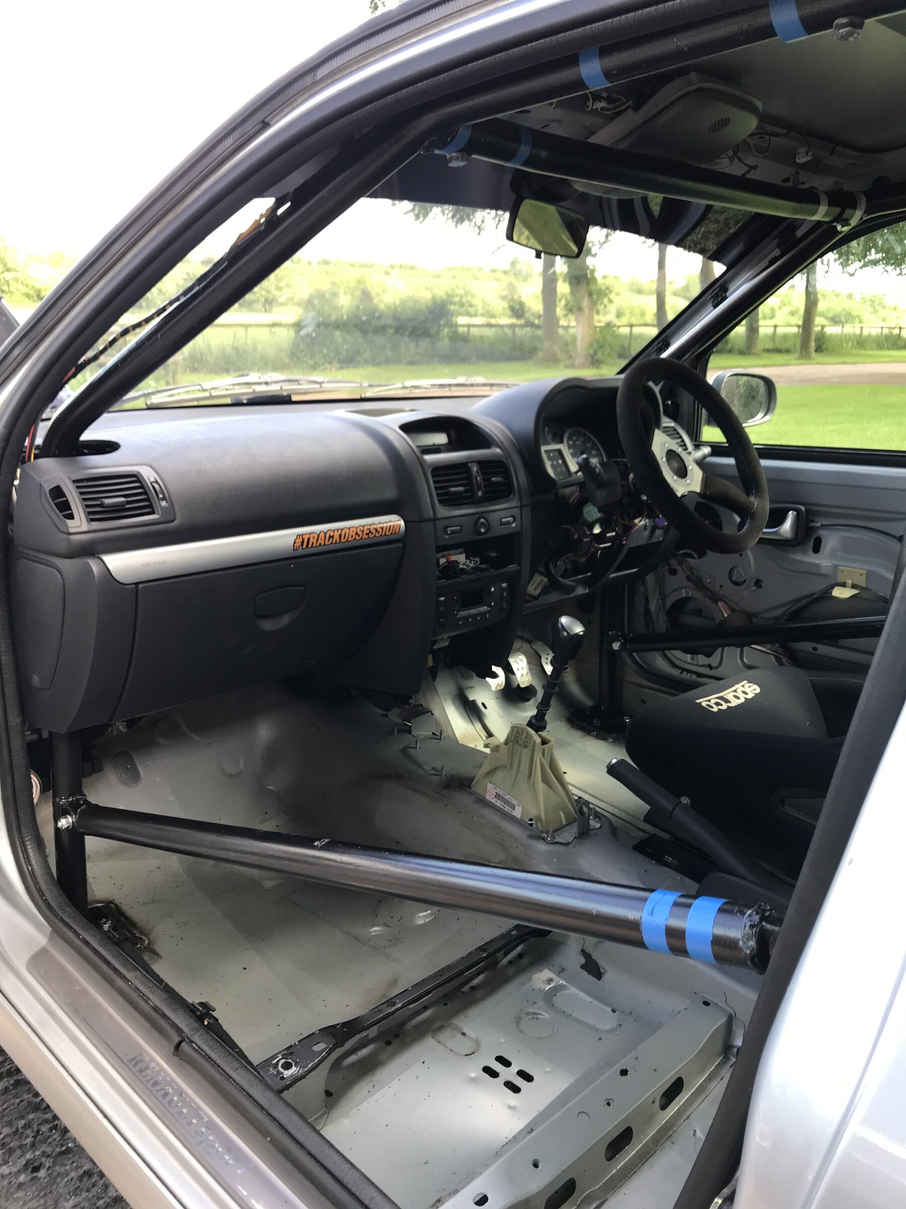

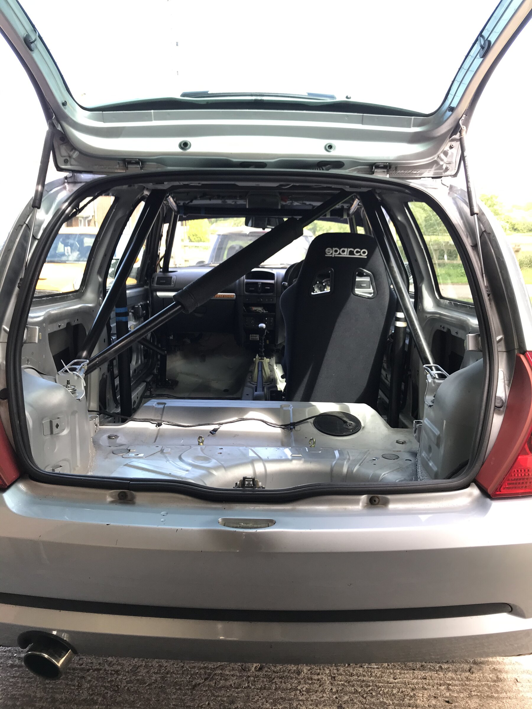

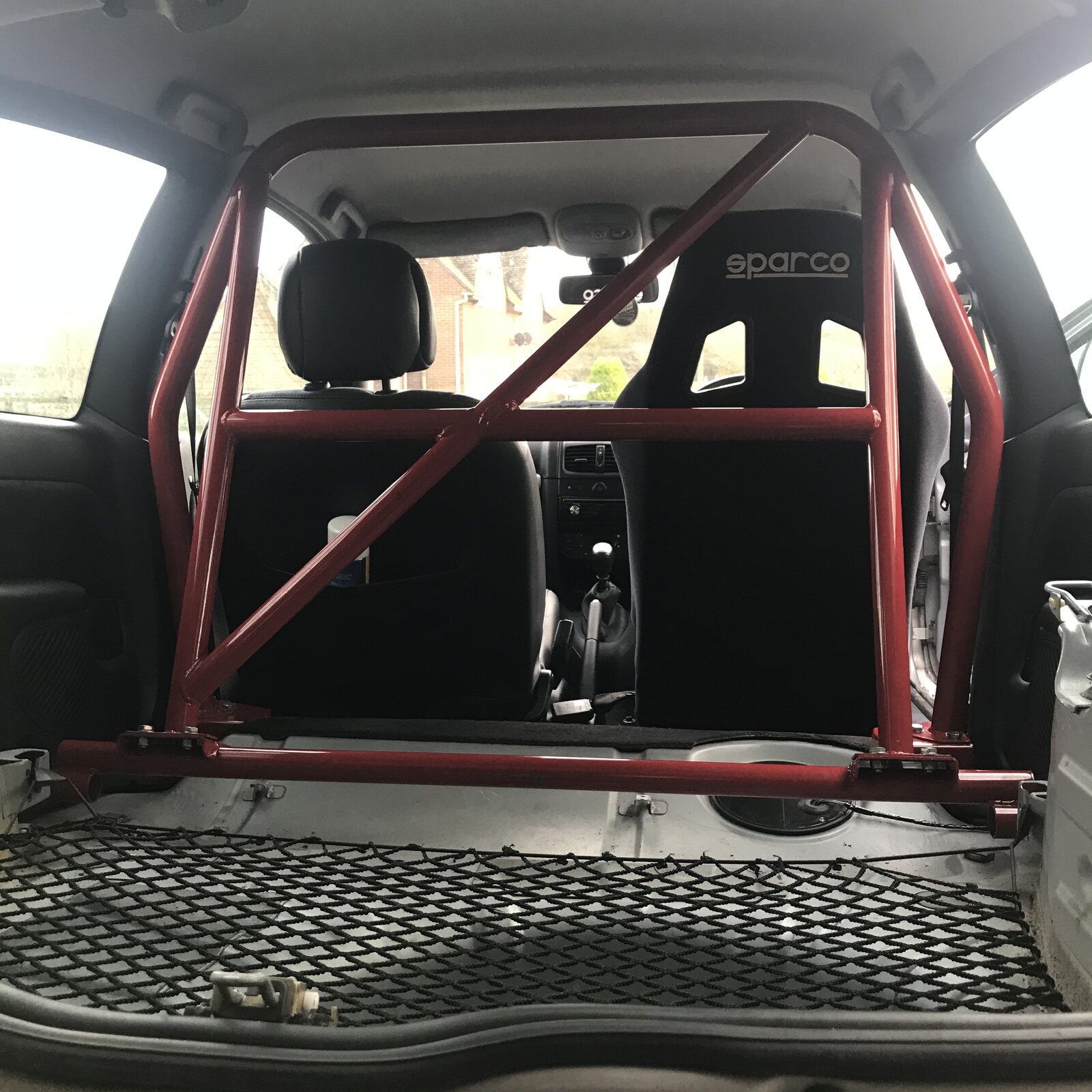

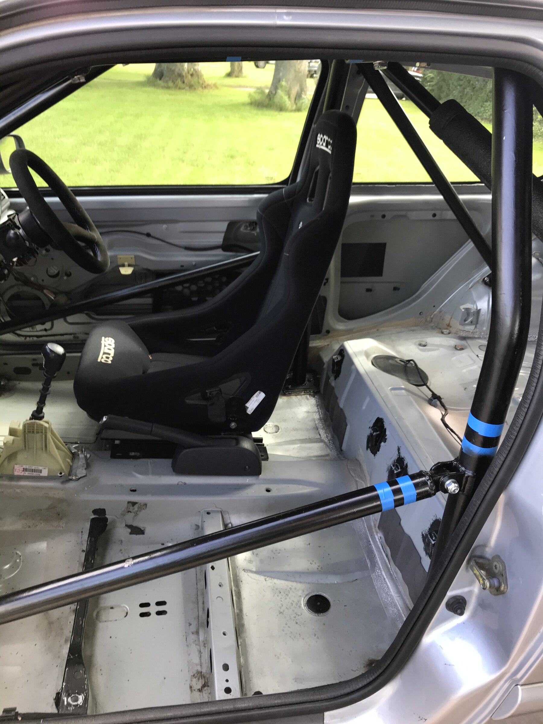

Got the cage fitted and completed. Got a good mate of mine to weld in the spreader plates so it’s done properly. (Unlike the guy I sold a full cage too who just bolted it through the floor!)
Happy that it’s in and done, oil change to go and she’s ready for mapping on the 15th July.

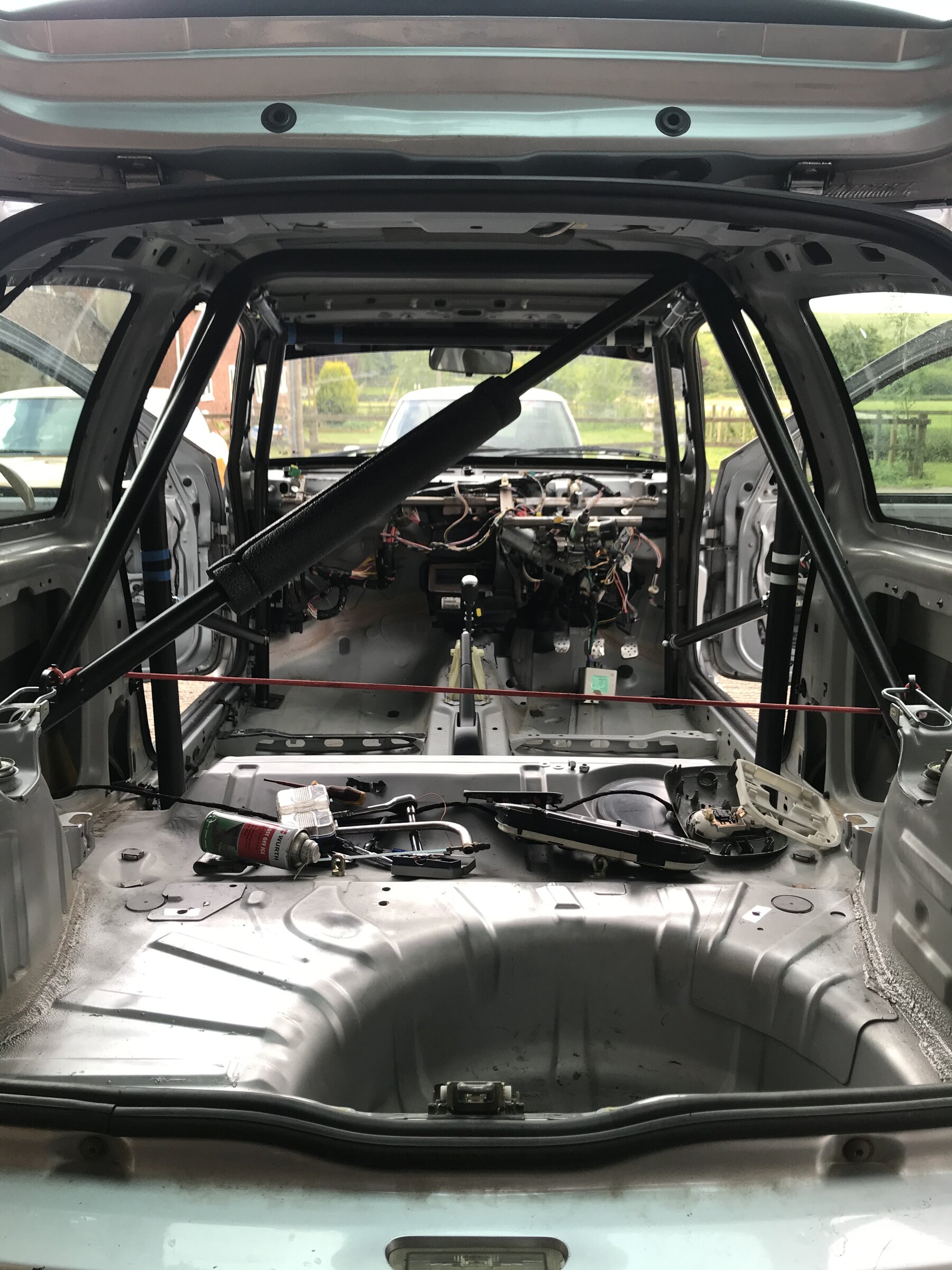

So a little update. Roll cage is now fitted and looking good. Need to get a harness bar welded into it soon but will worry about that another day.

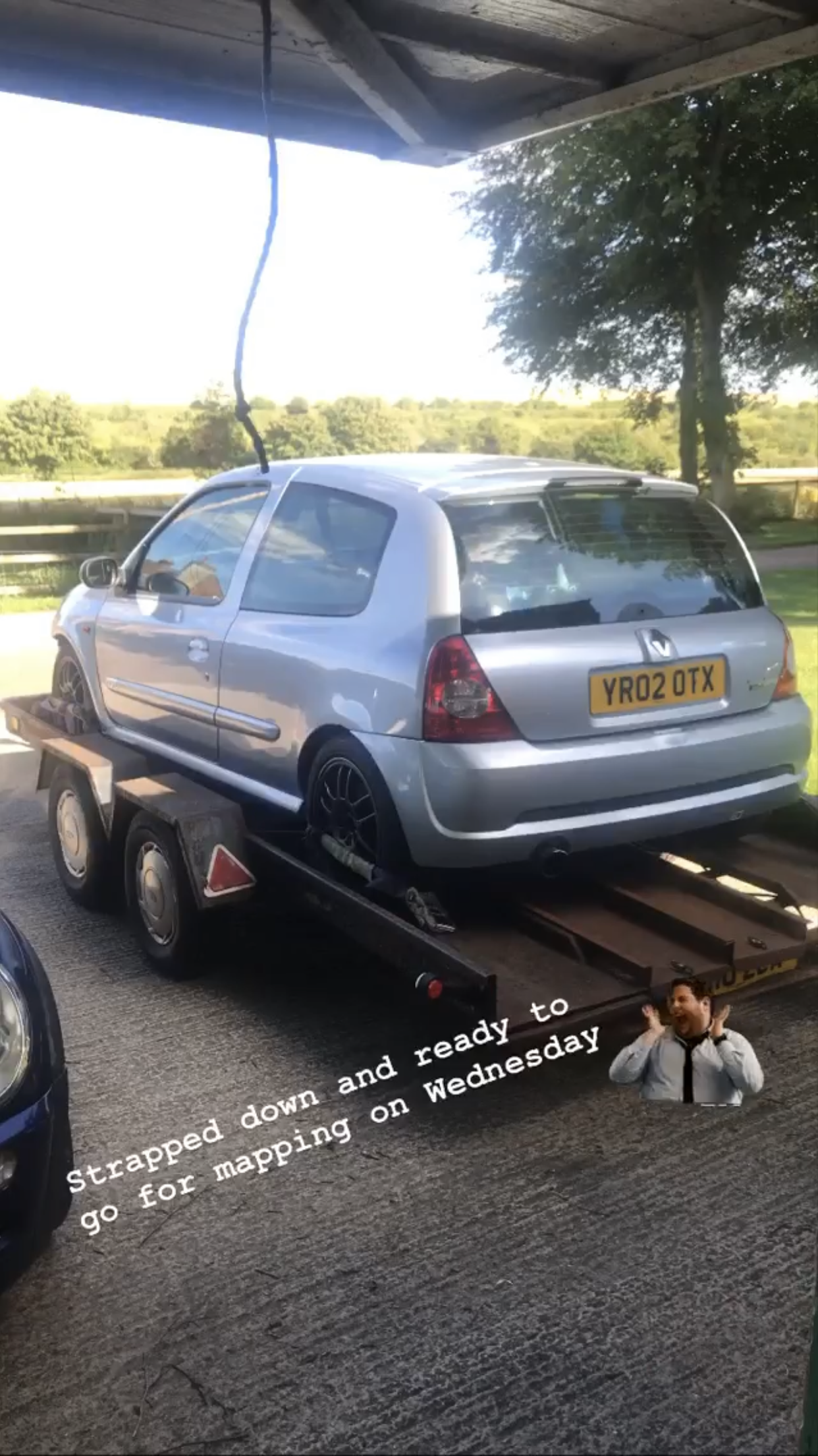

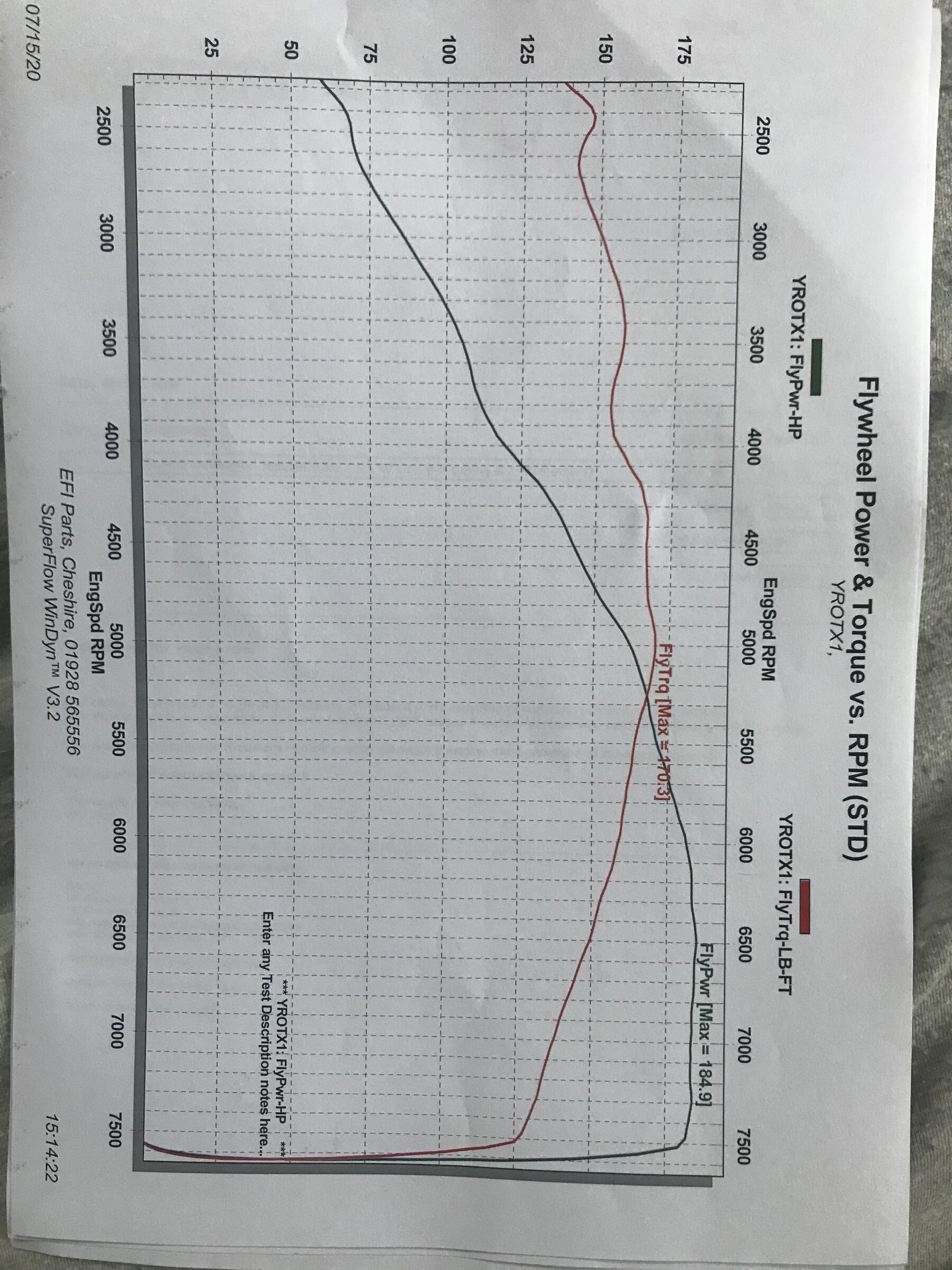

After what feels like an eternity it’s mapping day tomorrow!! Excited to see what she makes on EFI’s dyno, but drive ability is far more important than numbers (although we all like numbers!)
Will update tomorrow how it goes!
colesy
And the results are in, 185bhp (well 184.9😅) and 170lbft of torque!
Bit of a fraught day in the end though, Chris got a it on the rollers and it immediately cut out. Long story short the lambda sensor wiring melted and shorted on the exhaust. Not too much of an issue as he deleted the sensor out anyway so it’s not going to be used.
Then after that, it cut out again and wouldn’t restart with no power to the ecu, somehow the gearbox earth strap snapped and caused that issue.
thankfully after this it went relatively smoothly. Pretty happy with the power it made and I can’t wait to give a good blast!!
Chris was really great and I would recommend EFI to anyone who needs there car mapped!

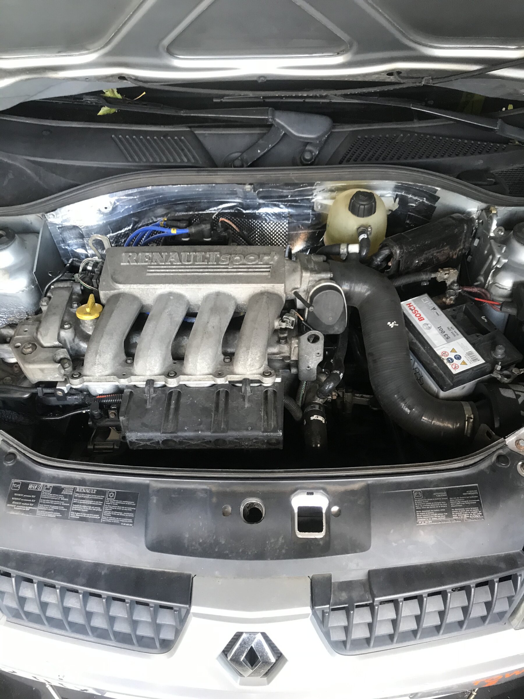

Finally after 3 months it’s oil leak free. After initially thinking it was the sealant filled main cap leaking it was actually the sump gasket. All sorted now though!

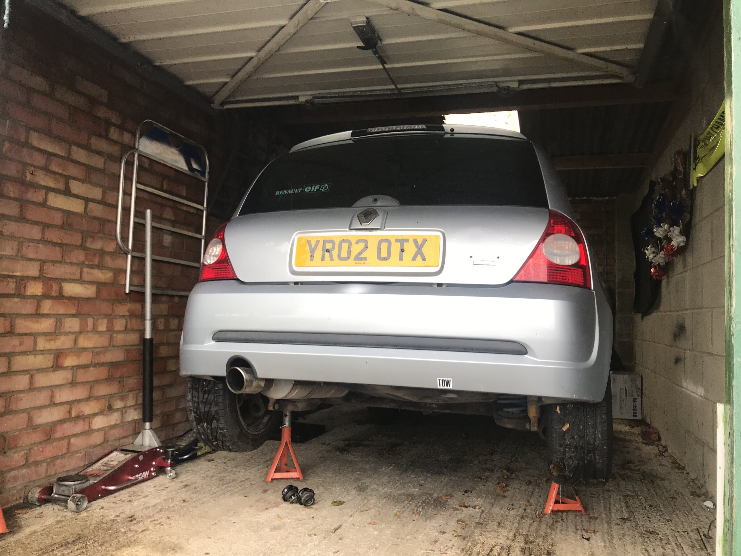

Now the engine side of things is sorted I can now start with the rear end. Got her in the air today ready for the rear beam to come off and have some new bushes fitted and whiteline arb. While I’m at it I shall also replace the brake lines across the beam and replace the little flexi sections with braided hoses. If I’m feeling really keen I may even give the beam a lick of hammerite.
