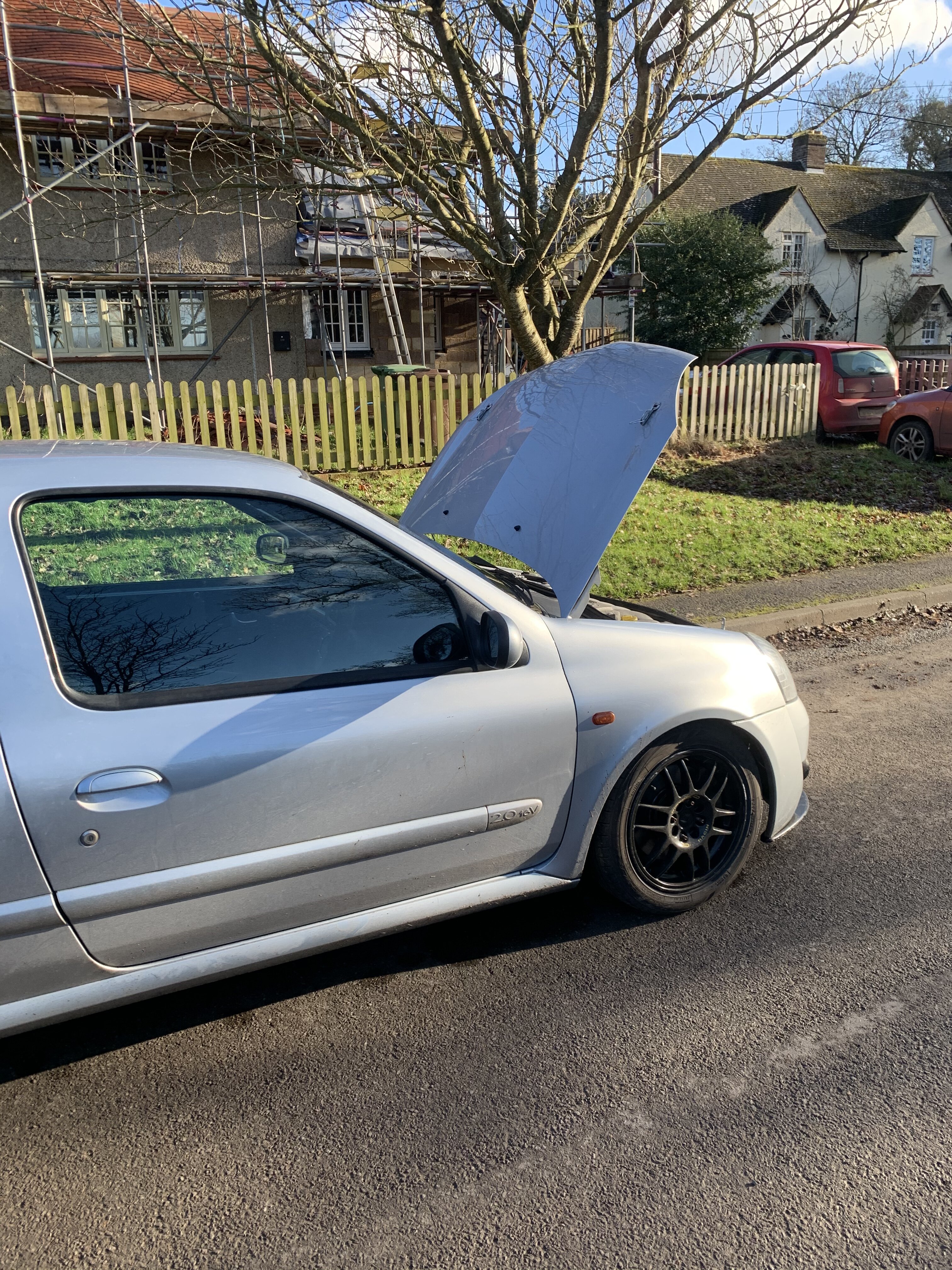

This happened today 😃😃

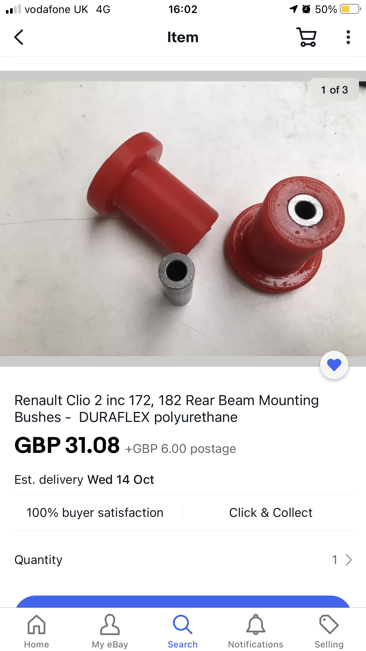

@colesy. Did you ever fit those duroflex rear beam bushes?

I haven’t no, still looking at them though as they seem good value! Yep I can’t wait been a long time coming lol

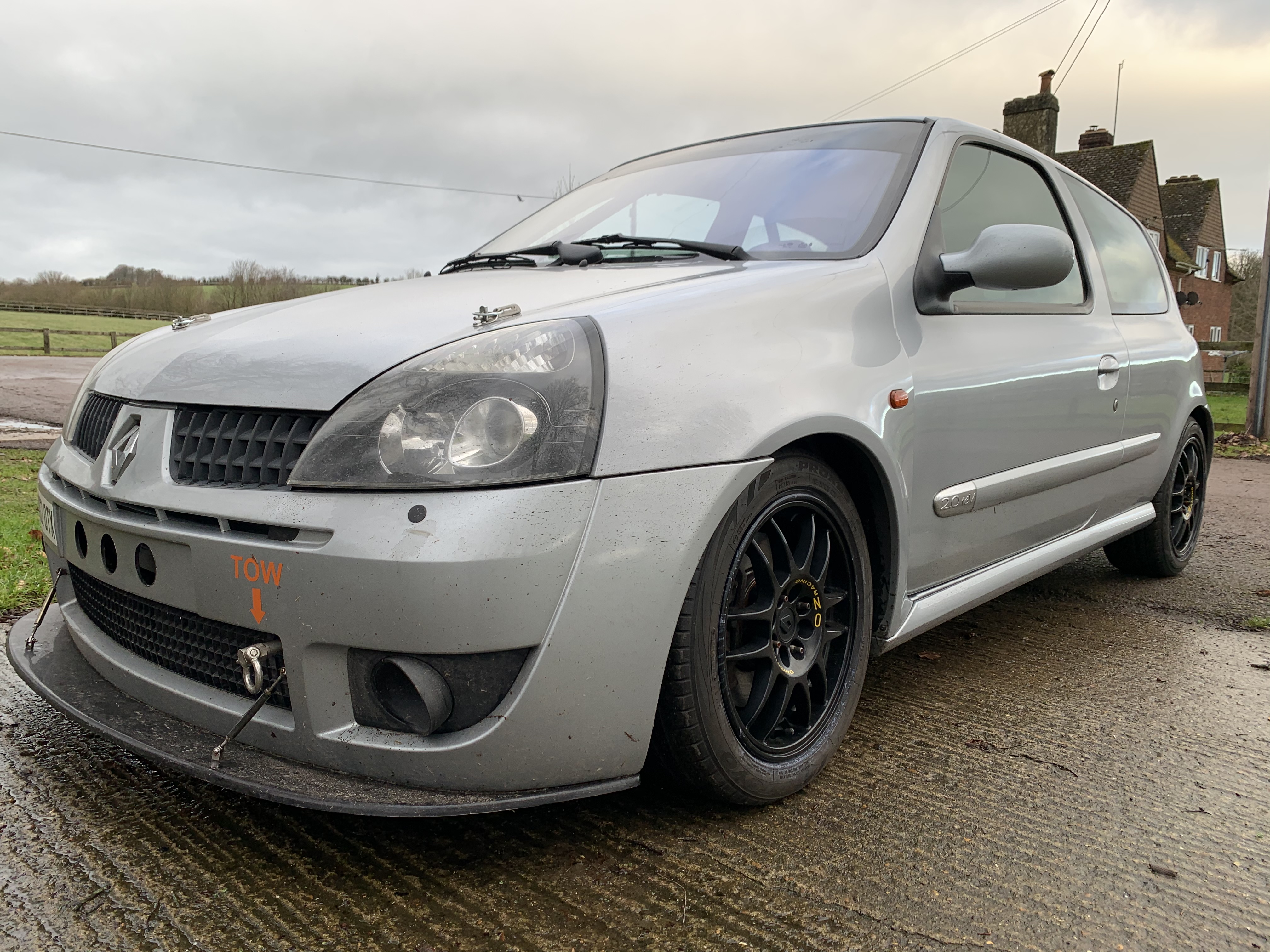

Cheers mate! I meant to tag you but I think I was still half asleep when I posted that this morning! Really really love them, way to good to go on track.

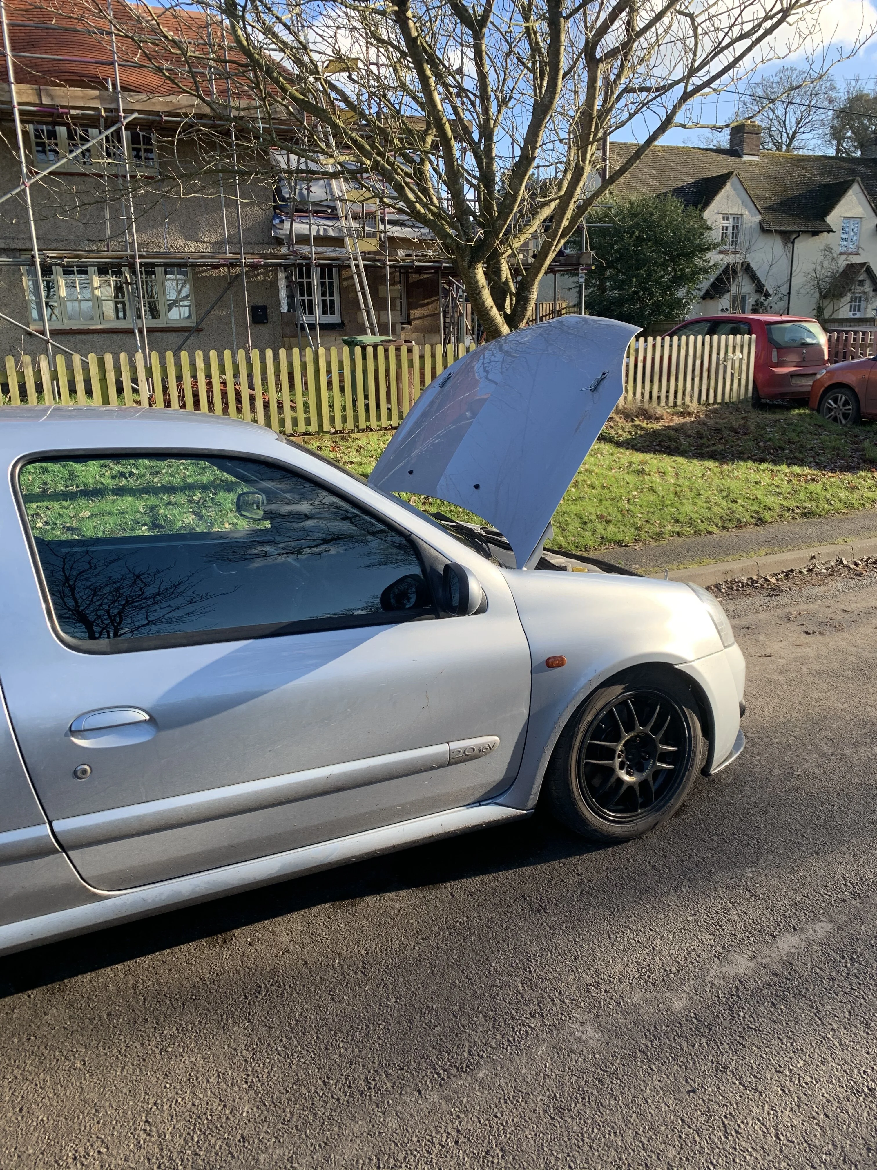

After the MOT hiccup I found the starter motor wiring had shorted on the exhaust manifold, back feeding the alternator and killing the alternator. After much faffing I got that sorted and had to wire in a new inline fuse as the factory inline popped when that happened.
It’s now running Gaz GHA coilovers which will be okay for now as we wanted the 182 on the bilsteins.
I string aligned It in my garage so she now drives straight, when I eventually buy some decent coilovers I’ll borrow the corner weight scales from work and do it properly!

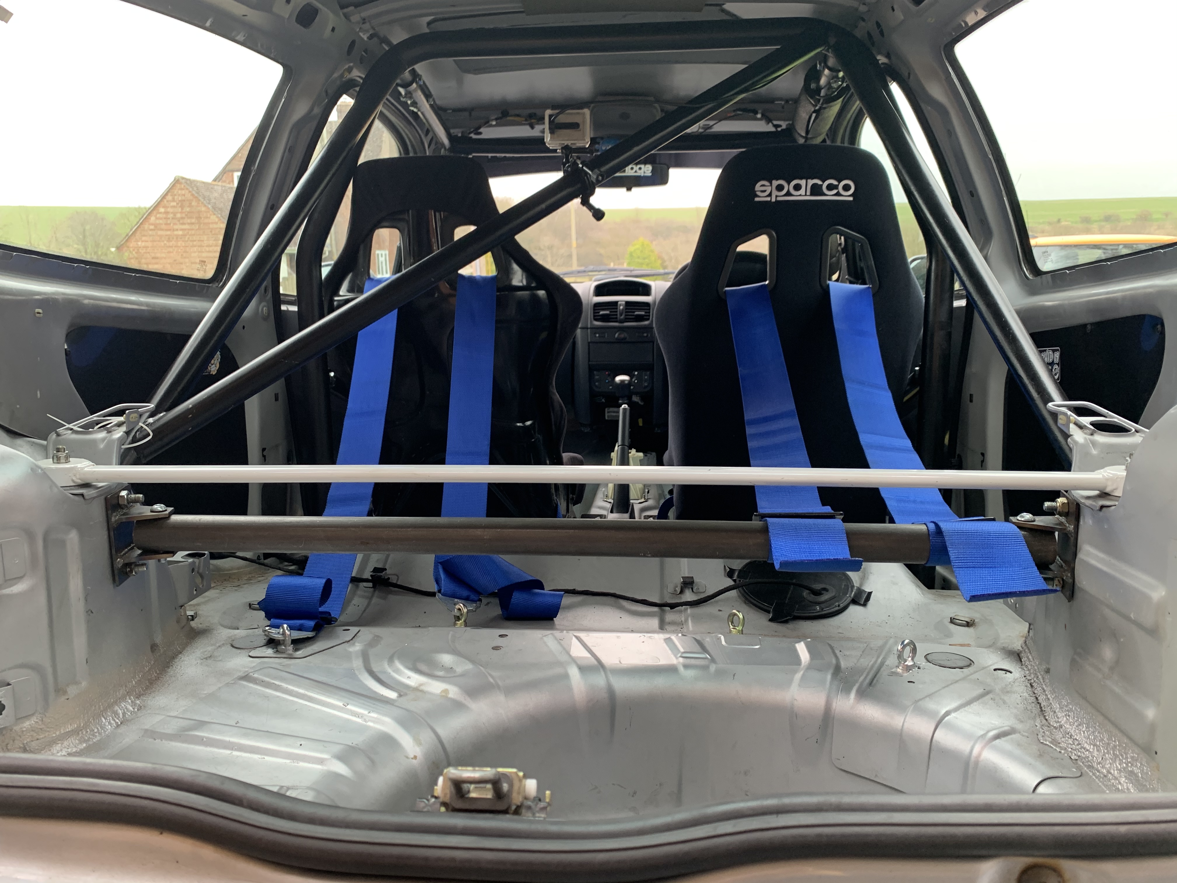

I fabricated a harness bar which is now fitted and braced properly to get the harness angles better. Just need some bits to arrive and I can get my GT3 schroth harness fitted.

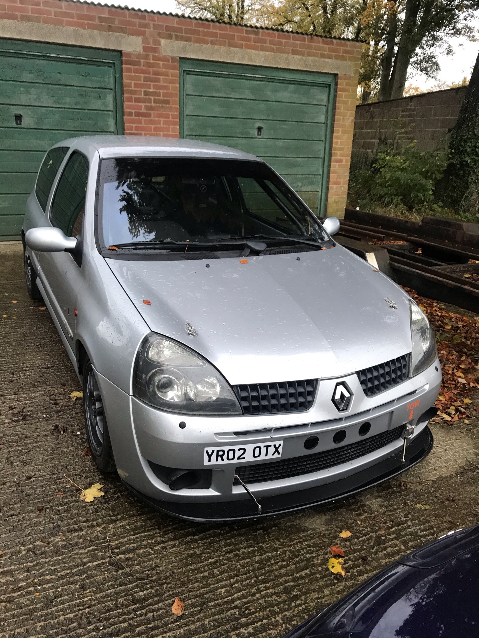

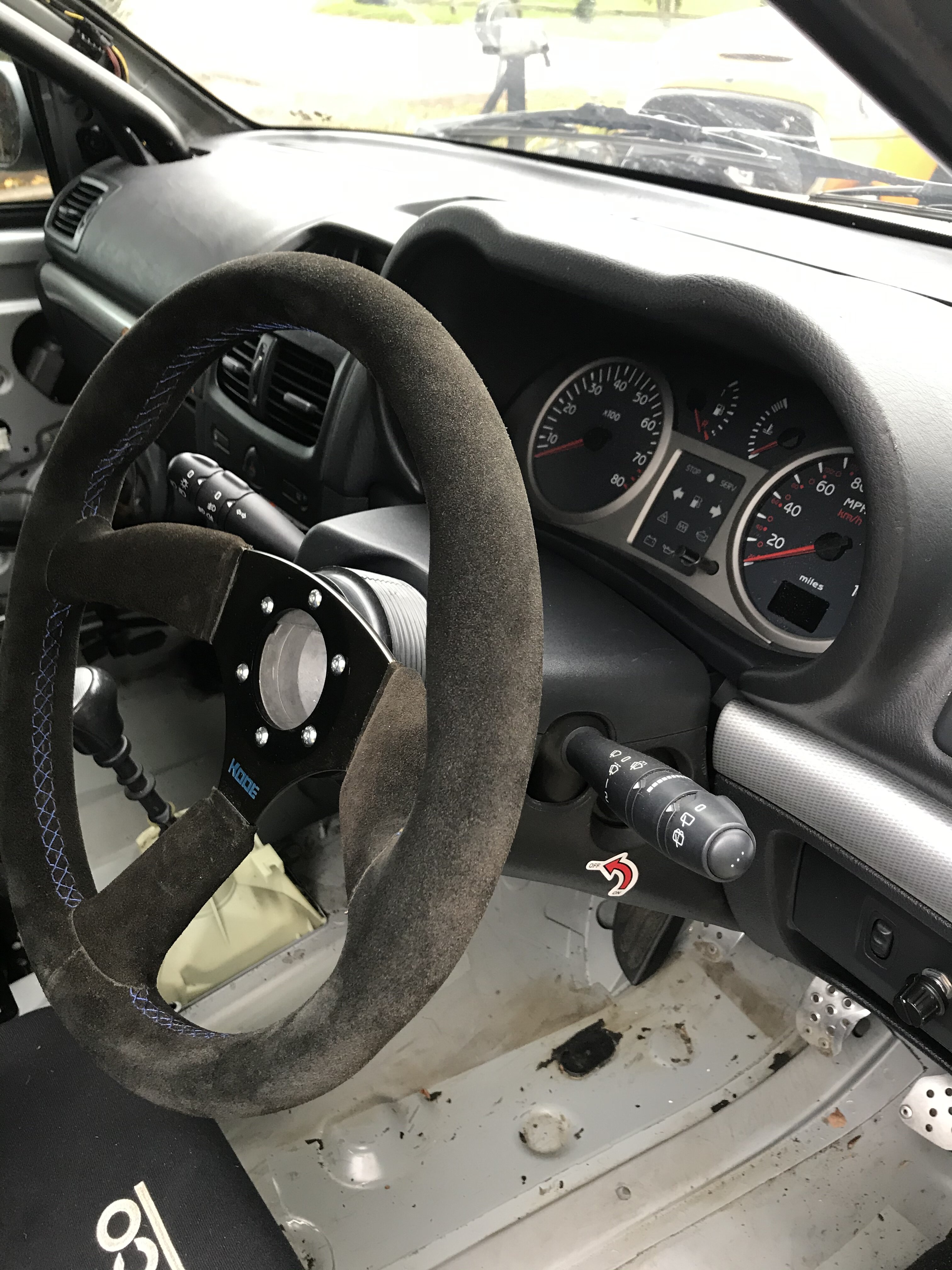

What value would people put on my car? I’m thinking about moving it on as after 10 years of playing with Clios i think I’m done....
Clio 172 track car
Engine stripped checked and built with new gaskets belt etc 2020 and group n timing.
Mapped EFI tuning making 184.9bhp 170lbft torque.
Ktec induction kit
182 manifold ktec link pipe to ktec res exhaust.
Gaz gha coilovers camber bolts
Poly bushed front end
Epas installed with linked standard rack
Forge coolant hoses
Nankang NS2-r tyres on Oz f1 wheels
Fully stripped with sparco drivers bucket seat on Jon foz extra low frame.
Kode steering wheel
Interior loom relocated and removed unnecessary wiring including behind dash.
Clocks show 146500 miles.
PMS carbon shifter
Whiteline rear arb
Brembo Hc discs with ferodo ds2500 pads and braided lines.
Sparco full through dash cage.
Scroth harness (out of date for racing)
This car is really only a harness, electrical cut off and fire extinguisher away from being able to be raced.
MOT until January 2022
Some bits I will have missed but that’s essentially it.
