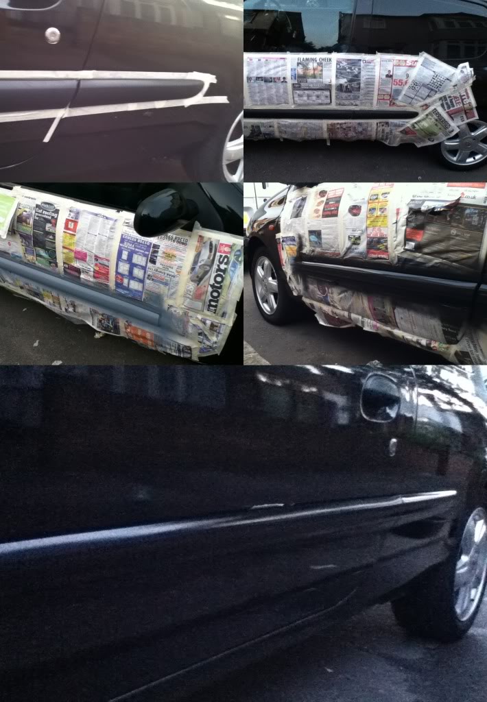

So I couldnt get them off, thanks for the help though!
I still did it, just uhh, a little more timeconsuming, but easier for me none the less :p
Ignore the tiny bit of masking tape i've yet to take off

sounds like a plan mate, how long did the spraying take you ?
The spraying alone? Between 1 to 2 hours?
After two coats of primer I rubbed it down with 1200 wet/dry and then 3 (I think) coats of Pearl Black and 2 coats of clear lacquer, The times inbetween each spray all varied on how quickly they'd dried, So I cant really say a spot on time frame.

Yeah it was alright, The only thing that was majorly time consuming was the fact it took me about 2 hours to mask up both sides of the car, I had to work around the door so that I could open it and spray the bits on the side.
But you'll completely avoid that trouble if you just take them off haha

I can't believe you did it all whilst still on the car, let alone in a couple of hours.
Can you really say you've prep'd them properly that way? Something that size I'd expect to spend 1hour + just sanding it down before priming. I'm in the process of spraying my exhaust trims and spent longer than that already.
If something's worth doing, it worth doing properly. Don't take short cuts as it'll always show. I can't believe the the finish is as good as it could be?
Sorry to be so negative but I could never settle with that on my car.
  Punto/Clio GTT
if you aint prepped the plastic before primering itll just flake off. dont go anywhere near it with a pressure washer.
looks really dull and rough, needs more laquer, or a damn good wetsand and polish them up, depends how much laquers on there
Fair enough but it matches the car fine and is pretty darn smooth, Im happy with it considering my experience, or lack of.
Surely if you're going to spend an hour on sanding the thing down you're gonna end up malforming the strip.
  Golf GT & A4 Avant
not at all, start off with a half aggressive paper to take the dimpled effect off, then step down the paper to something smoother to create the finish. Not aiming to take it back past the outer finish. the finish is just a reflection of the initial product.
I did this to my exhaust trims and in all honesty, wish I'd spent longer ensuring a perfect finish before I started spraying as it took several coats of primer, sanding back and applying more before I used colour.
