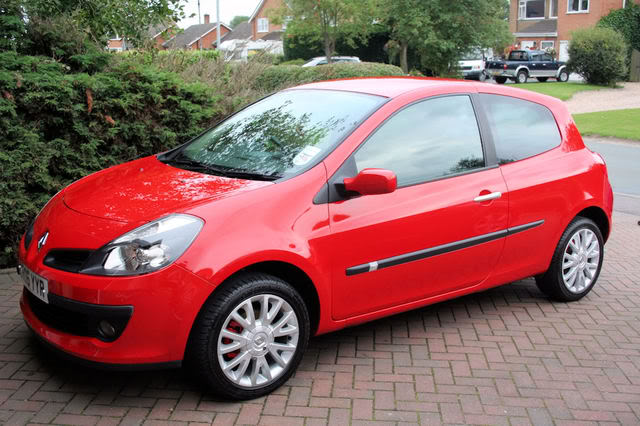

  2008 Albi 197

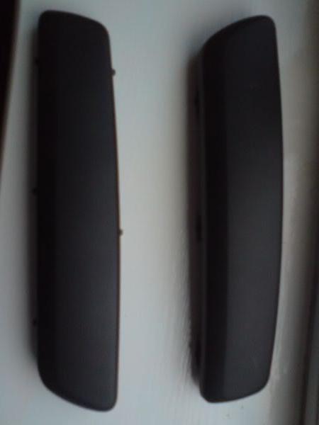

Got these delivered today:
Bump strips for the rear of my Mk3 Clio. The reason I bought a new set rather than attempt to spray the ones on the car is in case I f*ck it up lol
So my questions are:
What is the best way to smooth the texture out?
How many coats of primer/paint/lacquer should I use?
Where, apart from Renault, can I get the paint from for my car cause I have no idea what the actual colour of it is, I have a feeling it might be Volcano Red?
Any help appreciated!
For getting rid of the orange peel texture on mine I sanded them down til they were incredibly smooth with 240 grit then made them even smoother with 800 & 1200.
Then primer. Then wetsand with the 1200 all over and when dry they should feel incredibly smooth.
