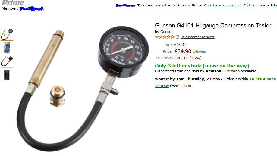

After doing some research, I believe a 14mm hi guage tester will be needed. Decided to go for something of half decent quality (Gunsun Hi Gauge tester 14/18mm), can pick it up from halfords tonight.

Results are in people. Opted to not remove all four plugs at once but rather one by one as i knew i'd get confused and install incorrectly on the return! Also Only took me and hour for the first time doing this (would have been quicker with extension on hose), how the hell can a garage expect to just pull a figure of 1hour 30 for something which is so easy and straight forward, tossers. Un-clipped all parts off the plenum and just removed the power input into the coil, removed the hose onto the throttle body and was able to shift the lot to the side whilst each cylinder was done.
The Gunsun could have done with being a bit longer, I would recommend a reliable means of being able to tighten the hose into the spark plug thread as the holes are so god damn deep, I used a needle nosed pair of locking pliers , to give it a half turn or so on top of just turning loosely by hand, a ratchet spanner with adjustable head would also probably have done it also. Cylinder four wasn't quite tight enough as some swarf blew out, so stopped cranking and re-tightened and got a better reading.

They're pretty precise readings to be taken with a Gunson lol
Not bad readings and within 10% so no need to worry about valve or ring seal issues.
Try without all 4 plugs and it will probably read a little higher as the engine will spin over quicker.
Those figures look acceptable in terms of hardly any variance but pointless comparing to someone else using another gauge when the gunson ones are such terrible quality. I've got 3 gunson gauges and they vary by best part of 20psi between them.
