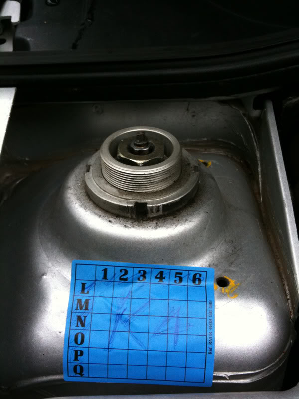

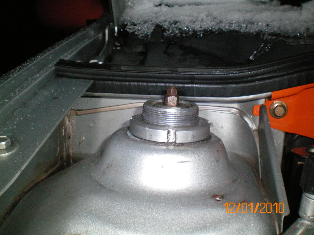

Check this picture, the top mounts have a threaded part that sits under the turret and the top part tightens down over this causing it tighten down.. Get me. If anything is loose its the top part (seen in the pic) C Spanner is needed..

Oh yus! I figure there's nothing I can brake with stilsons and they have a good grip, do I have to jack it up to check? Or can I just try tightening them?? And if they tighten, they were loose?
  Iceberg Ph1
Keeping it on the ground would be how I would do it, least then the force from the suspension pushing up will be easier to tighten down the nut if it is loose..
If it does tighten up, then yes, it was loose, wouldn't be so much of a 'solid' top mount then haha
Rob

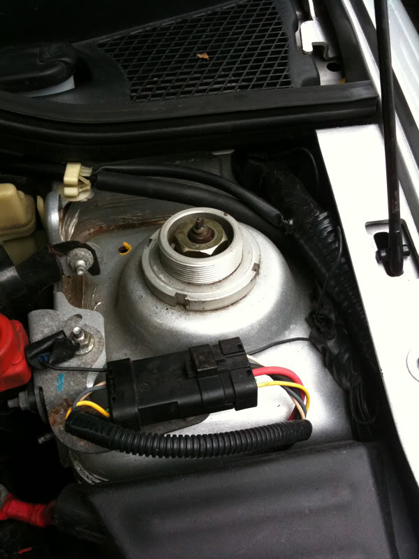

Just went out and checked it, both of the c spanner bits are TAF, got a big pair of stilsons on them and couldn't budge either, either way!!!
The bolt seems no where near as far through as the one in your pic does though, I've got a few pics I'll upload in a min...
