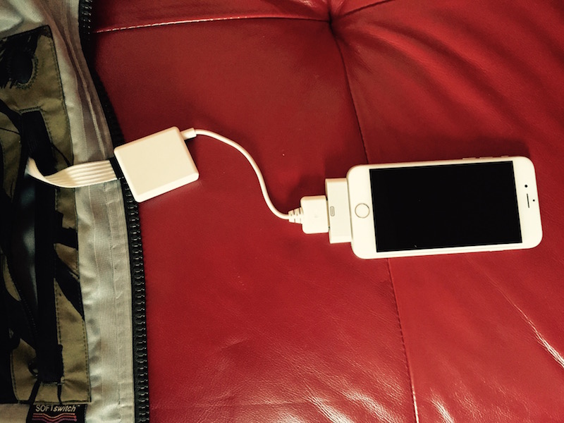

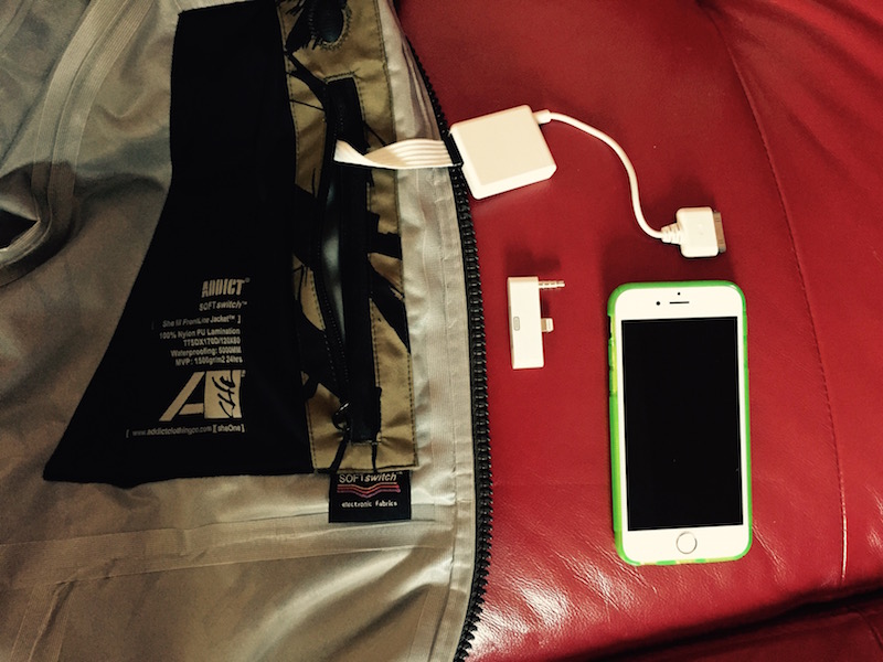

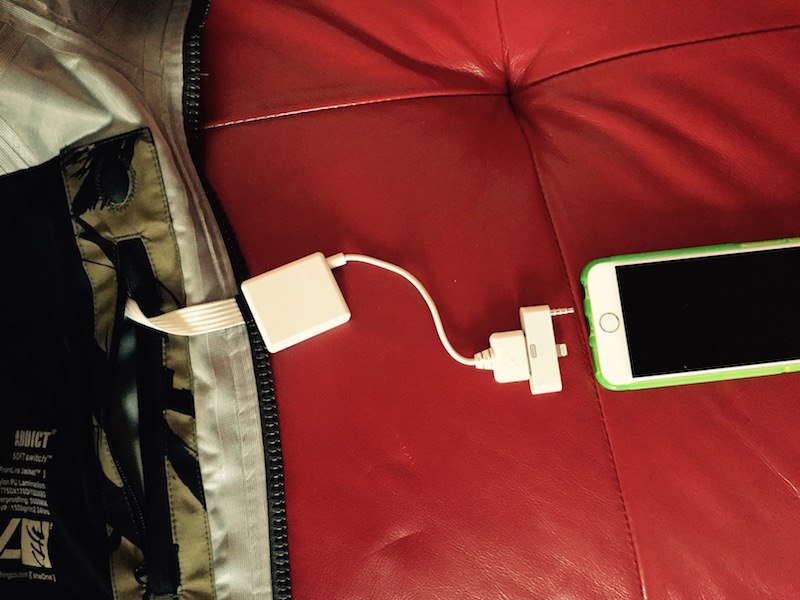

Bought a new adapter today plugging it into the connects2 it charges the phone but the music comes through the phone. Any ideas please?
  BMW 320d SE
You're probably going to need the official Apple 30 pin to lightning connector as it supports music transfer through it.
  SQ5
It's worth buying the adapter that has a short bit of lead too, makes the phone feel normal that's having a massive block on the bottom
BREMBO
  V6 Mk1, Golf GTI Mk5
Do you have a link please mate?
Is it this http://store.apple.com/uk/product/MD823ZM/A/lightning-to-30-pin-adapter
Looks the exact same as that which I bought for 99p, strange that it charges but no sound but it seems to have worked Dan?

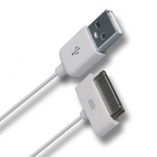

iphone 3 charger like below supports Audio
Apple iPhone 3 4 4s usb charging charger cable 1m 3m ipad 2 3 iPod-500x500.jpg
New iPhone charger like below DOES NOT support Audio

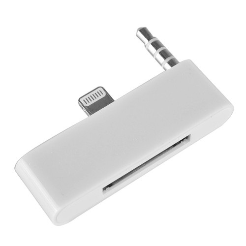

For new charger the converter is needed with the 3.5mm Jack

If you have something enabled for the old 30 pin connector using the 30 pin to lightning converter allows audio.
The MDI in the VW's have either a 30 pin adapter or USB input. Plugging in the Lightning charger to the USB doesn't work at all, plugging in a 30-lightning converter to the 30 pin interface lead works fine with audio and control.
