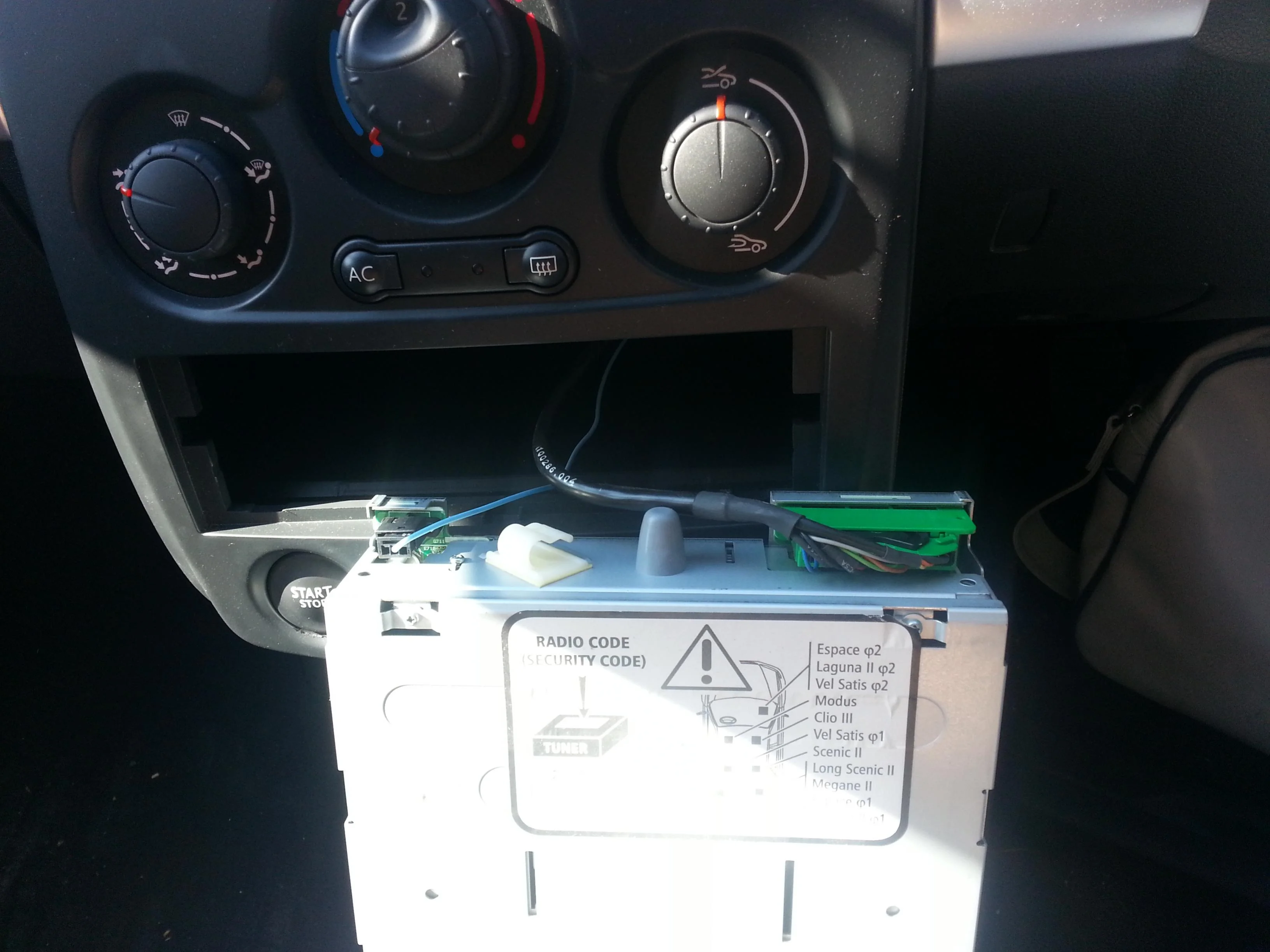

I have just bought a Connects2 Aux 'thing' and the instructions say its just a simple remove the headunit and slot it in the back. I have removed the head unit but there is no slot in the back for the cable to go?
Any ideas? :)
There isn't a blue plug on the back, one tiny slot on the left and a long but thin horizontal slot on the right.
Should look like this. Plugs into bottom left hand socket
Same problem =/ Fits in the smaller slot but doesn't work as I don't have an 'aux' option on the cd player! BUMMER
Jut figured out how this works if anyone else gets stuck - plug the wire into the back (hole next to the one for steering ctrls). Then Hold down the button next to expert until it beeps, press the CD skip track buttons (left and right on the other set of buttons) then it'll cycle through a menu, keep going until you reach 'Aux off' then press the wolume up button once to get 'aux on' then your done! when you select aux on the source menu it'll be playing through the newly attached cable
