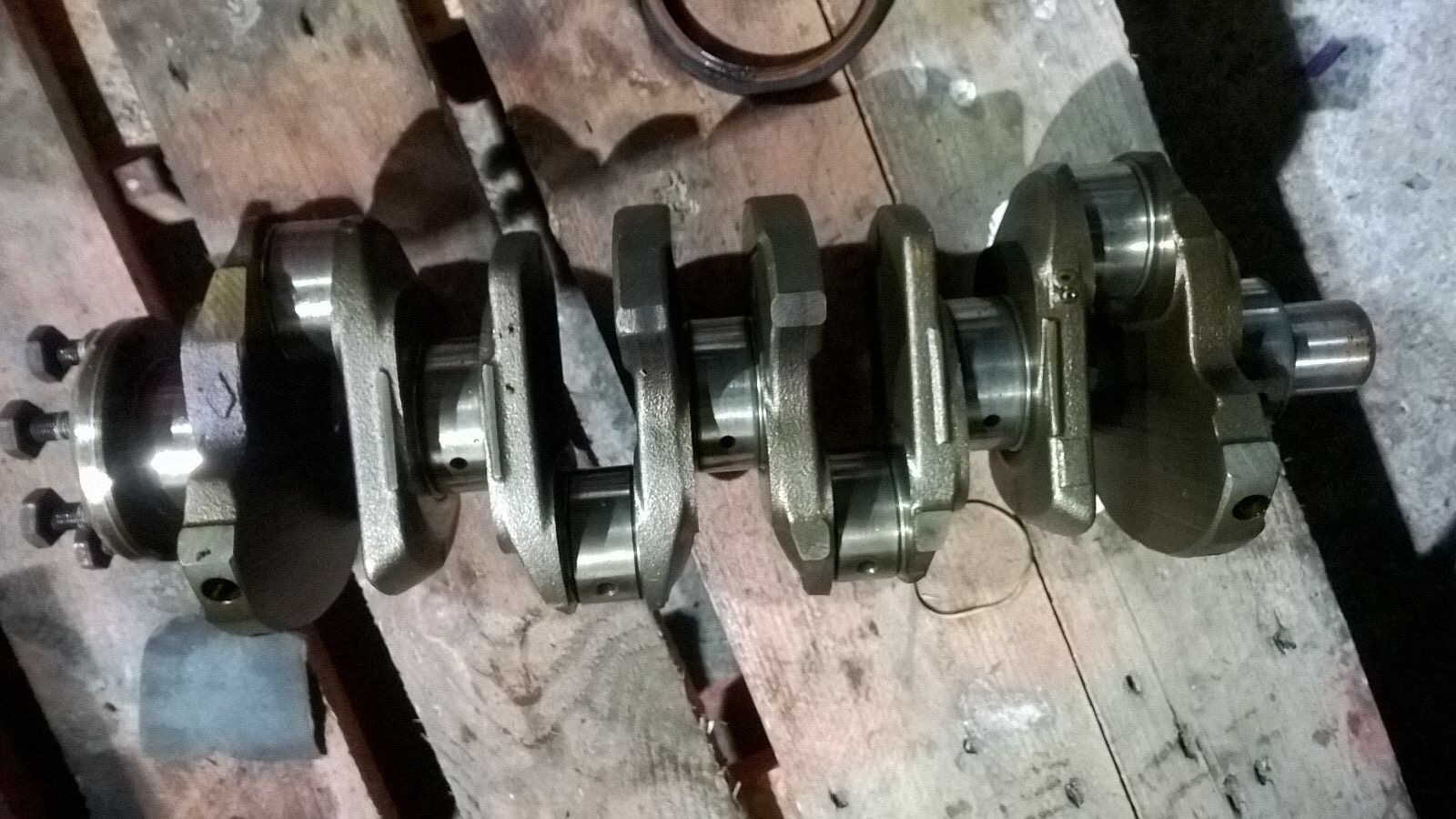

After a big end failure on my 182 engine, I bought a donor F4r736, to use the crank and one rod. The weights of the conrods from my engine were roughly 600g, and the weights from the donor engine were roughly 640g. There were no signs of weight being taken off the rods (at least not 40g!) so I was wondering whether this is Renault tolerance or if different F4r engines had different conrods?

I would say that's just tolerances that renault will allow mate tbh. I've never seen different rods in f4r's before (as in 730, 736, 738 & 830) but they're slightly different on the 225/230.

Are they all 640g's? As in the heavier ones? If not I'd get them all dynamically balanced along with the crank, pistons, flywheel and crank pulley.

Give or take a few grams. The plan was to balance the new one to match the others which had all been done before. I'm just not so keen on using a set which are roughly 40grams heavier each!

Don't weigh any steel rods for these engines then mate. You may be upset! Lol! They're a lot heavier.
So what engine has the crank and rods come out of? The cranks in the 736 ain't the best, but the 738 isn't too bad. 730 is the one to go for if you can find one.

The heavier rods and the new crank are from an engine sold as a 736, but it had a 182 cam cover and the number has flaked away so can't really see what it is for sure! The lighter rods were from a 738.
