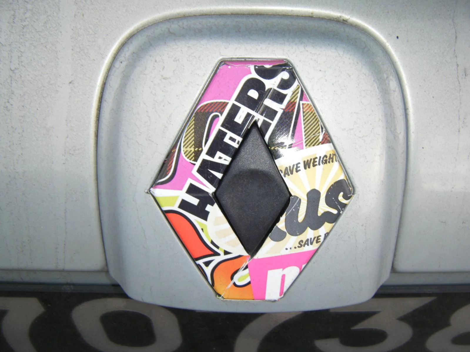

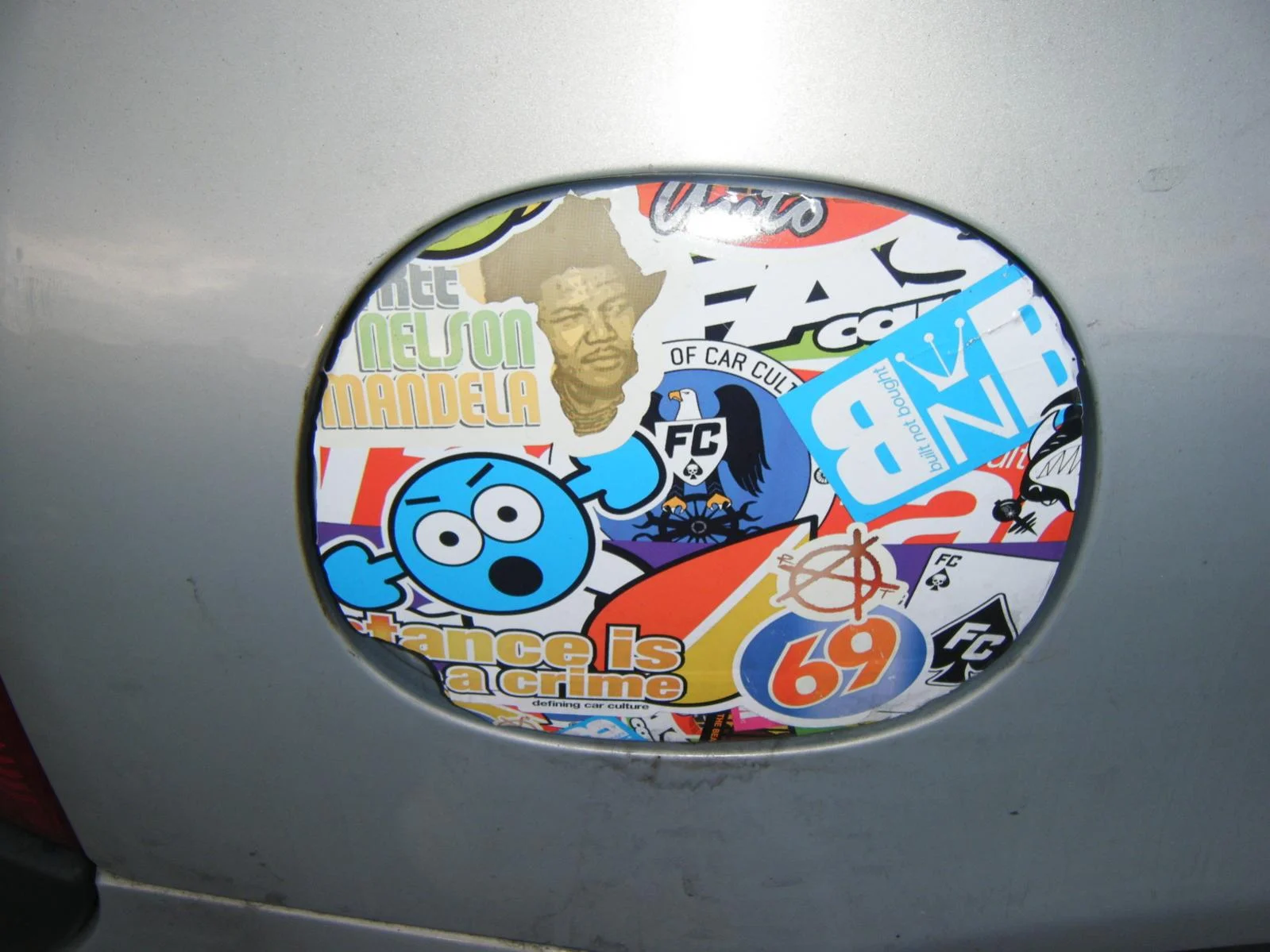

Cool Mods For Skint People....
  Clio 1.4 16v 2003
Wrapped front and back diamonds, petrol cover, side bullets and clio badge
only got pics of these atm.
cost me nothing but time as they were free sticker bomb sheets from fast car :)

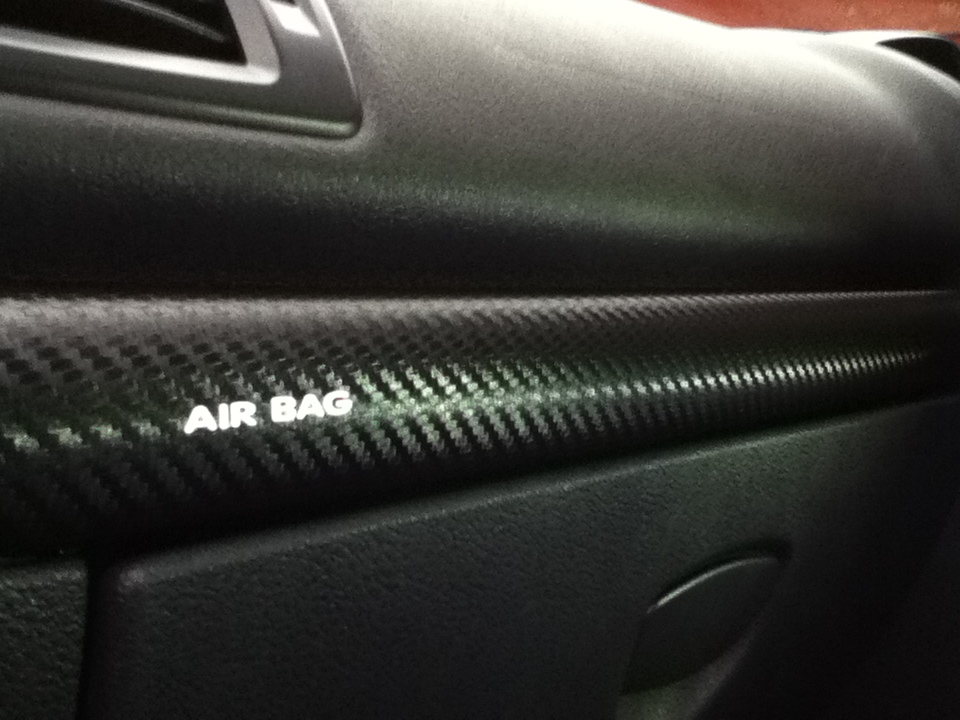

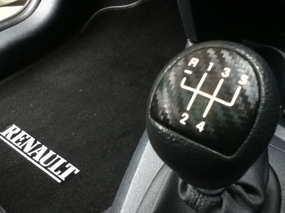

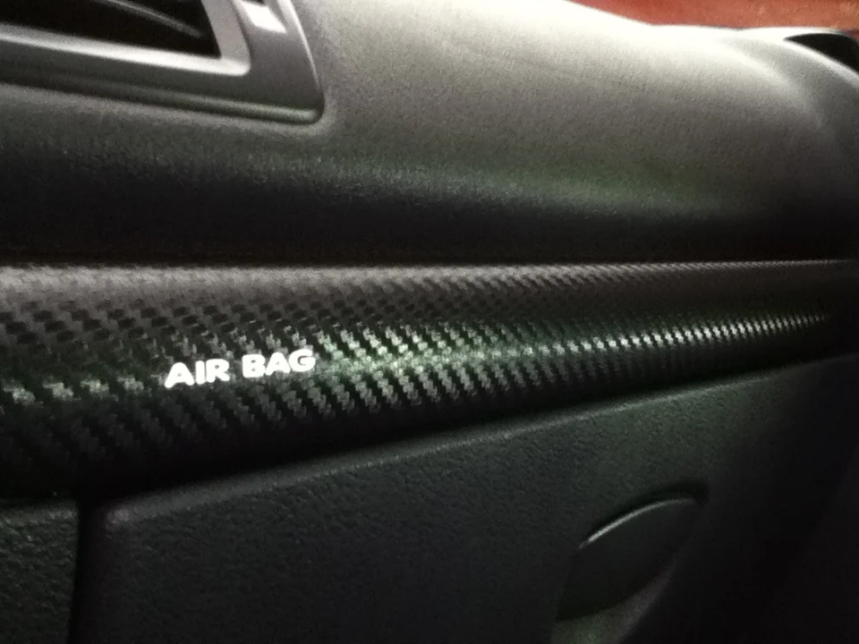

Wow old thread! Haven't seen these mods on the other pages so here goes.
Carbon wrap gearknob + dash trims with decals:

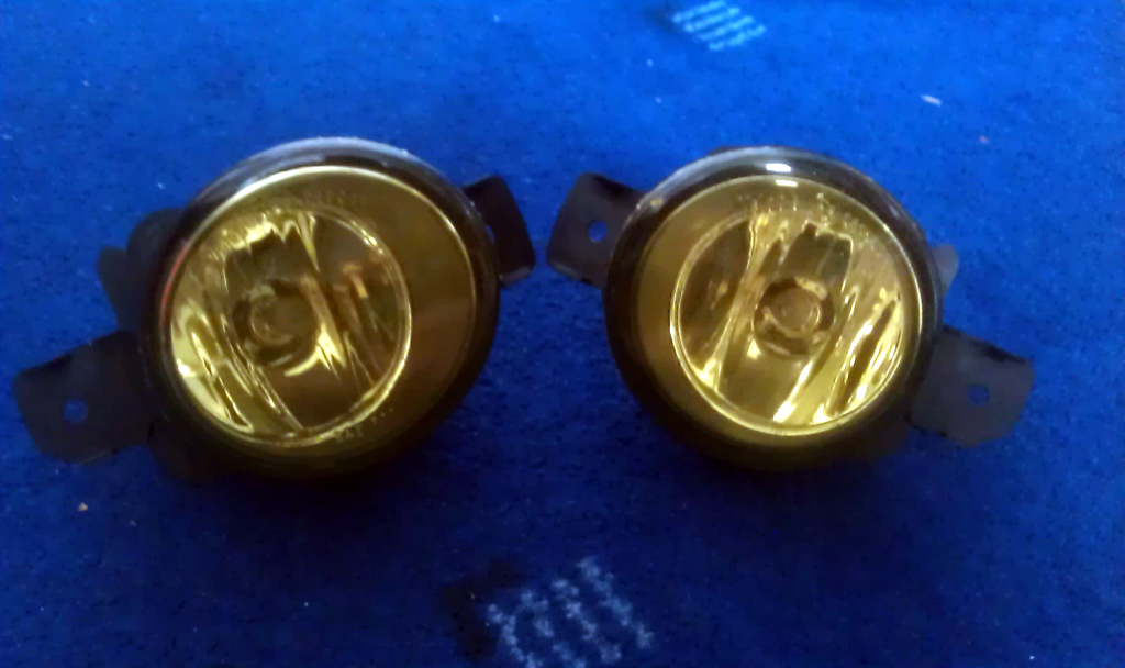

Lamin-X front fog lights:

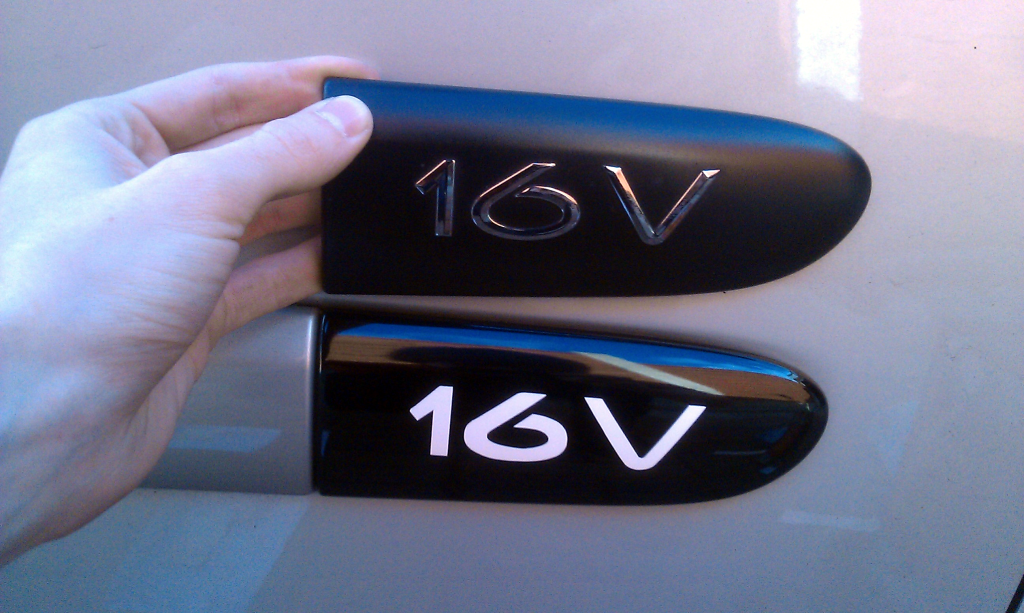

Do something with your bullets:

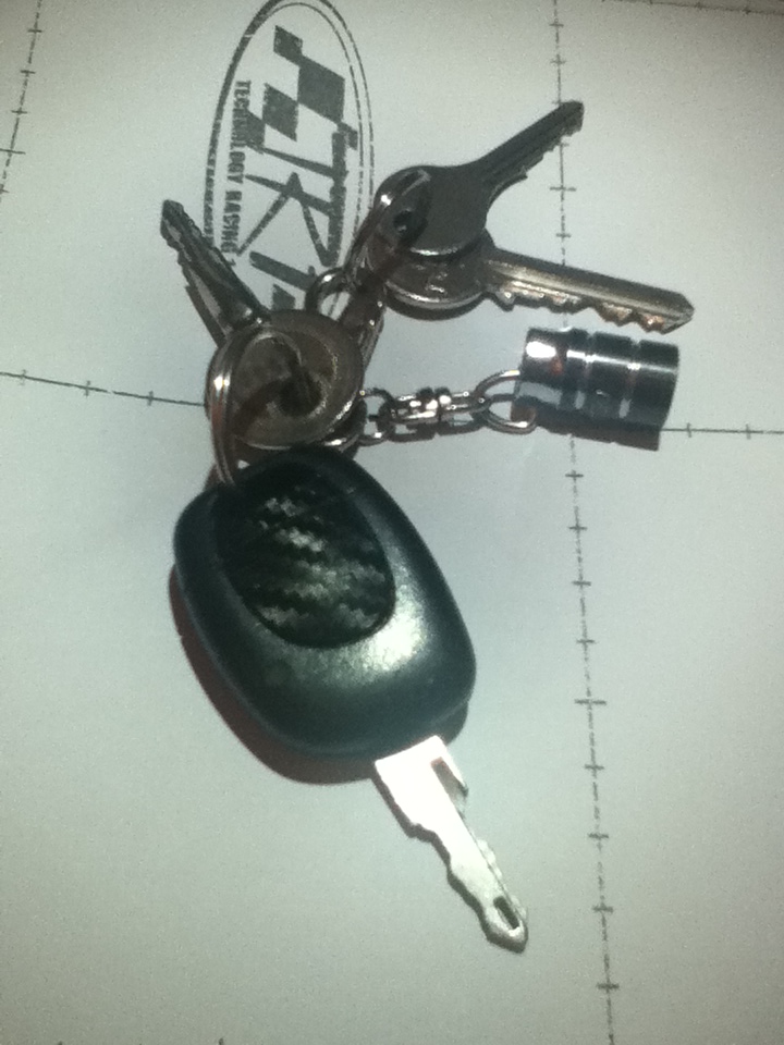

Get creative with your car key:

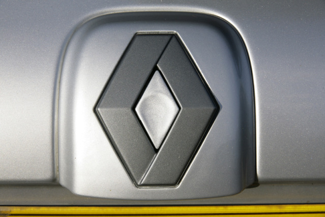

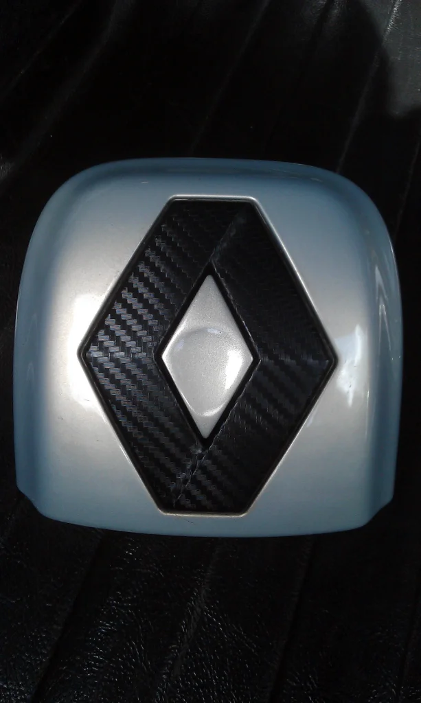

So how does one go about colour coding the boot button? That looks damn nice and I don't know how I never thought of it.
DaveDreads
You have to remove the boot mechanism from the inside.
It's only held on with 3 bolts, then undo hook the metal bar that connects to it,
there's a rubber pipe that goes to it that just pulls off, then you have to hold the button closed to get it out,
otherwise you'll scrape you knuckles and end up swearing in the street.
It's easy tbh, here's mine.
  Derv 65, MPG > BHP
Sounds easy enough. Did you just use any old silver paint rather than the iceberg? And did you do a proper primer and lacquer job as well?
I'd personally use the same colour as the car...
You will need to sand/flatten, primer and lacquer like any other spray job.
DaveDreads
I used a rattle cans of plastic primer, Iceburg Silver and lacquer I bought from Halfords,
although if I was to do it again i'd buy a better lacquer, the Halfords stuff is sh*t and gave me a headache for 2 days,
​despite using it outside.
