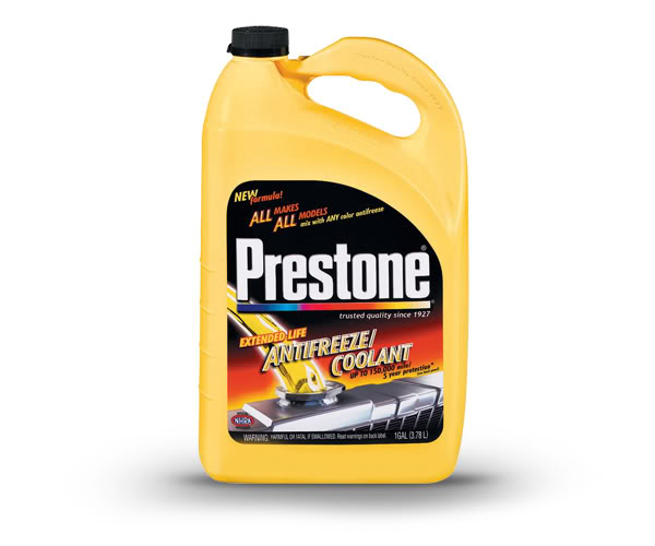

Yes, another coolant question....The car is due a coolant flush and I'm still confused...
I bought 2x of the Prestone Coolant from Costco a couple of months back (Never Opened). Now that I'm looking into actually doing the flush I'm reading things along the lines of Type D coolant and
ethylene glycol based. I know that Prestone Coolant is ethylene glycol based. So just a quick one, will it do the job.
Pic showing what I have:
People will genereally say you MUST used Type D on an F4R. Personally i used "Motul inugel expert" as suppled by Opie oils, its a "monoethyleneglycol" concoction and hasnt appeard to erode away my engine block yet. I think you will be fine.
