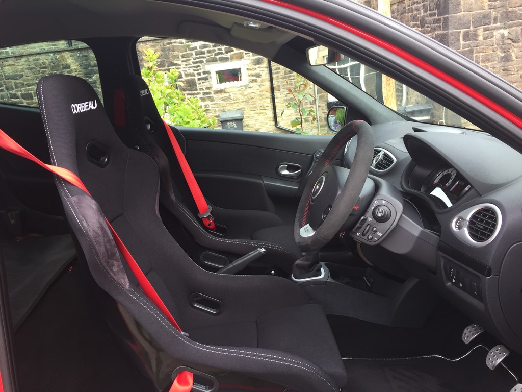

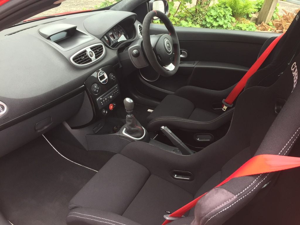

Worth updating this thread now that they're in the car. I love them. For the money, they're unbeatable.
I love the interior now.

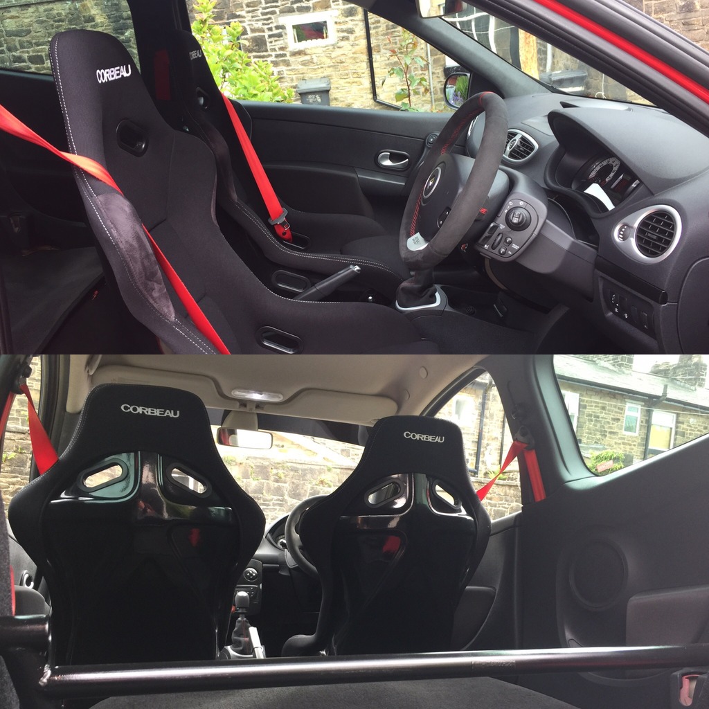

The finished interior:
I found them really comfortable and I've got back issues. Sat in them for over 4 hours going down to Blyton one year without an issue.
