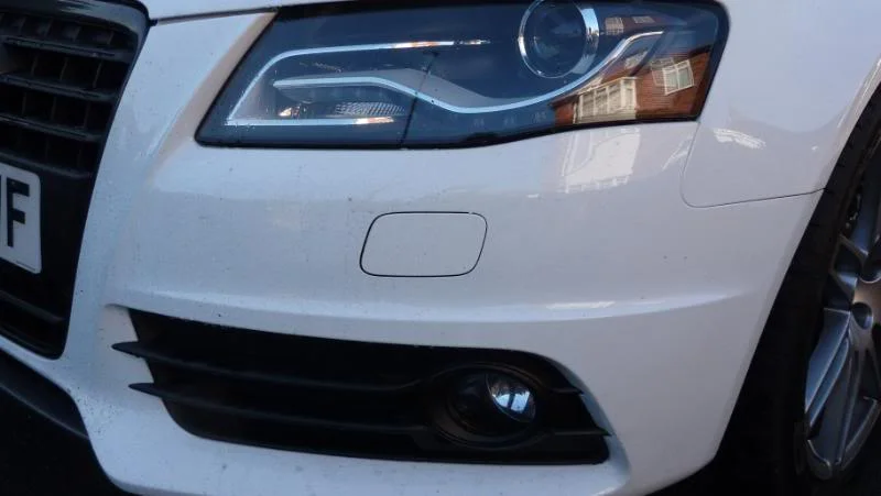

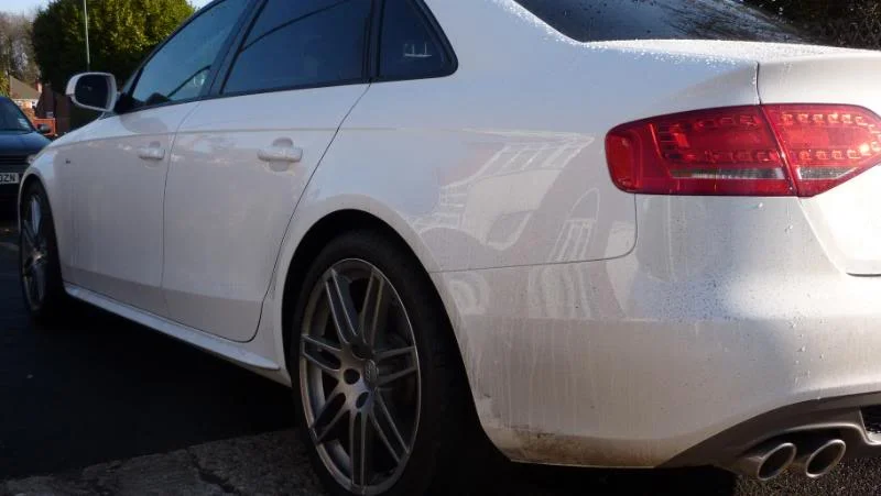

A few before pics:

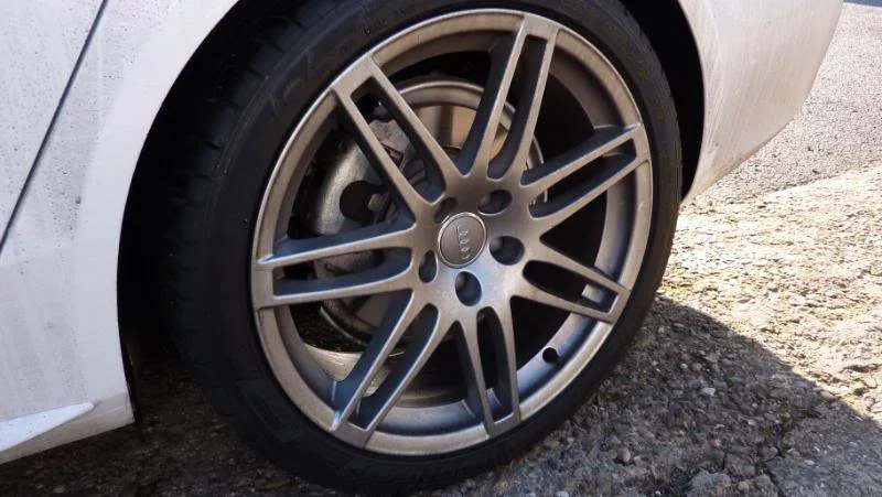

I began by cleaning the wheels, tyres and arches with my favourite combination of AS Smart Wheels, G101 and various brushes, including the Envy Wheel Brushes.

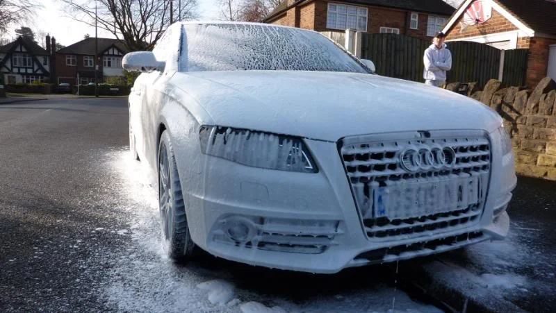

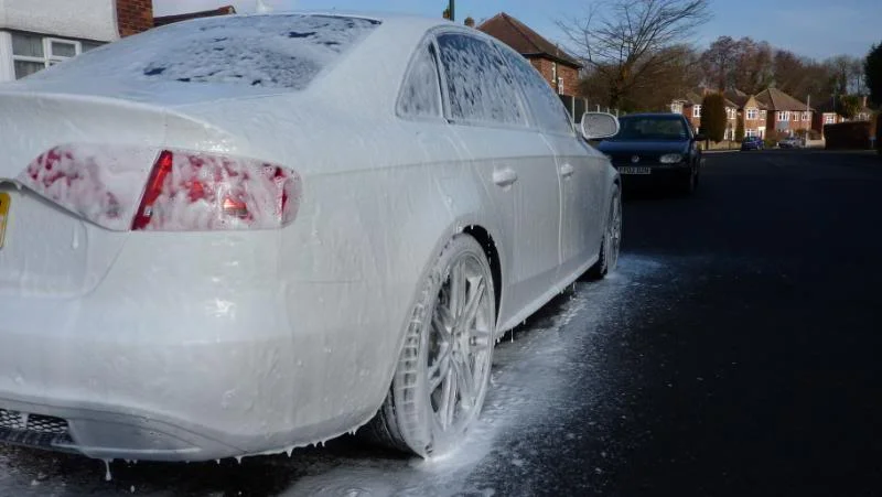

I followed this up with AS Actimousse, applied via CYC HD Foam Lance and my Nilfisk E140:

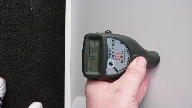

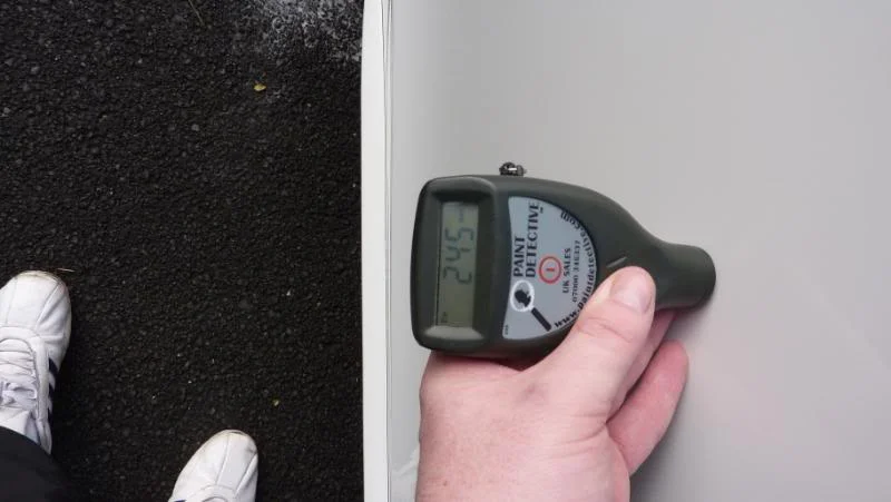

The average readings were about 200 microns, which most panels being between 190-210. One particular spot on the car however gave us this:
Very odd, but I couldn't find it again! :lol: A mis-reading perhaps?

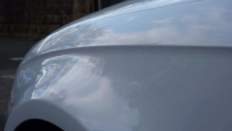

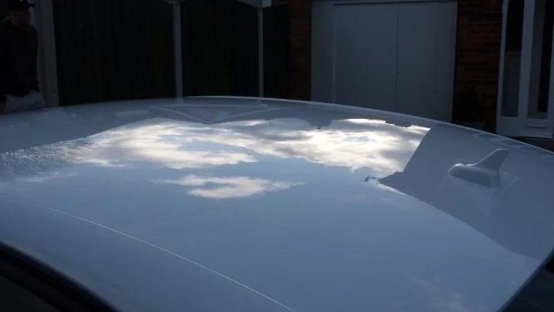

After testing various combinations on the bonnet, I finally settled with Megs #105 and Sonus SFX1 pad. Most panels needed 2 hits to remove the swirling, and even then I would say that I only achieved around 85-90% correction. Time was against me here. I wasn't totally happy with the level of correction, but it was a significant improvement, and most panels were very pleasing, plus the owner was pleased, which is what matters
Corrected pic (I struggled to get any of the swirling):

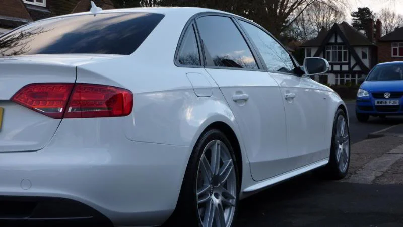

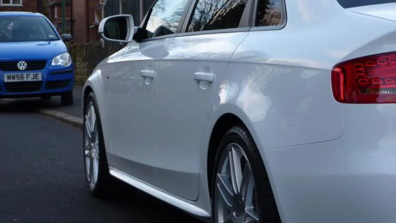

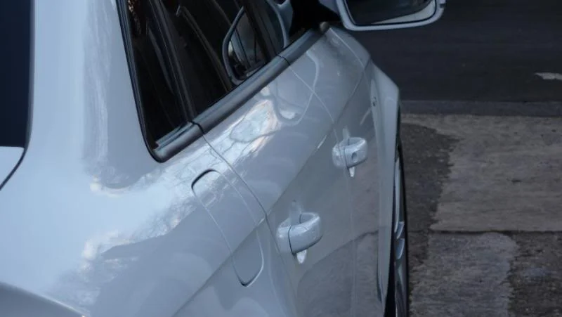

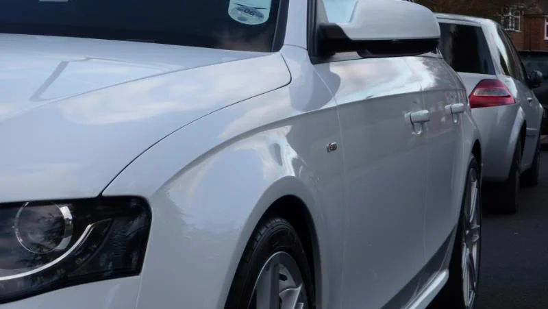

A few afters:

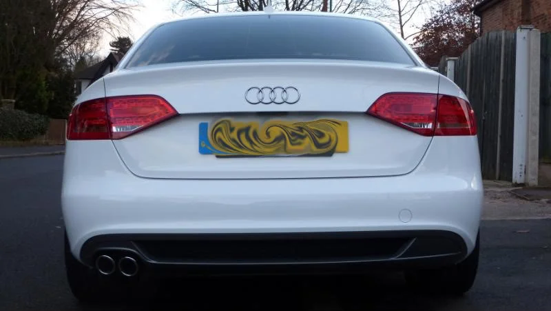

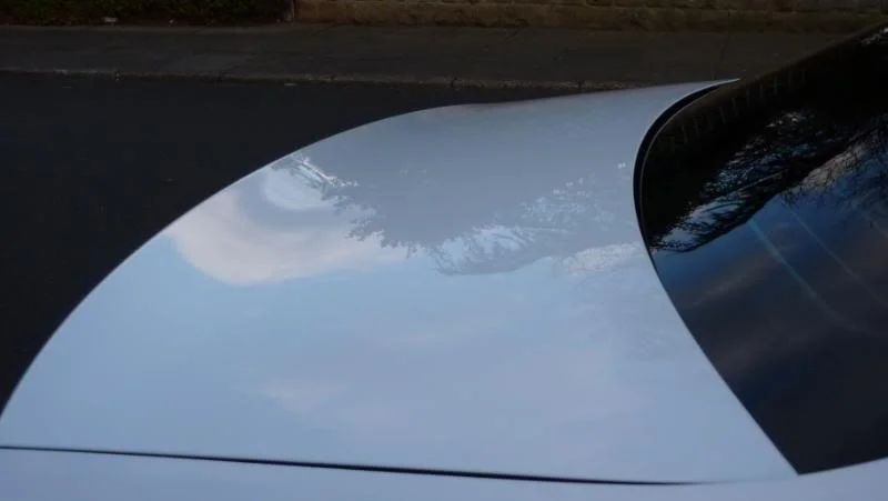

My fave shot:
Thanks for your hospitality Tony It was good to help you out, and thanks for your help :thumb:
