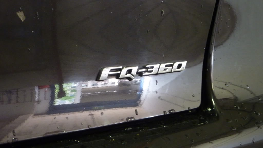

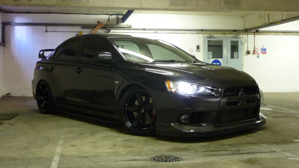

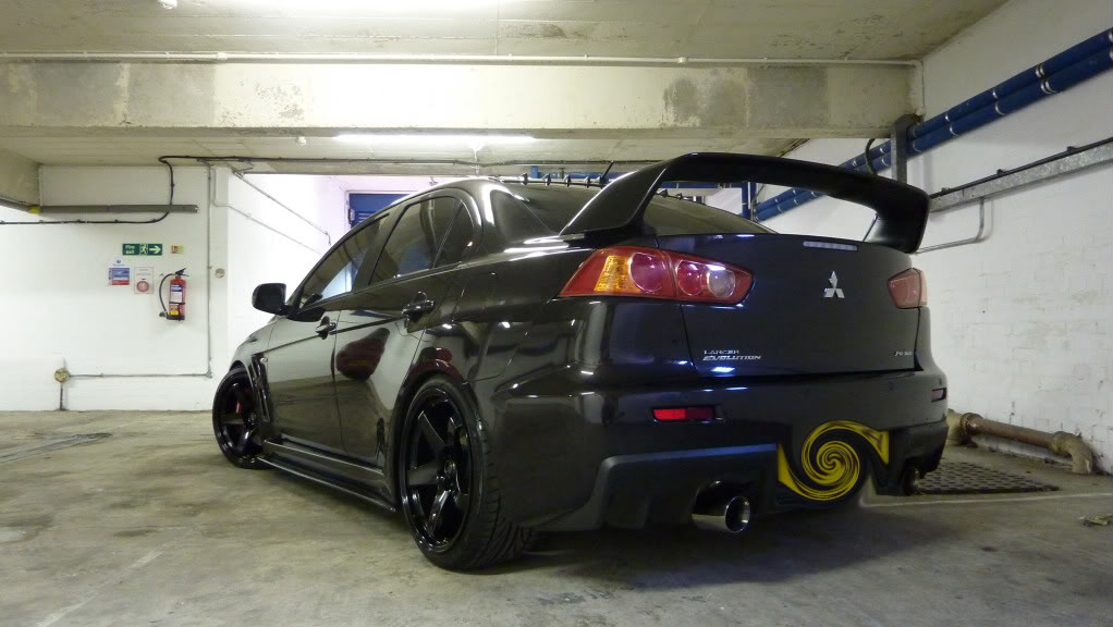

I was contacted earlier this week with regards to restoring a bit of life back into the paint of this stunningly stealthy Evo X FQ360. Like most Jap cars, Evo's have notoriously soft paint, and often very, very thin, making them very challenging to detail as you often don't have a lot of clearcoat to play with. This particular example had been subject to repeated 'immigrant car washes' over its 3 year life, so I was expecting the paint to be pretty bad...

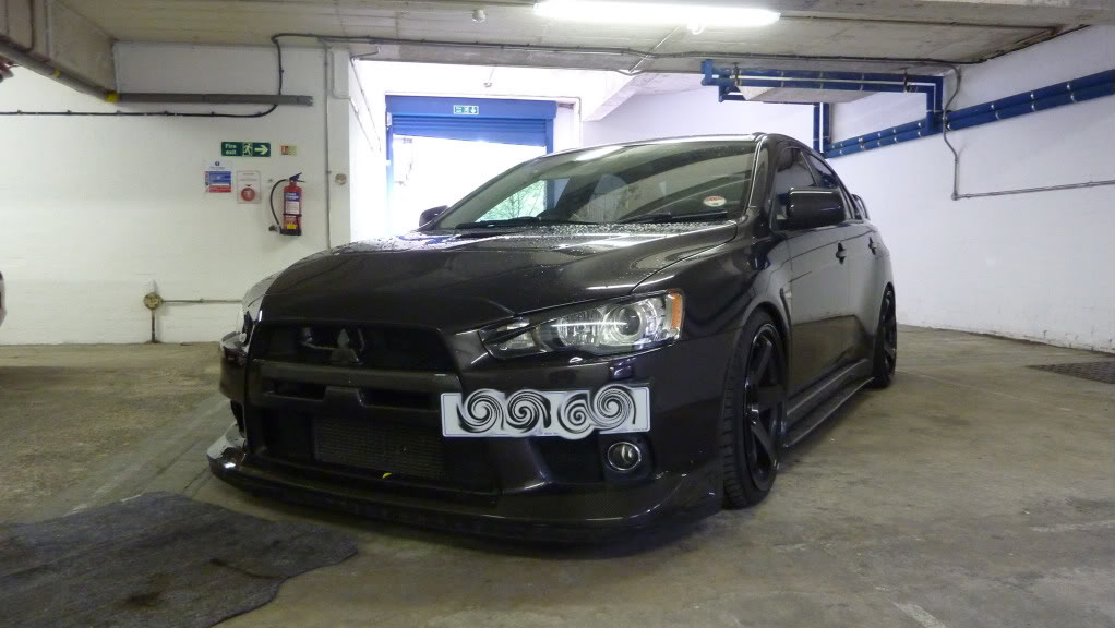

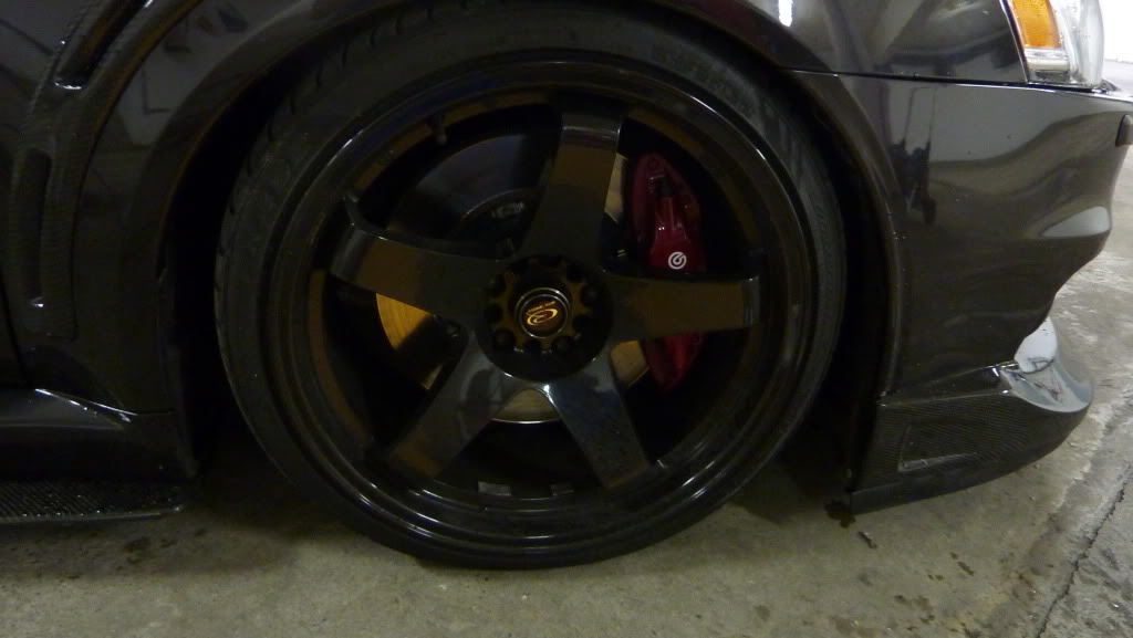

So anyway, I arrived to begin this car at 10am. Here are a few befores:

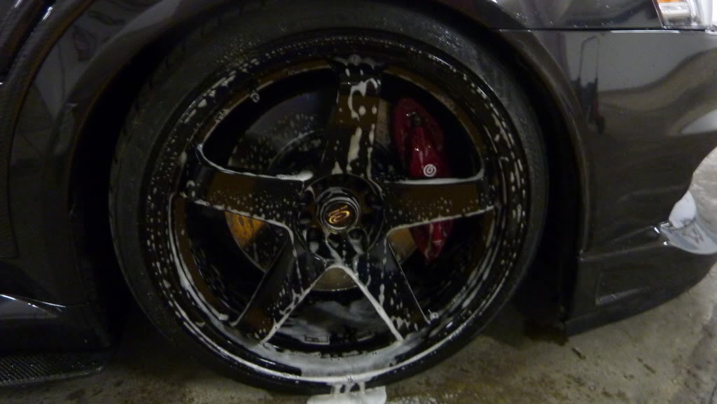

As ever, I started with the wheels, arches and tyres, using AS G101 and various brushes:
Rinsed off:

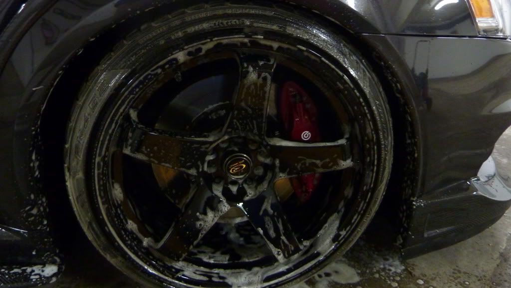

G101 via foaming spray head applied liberally and worked:
Then rinsed off (blurry pic - grr!)
The car was then washed with Zaino Z7 Car Shampoo, using two bucket method and Dodo SN Sponge.

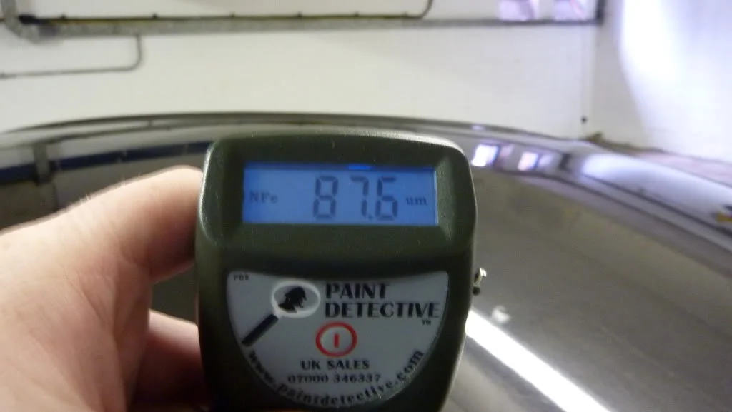

Next up, I began to assess the paint. I expected the paint to be relatively thin, but...
That was one of the higher reading on the bonnet and roof! The lowest ws 69.1!!!
The sides of the car had a bit more to play with:
I really need to invest in a better PDG, allowing me to measure the different layers, as I was slightly apprehensive about polishing the roof and bonnet on this car. Gently does it...

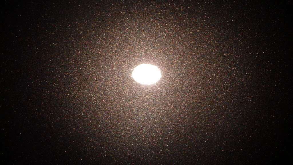

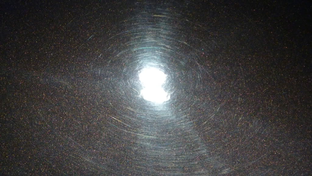

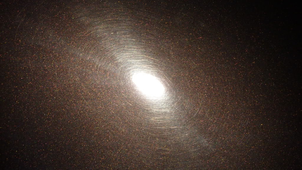

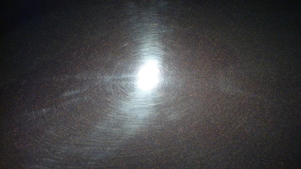

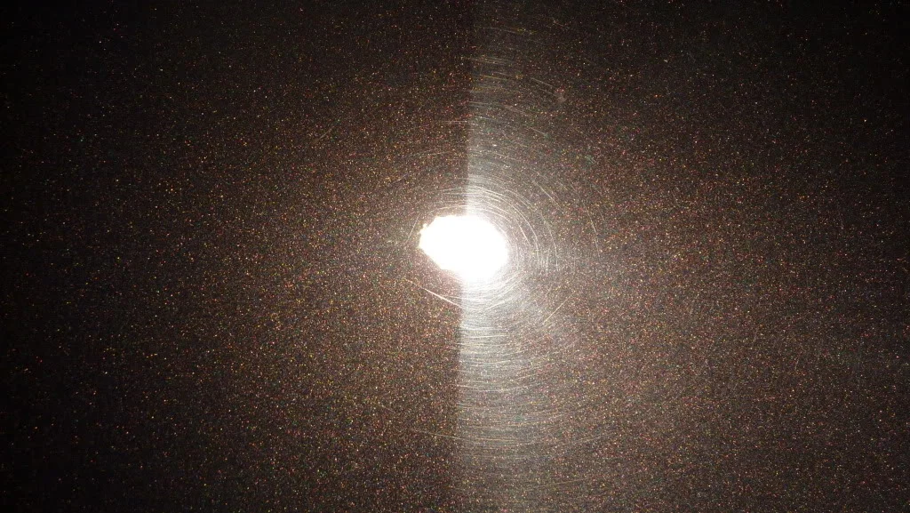

The paint itself, as expected, was in a rather sorry state... (illuminated with a Brinkmann)
Swirl city then!

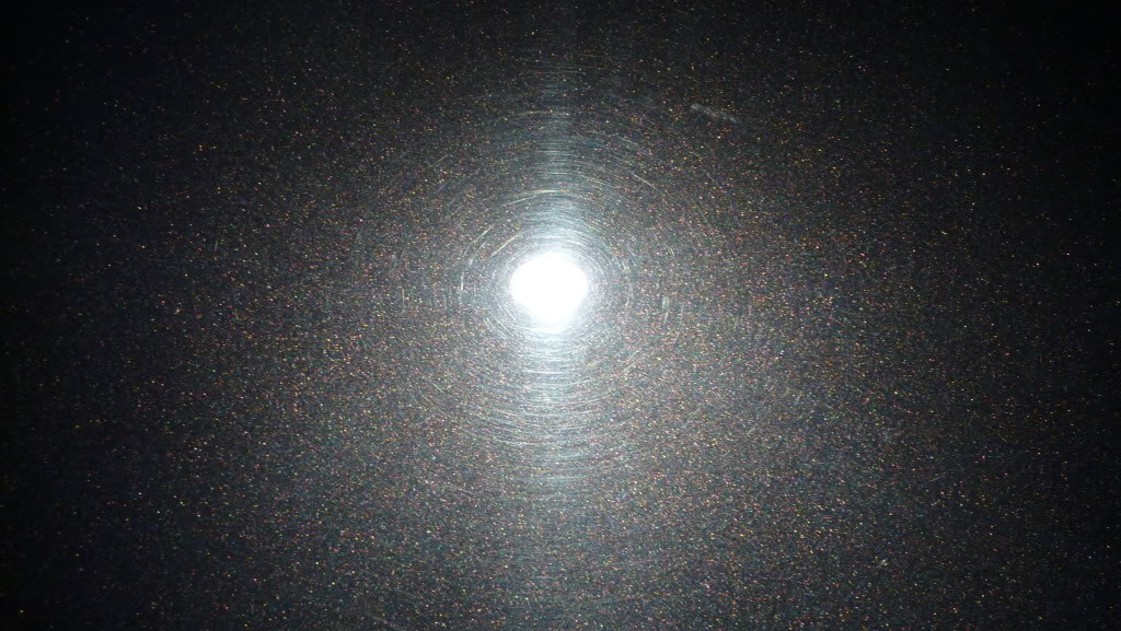

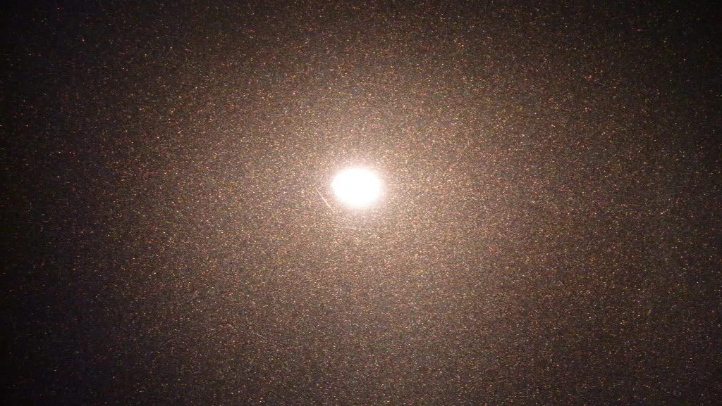

After playing with a few combinations, I was getting very good results from Megs 205 via 3M Polishing Pad (Yellow) on my 3M Rotary with 3M backing plate.

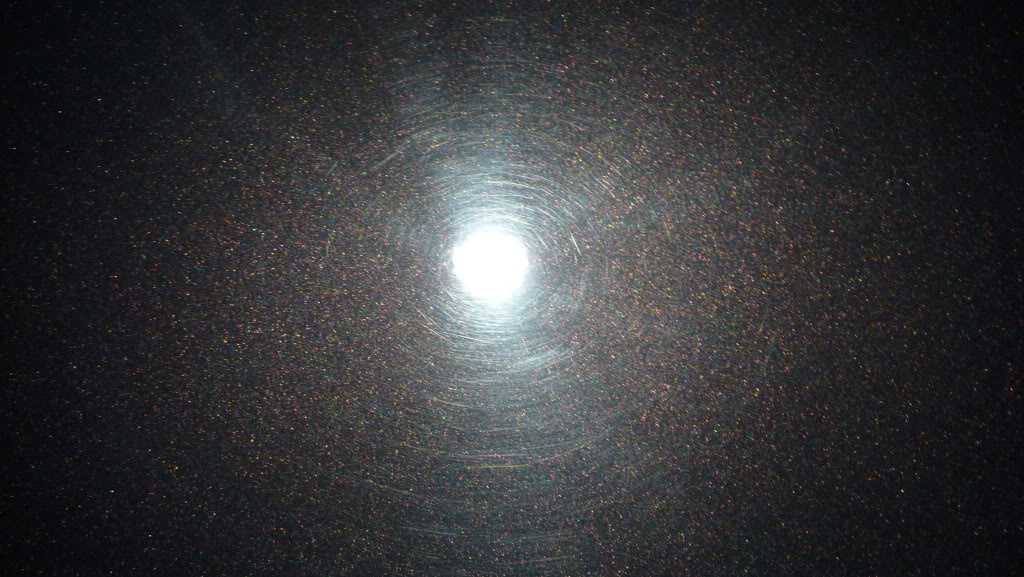

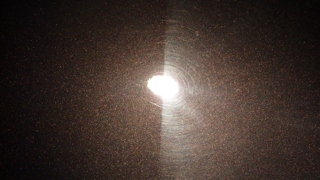

This 50/50 shows the level of correction:
As you can see, some deeper RDS remain, but I agreed with the owner that chasing down each and every scratch isn't the wisest move given how thin the paint is on this car.
Another 'after'

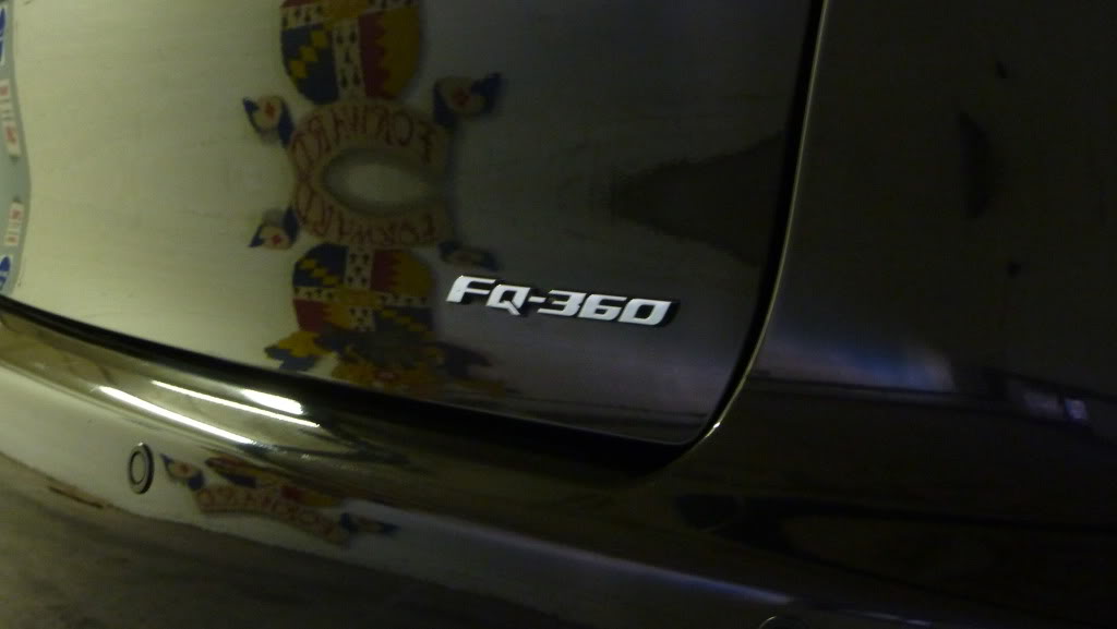

Before:
After:
An after showing remaining RDS, which I didn't attempt to correct further:

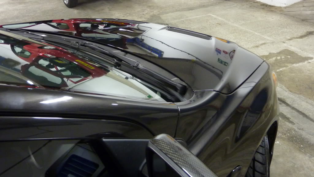

Bonnet before:
Bonnet after:

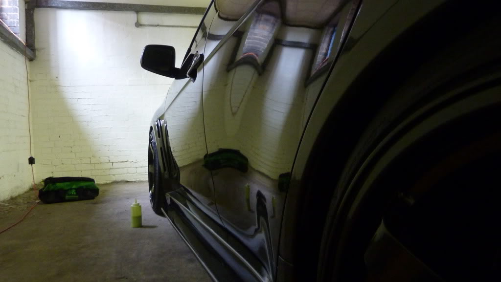

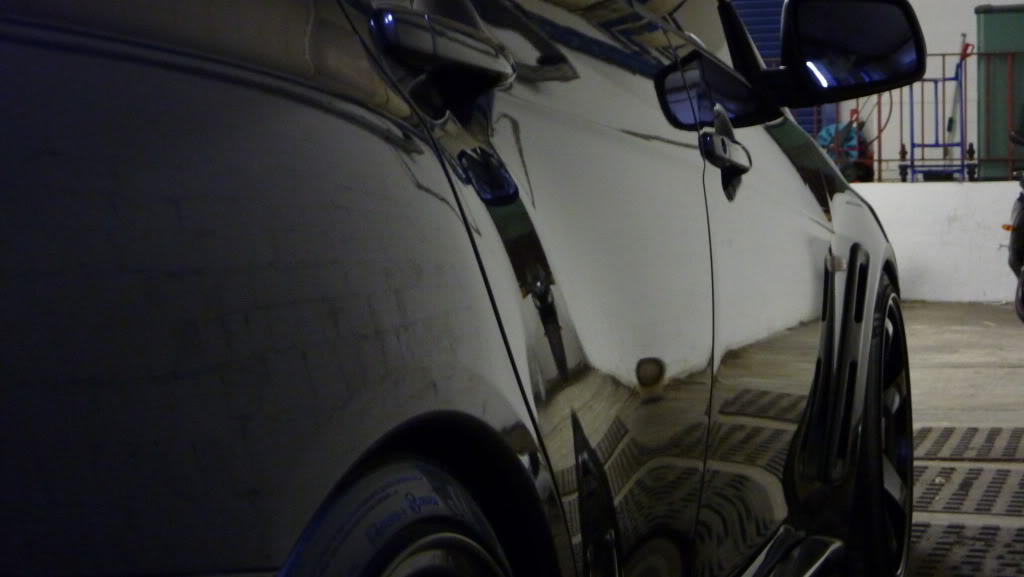

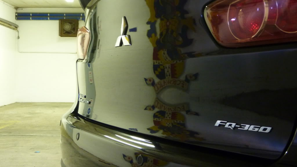

The afters...
