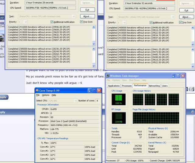

Got my Q6600 sitting at 3.6GHz on air cooling. Arctic Cooling Freezer 7 Pro along with Antec 900 case (two front fans, rear, side and top).
800Mhz ram @960mhz.
Asus P5K-E wifi
OCZ 600w stealthxstream psu
2x74gb raptors in raid0
2x80gb wd 80gb in raid1
8800gt 512mb @700mhz
Been pretty lucky to get that out of the cpu but it's sat like that since January no probs at all. That's without any voltage changes too.
