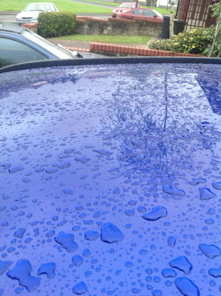

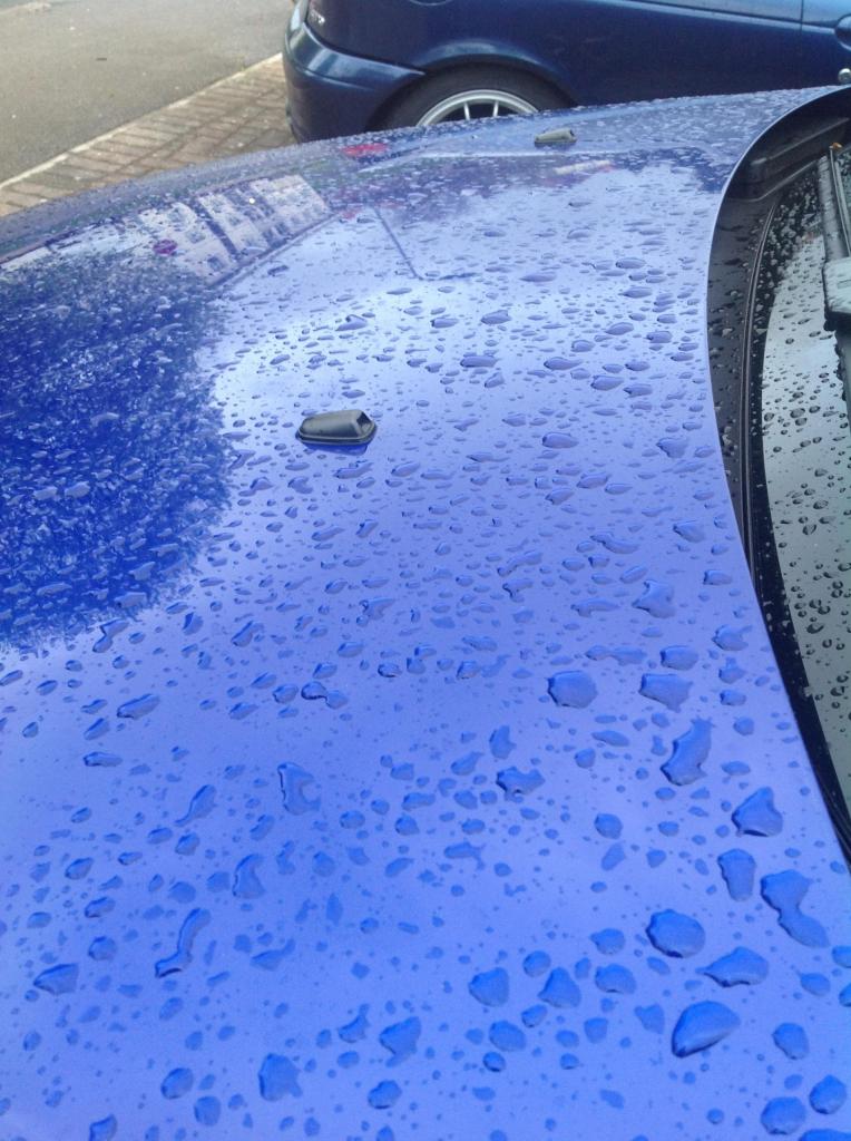

Is it just me or is this "beading" dissapointing for a cquartz finest coating?
I'm not sure, hence I'm asking in this thread lol. I was under the impression it was also a sealant as well as extra on top of the clear coat.
​doesnt need wax or anything making me think it should be beading better...?
Last washed about 4 days ago. Its a bit dirty but only on the sides behind the wheels. Not the bonnet or the roof as I've pictured

Finest is a ceramic sealant coating. The coating needs to be kept very clean to keep up its beading appearance. Also remember sealants dont bead like wax, they sheet water.
Although it isn't beading, this isn't a indication the sealant is not their. Finest will last two years minimum if applied correctly (which if Russ done it it will be) and maintained correctly.
so onto maintenance, Normal washing routine should be, jet blast, pre-wash cleaner/snow foam (if tou have it)then two bucket wash with a pure shampoo and lambs wool mitt. what this means is not with gloss enhancers, carnuba etc etc. simply dry and do not add any qd or similar. Adding wax, qd, gloss enhancing shampoos massively effects the water behaviour.
next time you wash it and give it it's final rinse, observe its water behaviour. Use an open ended hose. The water should bead in places but mainly 'sheet' of the panel to leave it near dry.
If it doesnt There is two things you can do here. Firstly as mentioned it needs to be free of contaminants. Every so often give it a fairy liquid wash. I know this goes against all what detailing tells you but it will clean the sealant of nasties. This would normally remove waxes or normal sealants but finest is alot tougher!
Secondly I would massively encourage you to buy CarPro reload. It is the top up for all their sealants and is superb. This will bring back all the beading and sheeting and further protect the coating. It will also look the shizle ;)
Being that your colour is performance blue or whatever ford call it now, you may need to dilute reload slightly with de-ionised water. It can sometime be a little smeary/cloudy on darks.
to use, once washed, dry the ST and spray once per panel ish in a long sweeping movement. Sometimes you may need a little more dependant on size. A little is all you need. Using a new/soft MF towel spread it around untill it disappears. Job done!

Wow, that's a shocker. If it was only applied on the 27th I would say there has been a problem and for whatever reason it has not bonded to the paintwork (this is purely my opinion from seeing that one pic, so it's not a fact). I am CarPro approved and applied this coating to a couple of BMW's very recently. The surface has to be impeccably clean beforehand and once the coating is applied the car stored indoors away from the elements for 24hrs. The last thing I do before releasing the car is wipe it down with Reload. Reload can be applied every 3-4 months during routine washing. But even without this spray sealant the Finest should be performing better than that in it's own right.

Hmm.. strange one. If it got wet straight after you would simply end up with water spotting rather than failure anyway. Well, Russ knows what he is doing so doubt there has been an application problem - he will ask you to take it back to him for a proper diagnosis. It's easy for us to sit looking at a screen and say it is this or that. Russ has sample shots of this coating beading like crazy, as do I of the UK version (basically a weakened version), it definately beads rather than sheets... and your images show no beading :(

It does sheet off yeah, but after seeing a picture russ put up of a pw on a white tt he done a few weeks before mine it doesn't look very similar.
Sometimes these things happen, and often without reason. I had a GTR booked in for an original CQuartz detail the other week, I had to change the LSP to Crystal Rock because the paintwork simply would not accept the quartz coating. The client didn't have to make any extra journies though, I recognised the problem and adapted straight away before he came to collect. But the point is, these things can happen unfortunately and in your case the problem seems to have developed afterwards / gone unnoticed until water has been present. I've alerted Russ of this thread btw, he is a friend.

Sorry for the delayed reply. If the coating has failed ill come down to you and reapply for you free of charge. This is very unusual and not an issue I've seen before. As said it looks like tree sap possibly? Either way ill sort it for you.
Regarding stone chips, sanding will certainly remove the coating so it will need to be reapplied over the area. Ill send you some for this.
