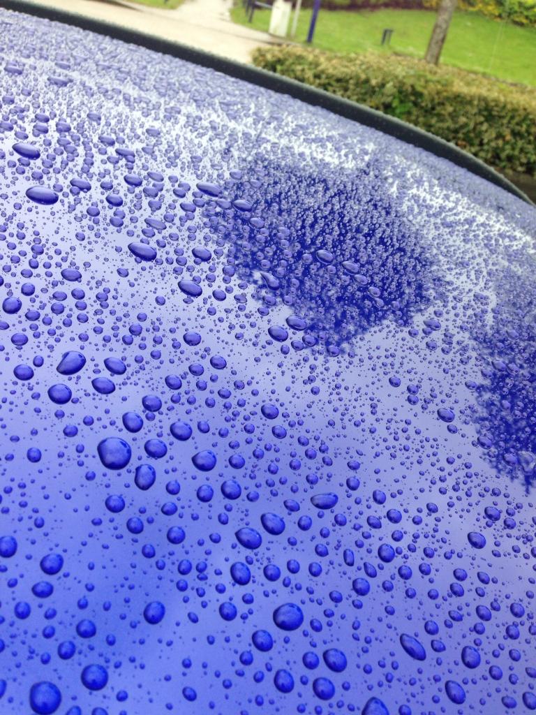

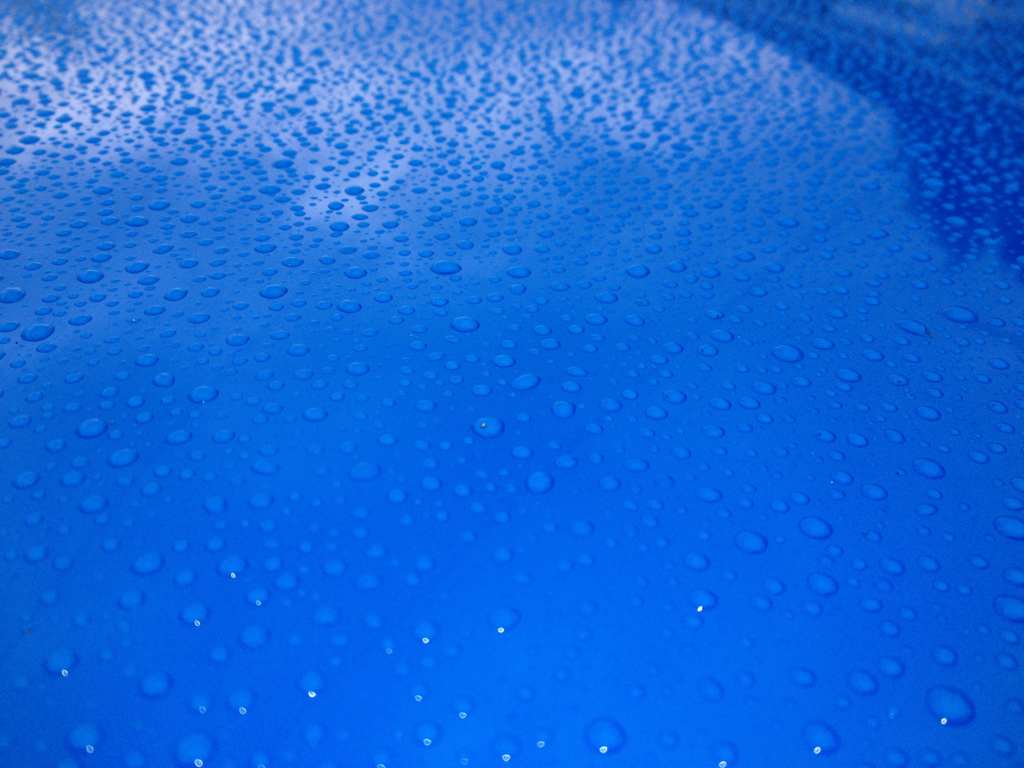

The product is awesome, as demonstrated by Russ' images of it. I don't think you are expecting too much from it either. There has been a fault hence your disappointment - it can happen occasionally. As Russ has posted though and will sort it out for you, I can assure you that Finest at 100% is an epic coating :)
Sorry for the delayed reply. If the coating has failed ill come down to you and reapply for you free of charge. This is very unusual and not an issue I've seen before. As said it looks like tree sap possibly? Either way ill sort it for you.
Regarding stone chips, sanding will certainly remove the coating so it will need to be reapplied over the area. Ill send you some for this.

out of interest how can a failed coating be diagnosed? Is it purely if it doesn't bead / sheet as well as the photos and videos show?

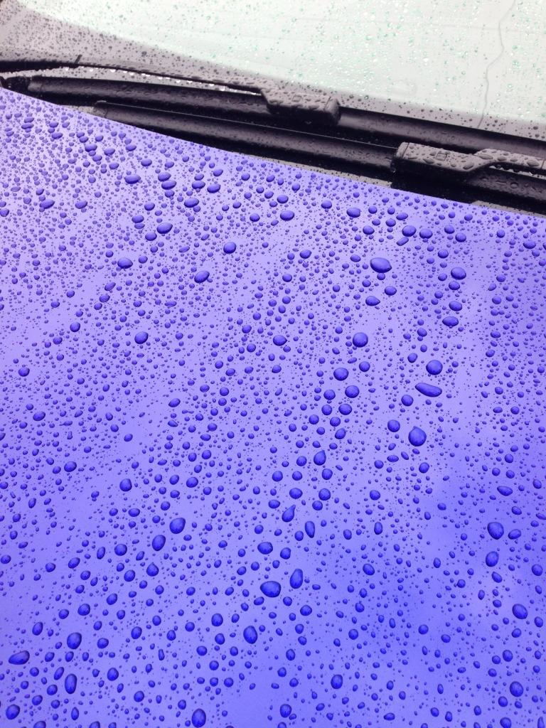

Also if it is the coating then ill send you a bottle of Reload down to keep it protected until we can get down to you, but it will be a priority. Are the vertical panels behaving in the same way? That way we can identify if its the coating/bottle or an application issue.
The doors seem to hold onto the water and has the same sort of effect as the roof only less water (if that makes sense?)
Very odd indeed. If you could email me some pics after washing I'd appreciate it and we'll go from there. As stated by others please don't let this put you 'off' Finest in any way as it really is a superb product which is why we use it and back it. We'll get this sorted for you.
I'm really not a Gold Class fan to be honest. I'd use something like GTechniq G-Wash or Auto Finesse Lather which are free of any 'waxes' or 'gloss enhancers' which can form a top layer of 'protection' over whatever you have on your car. GC is quite aggressive as is Magifoam but neither should put a dent into Finests protection.
In fact if you recall the few droplets that we saw fall on to the car in the unit were beading perfectly so something very strange has happened here.
Take the superb maintenance advice offered in the first page and we'll go from there.

Let me speak to Avi and Andy from CarPro tomorrow for you and see what they suggest we try next. A Fairy 'strip' should help but let me see what they can suggest too please before proceeding.
