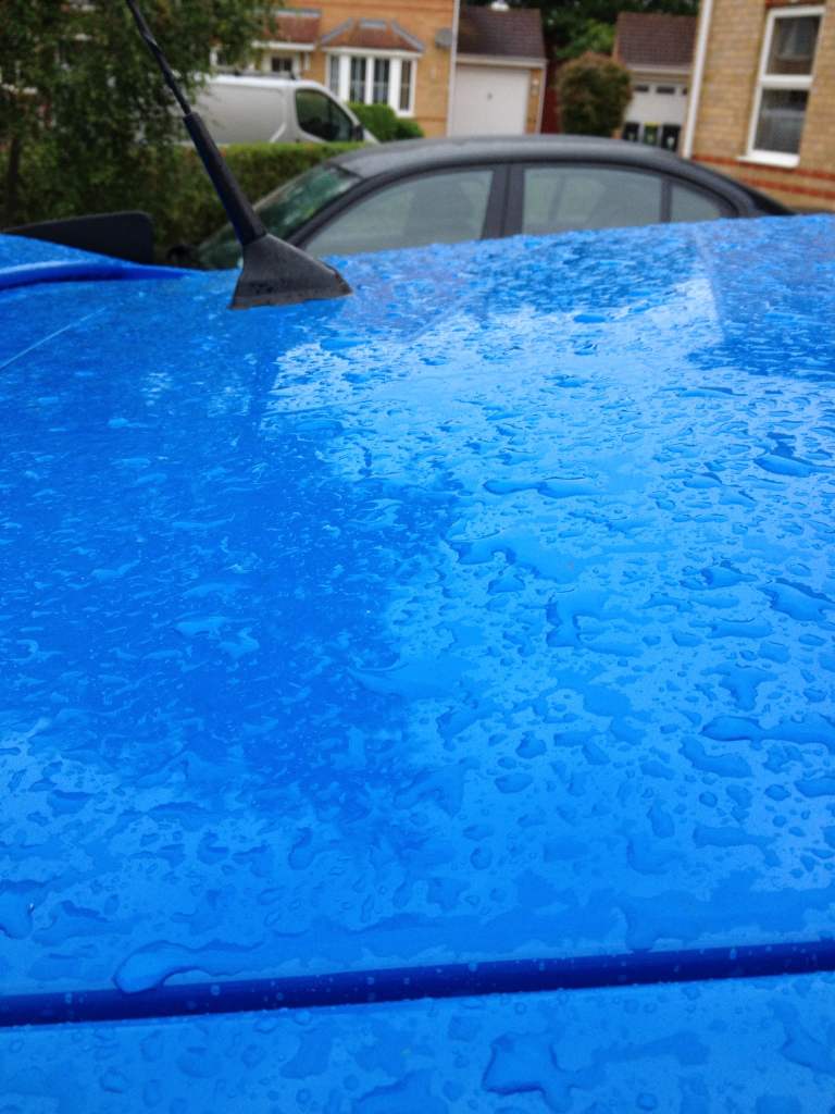

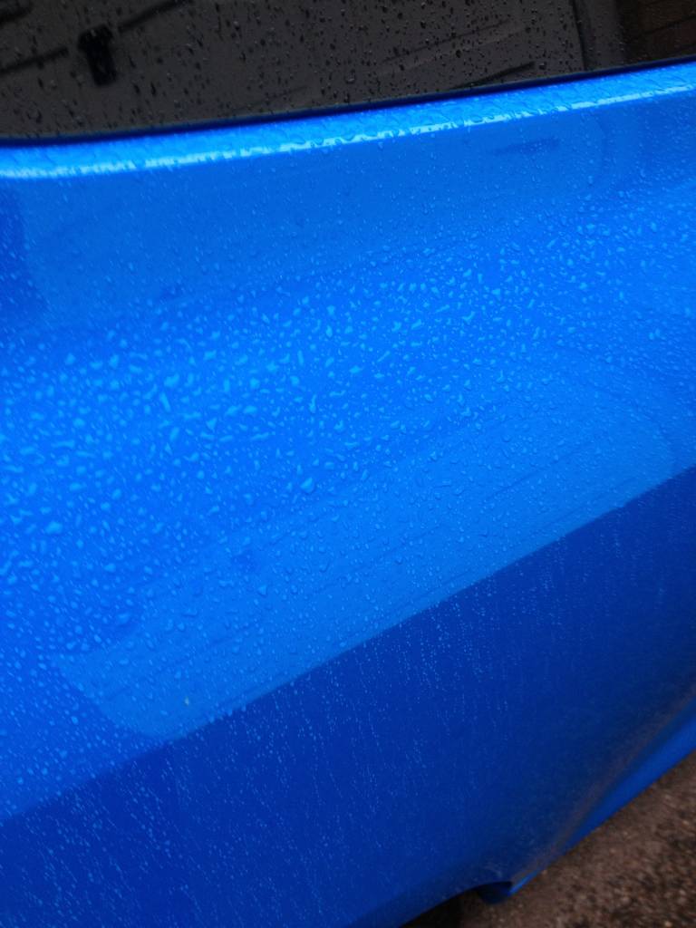

Its raining tonight so thought i would take some pictures on the water behaviour on a dirty car for you to compare with. Mine hasnt been washed in over a week, and has driven to css and back so long journeys!
Drivers rear 1/4
And the only part that I would say I expected better from is the roof:

That looks similar to what I get on a clean car. But I also have pools of water as if there are no protections on there
