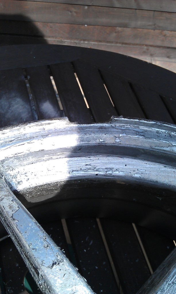

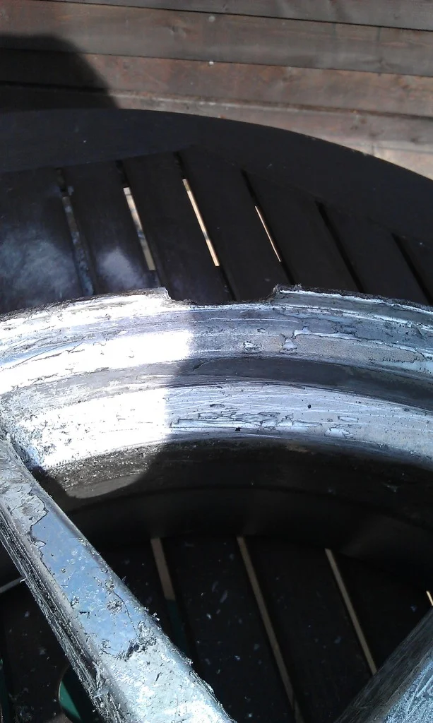

hey up guys do u think anyone can repair this alloy for me it has a chunk missing
