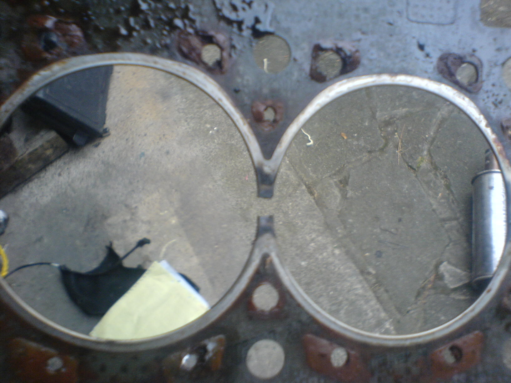

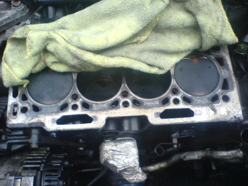

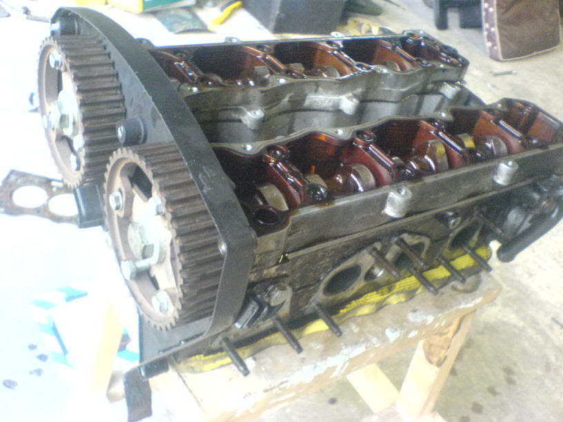

wooo striped it down today was the gasket between 2-3
pics hear
Very nice, are you just going to replace the headgasget then?
What prize do I get for getting the right answer?
its a joint prize with me..! we get to share freds arse for a nite .....that what he gets for looooosssssiiinngggg
im gona get the head tested and skimed if need be.. it looks ok but just wana be sure!
