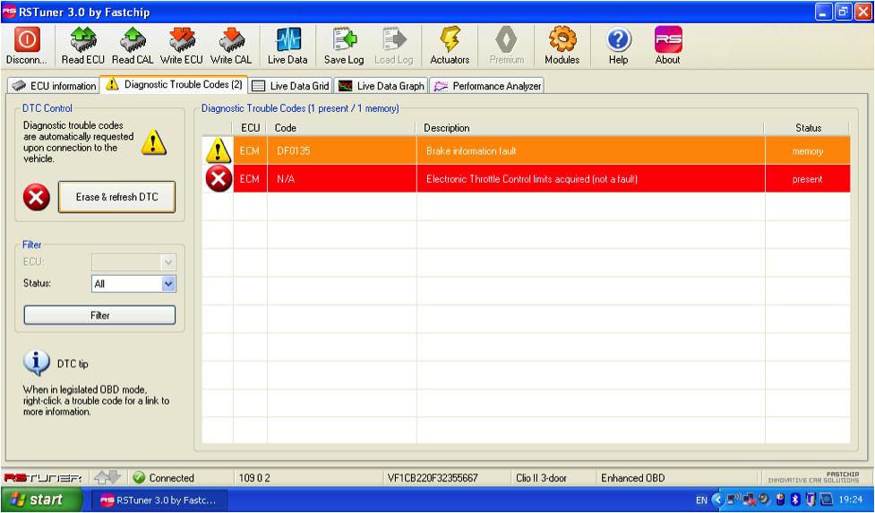

Stuck my RST on and got the following. Tried to erase and refresh but they came back on again after the wheels started moving.
Anyone know specifically what the code means?

Its fixed :D
I had presumed the airbag ring was a true slip ring and turned infinitely, and after speaking to ryan @ NWP I thought i would just have to get it reset again as the ecu thought the car was turned due to the position of the slip ring.
Last night i was just messing with the old one and turns out it is on a ribbon and has a centre position. Whipped the wheel off this morning and set it to centre (it was 1 turn out which meant i could full lock as the ring turns 2.5 turns from centre either way).
Anyway now it works fine, cruise works and everything, first time since i got the car that it has all completely worked (grasps wood tightly)
