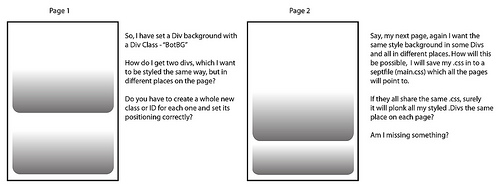

Please see link, hope I have made sense.

Yeah, thats the problem, I am positioning the Divs aswell with px or %.
So, lets say... my first background shadow is called ".BGBot", it is styled and positioned on the main page to be 540px from the top.
On the next page, I dont want it to be in the same place, still centered but further down... if I didnt share the .css it would be okay as my HTML would all be ready off there own style sheets with their own individual position. But, I want it to be all running off one main.css? If I didnt, there would be mega ammounts of css over each page.

Why don't you just have .class1 and .class2 using the same values but different positionng?
That is the way I can do it,
But, on each page, the bottom background will appear at different levels on every single page doe to the ammount of content on each one. If you get me? LOL.
My css file will be like .class .class1 .class2. class3. class4 .class5 .class6 .class7 .class8 etc... etc... I dont want to have a shed load of different classes or ID's, purely down to the management of them.
You don't need to set the position of the background div. The content above it will dictate where it appears.
