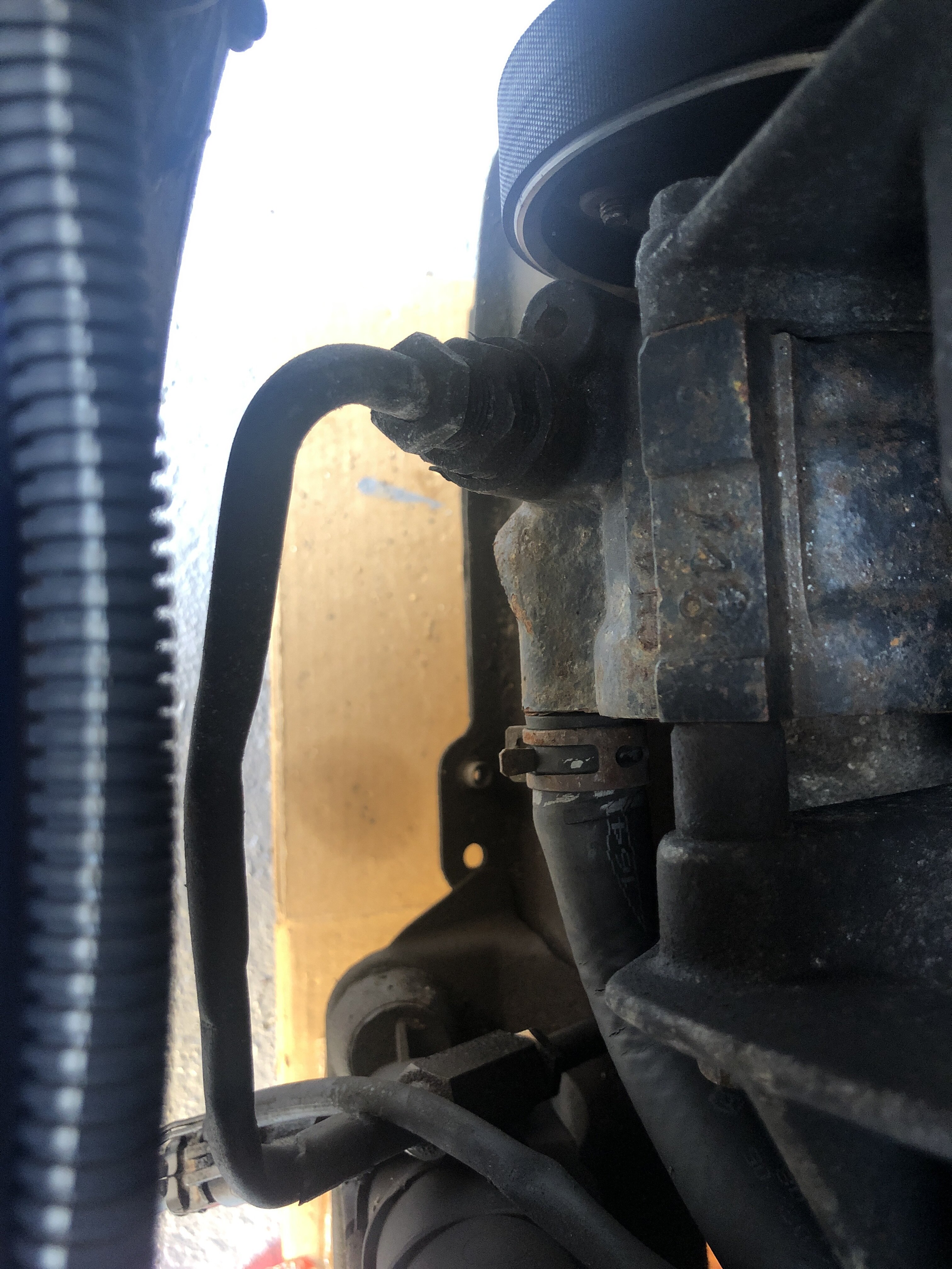

I know its been covered a lot but i cant find any info or images of what route people have done when bending the pas pipe,trouble im having is the pas switch is getting in the way and cant manage to clear it of the fan cowling.
So all im after is some photos of the cup alternator set up in a 182 please with photos of the bent pipe route.
Thanks
I would also like to know the best or another way to do this, I’ve been running a bent pipe for years but it looks fairly pikey:
Did you have to extend the wiring for the pas switch? @Greeny.
Nope but it’s tight as fook and the sensor is very low, it’s not ideal and I’ll be asking Alex to see if he can sort something when it’s in with him next year, it has however been like this for 5 years now and touch wood other than looking shite it’s been functionally fine.
