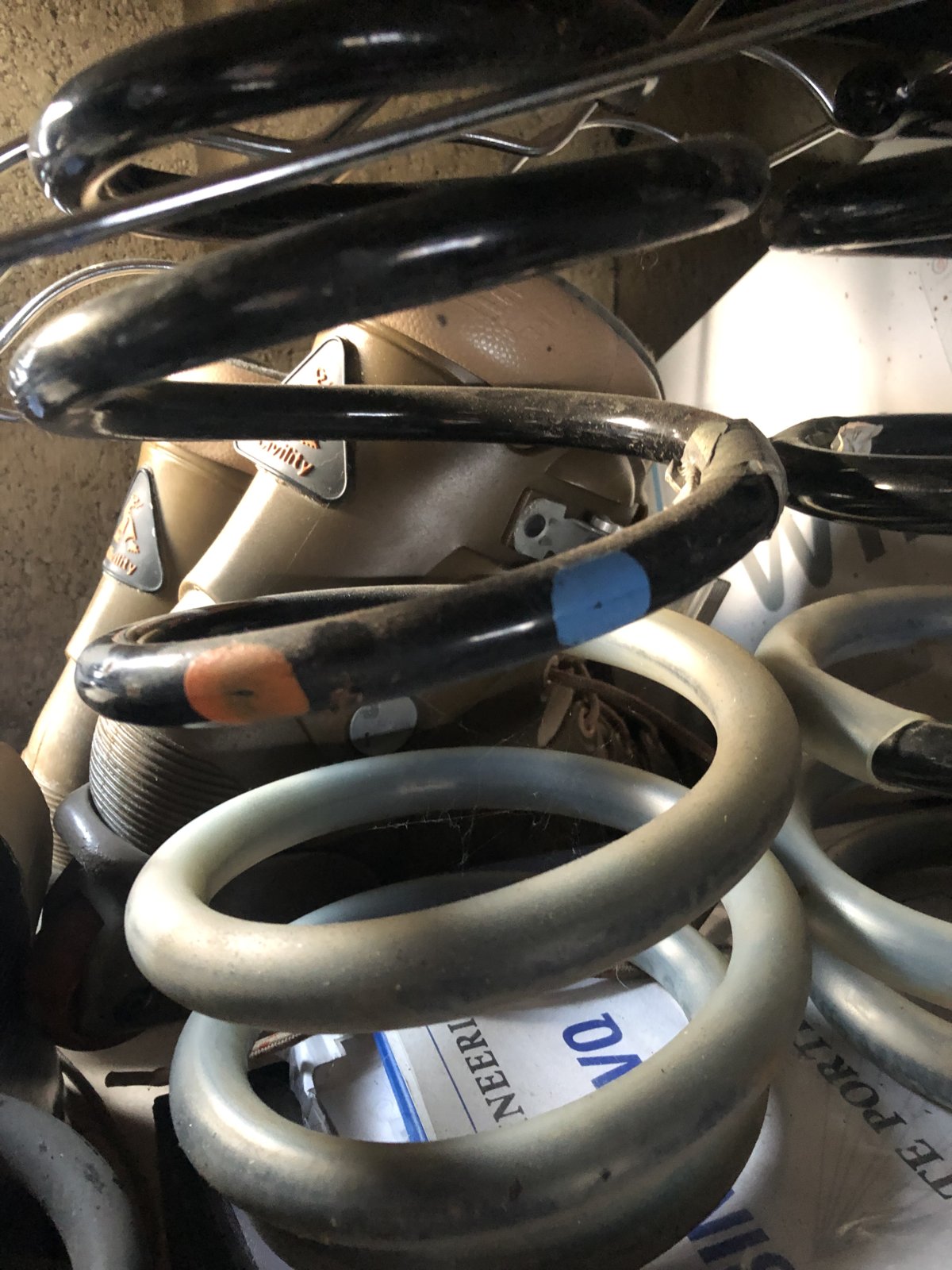

Easy way it to check the markings on the front spring, think cup springs have a blue and yellow strip on them?
Ben Cook
  Clio 200 (2010)
Cup springs will have this orange and blue marking on them.
