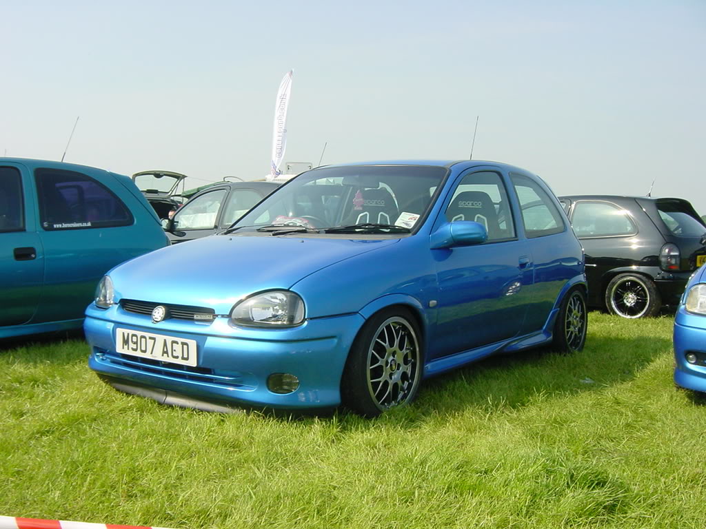

My current car is a corsa and doesnt have ABS or even luxuries such as power steering, I just bought tuning stuff for it and its not very practical for everyday use!
So the individual cup packs include what? Suspension and anthracite wheels? and then splitter and spoiler?
Oh and heres a pic of my current car!

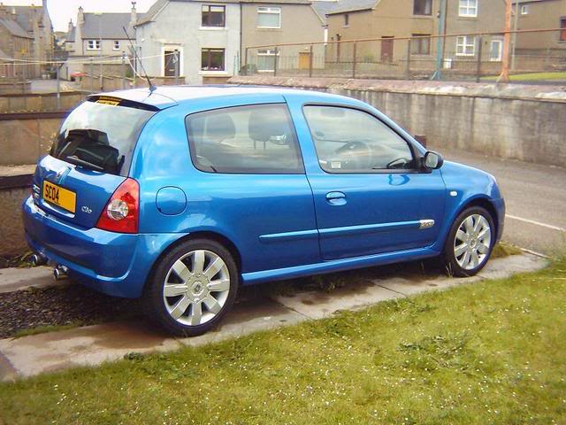

Here's a 182 without Cup packs (note spoiler/wheel colour)
Get one with the cup packs.They look better and handle better.Also if you come to sell in a few years it will sell quicker too
TBH, i couldn't tell the difference between a cup'd 182 and a non cupped 182 on the road.
