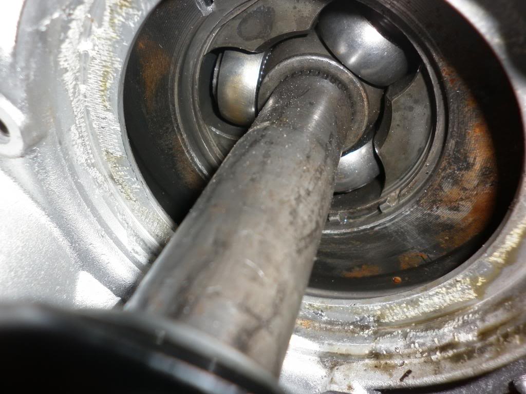

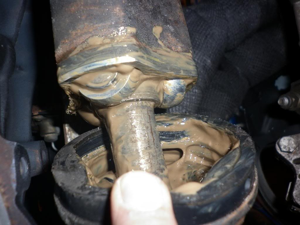

It should work... but do not trust it and check that your tripod sit about the middle of it's housing.
My pictures of where they sit when butted up the back of the hub.
