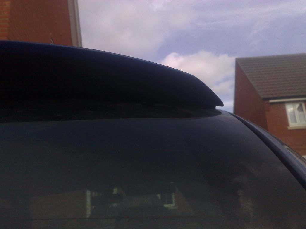

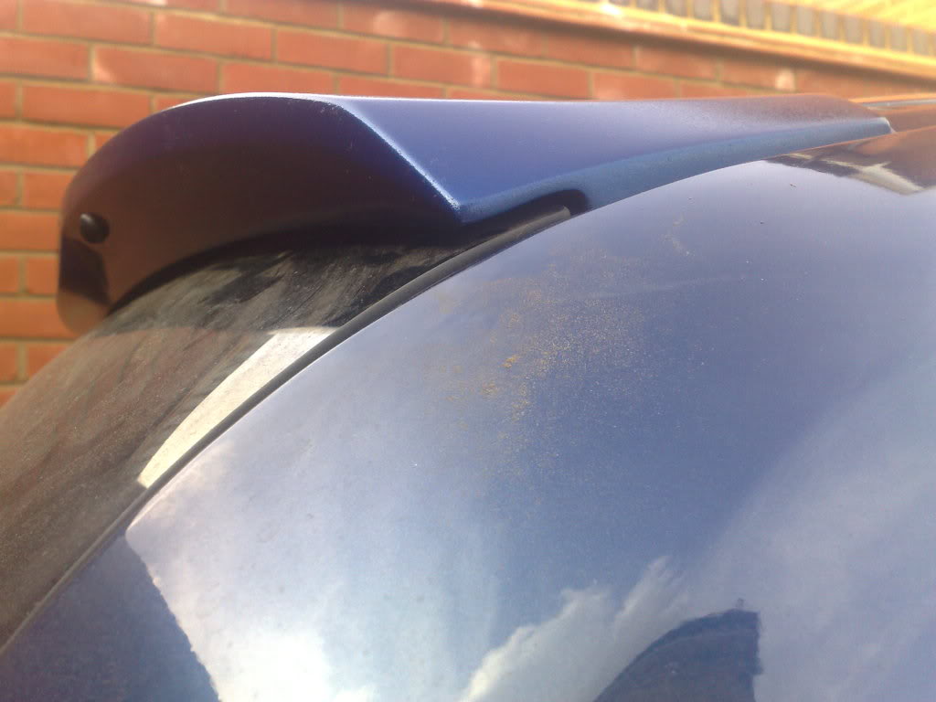

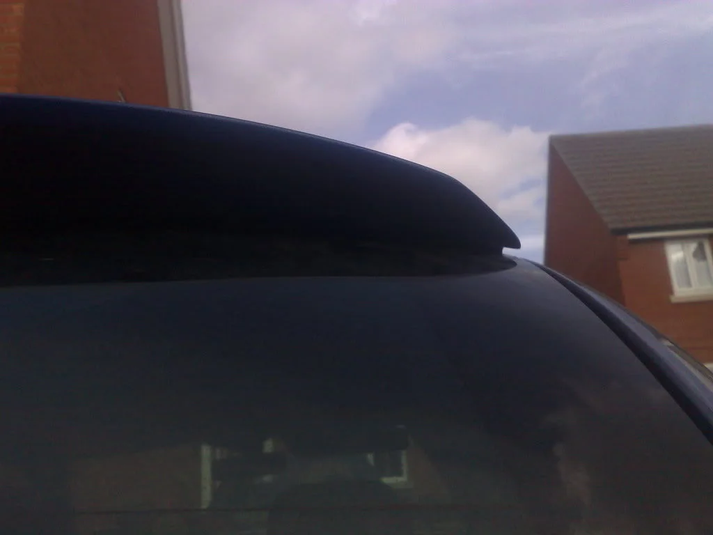

Have just fitted my Cup Spoiler but have noticed it doesn't seem to be fitting as flush as the old one did. Is this normal??
A few pics.....
You can see underneath where it should meet the window it doesnt
HAve checked and there's nothing stopping it from sitting flush... Am I being a total dick whazz??!!
It doesn't look to be properly sloyyed in at the back... wiggle/hit it into place and it'll be fine.

Could be the brakelight cable or washer jet pipe making it sit wonky.
Same happened mine but I made sure they were in the "space" between the bootlid & the spoiler before you put the screws in
Just checked mine and mine doesn't completely, it's close enough though. Make sure it's properly in at the bit where it meets the roof and it'll be right.

had a fiddle and its a bit closer now tho still not flush. Oh well its hardly noticeable so il stick with it : )

They all have some gap between Spolier and Glass..... Its a few mm s I run my Chamois Leather between the Glass and Spoiler as its a bugger for holding water

Mine didnt sit like that:S Try moving brake light cable and washer jet pipe. Should sit flush with the roof which yours doesnt seem to be doing. Does it catch the roof when you open the boot?

Nope not at all. Moved everything out the way and it still sits like it.
