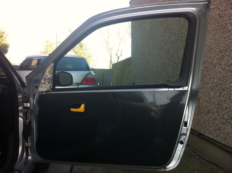

i used a drill and hacksaw to cut the hole, pretty simple really. I might do the pas side tomorrow i will get pic of the different stages!
