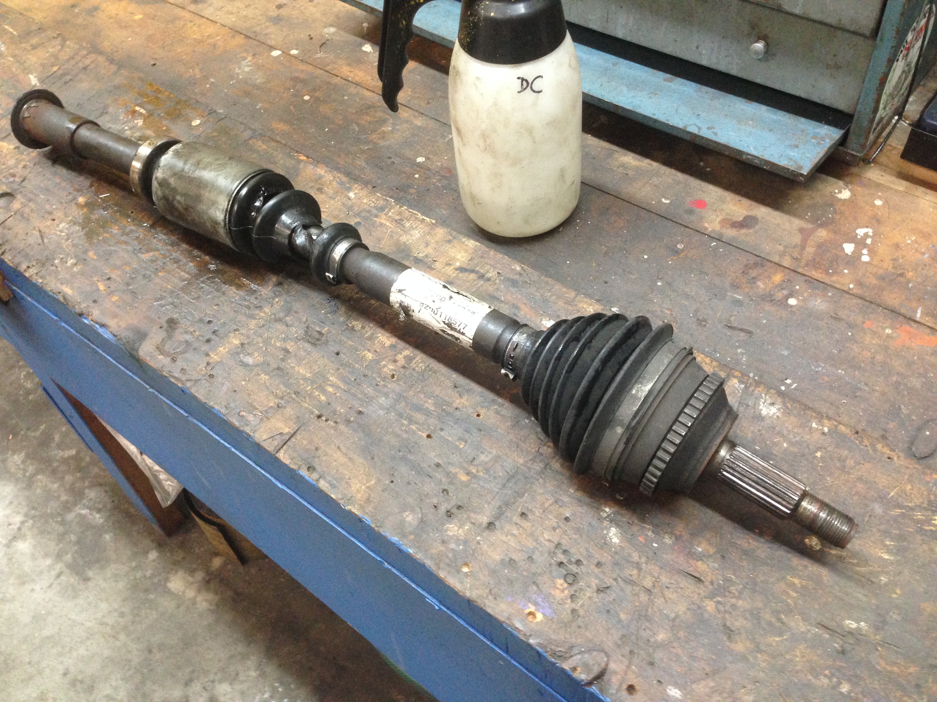

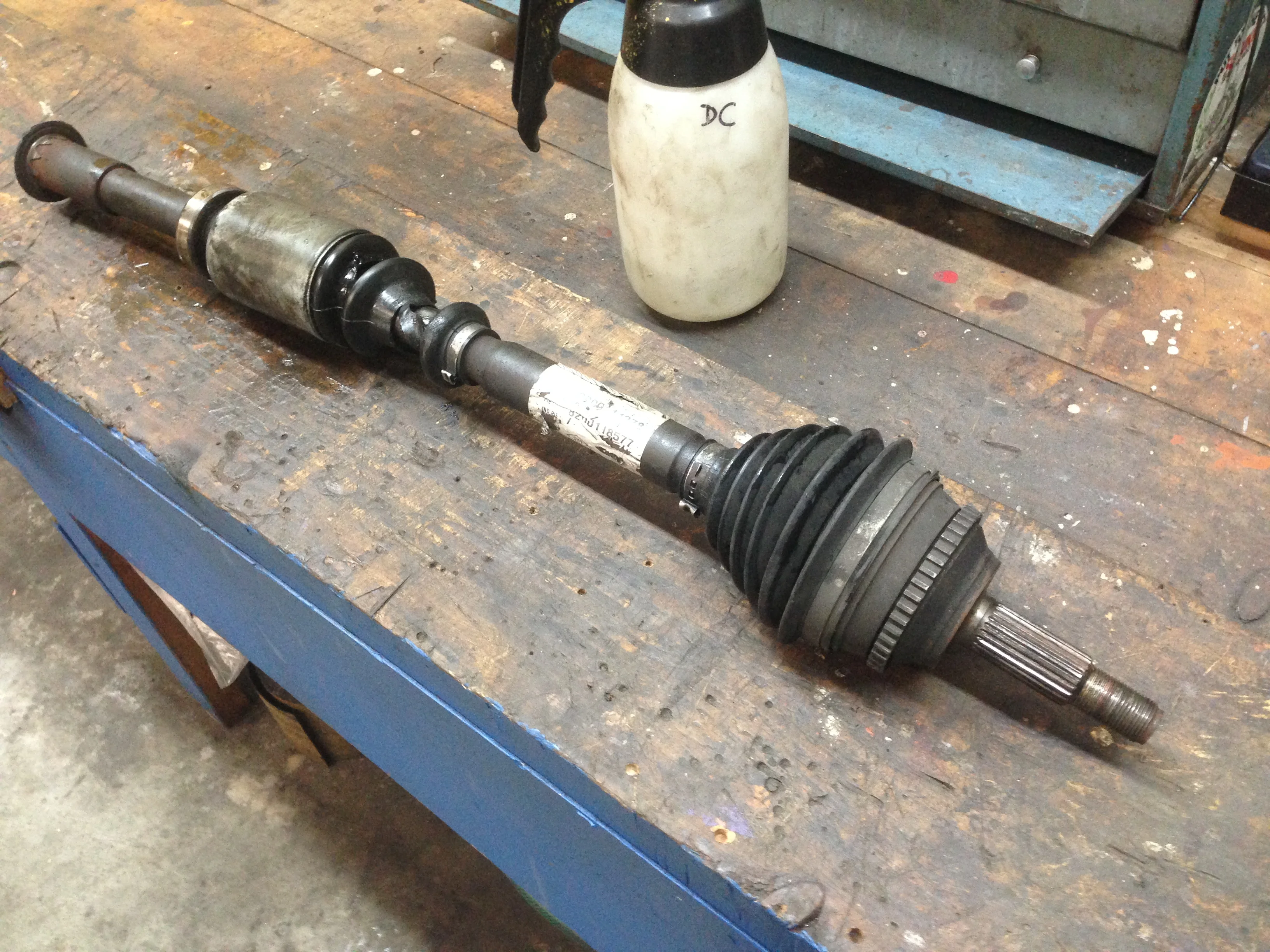

hi, I have a phase2 - 2004. Inner boot is toast. Renault NZ cant confirm which boot, but reading everything here it sounds like a new boot isnt possible. I am not that keen on a new or used shaft from the UK as the freight is plenty. Has anyone recently found a boot for these? Its the inner one that fits into the metal canister >> see pic when I had it out last wkend for a looksee. Any advice for second hand if thats the only choice? cheers all.
nice one Bloke. Cheers. Did you fit it ok? I am assuming that the boot has an interference fit with that metal canister with a rubber rib or something so it just squeezes in??

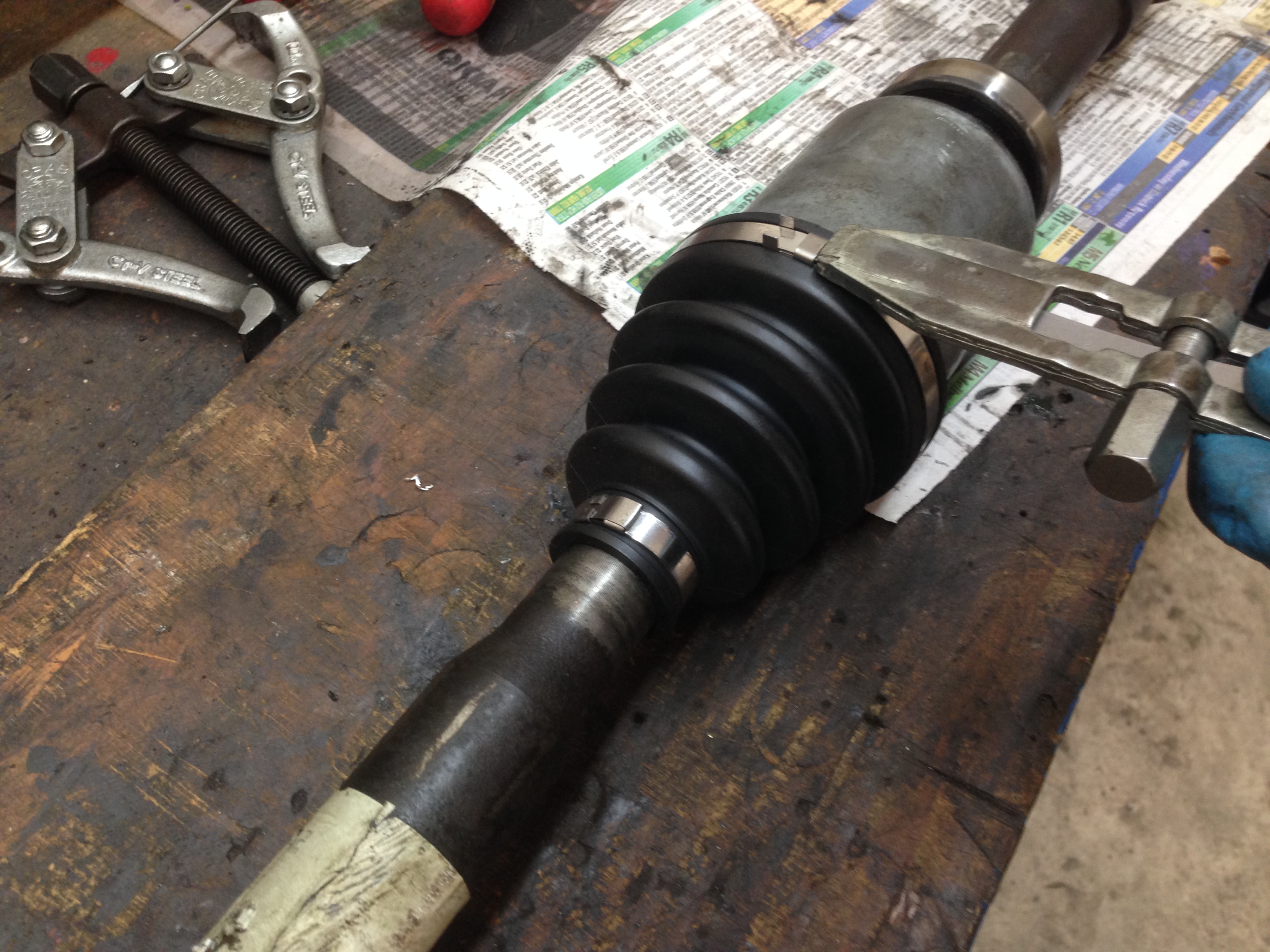

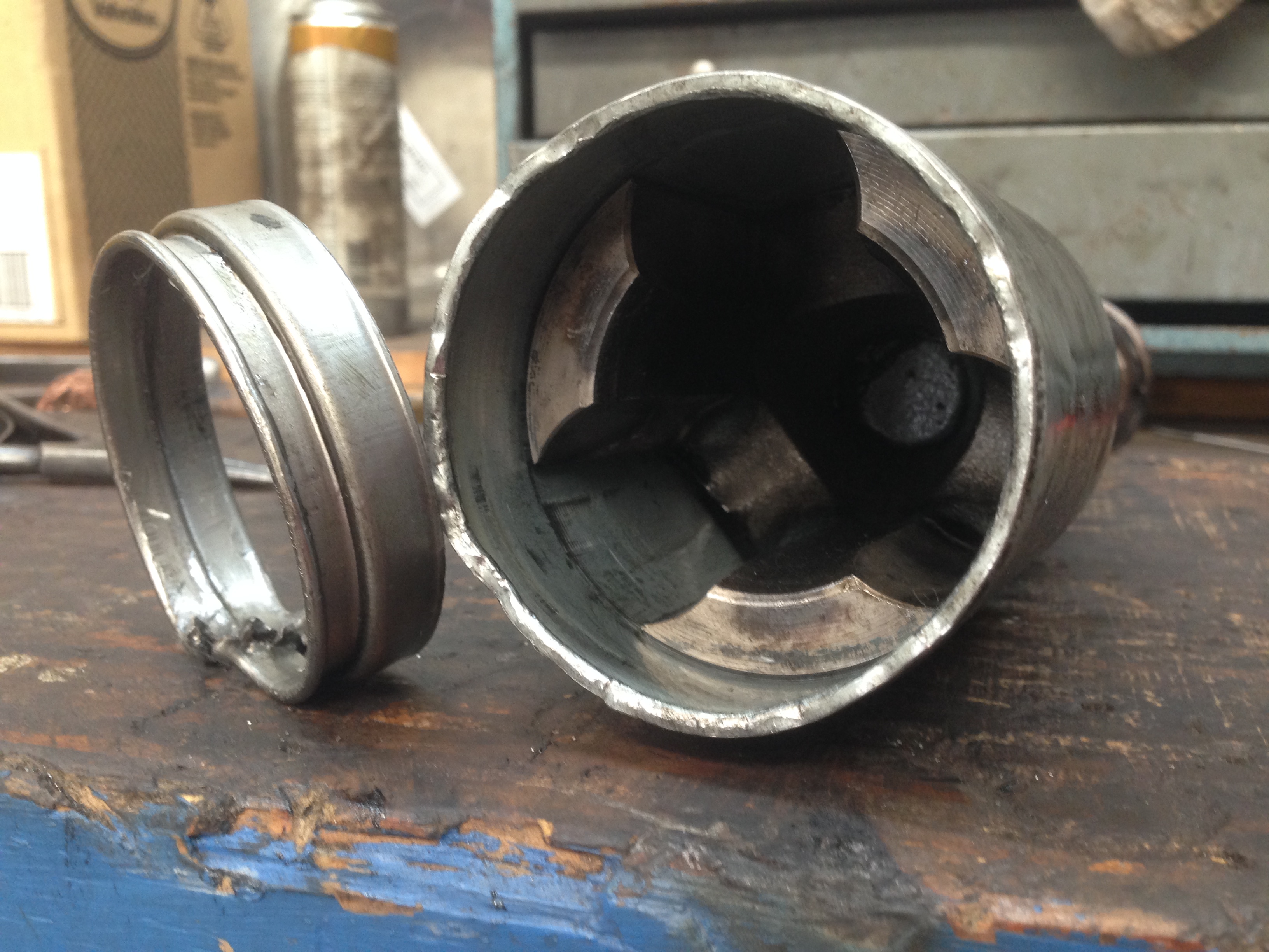

Side - is not replaceable. I have just had mine out again. The boot is swaged (end of the boot is crimped between the cylinder and an inner metal ring) into the metal cylinder at the factory and cannot be replaced with like for like. In the UK it makes sense to get a complete shaft second hand. What I did is fit a new boot that goes outside the metal cylinder. We had to cut a few mm of surplus engine block away but it fits like a champ. See photos attached of CV with metal ring out (you have to destroy to remove so that the joint can come out) and new boot being fitted.
Inner CV boot Drivers
forgot i'd posted sorry, the one i got was the same, just went on the outside of the pot joint.
